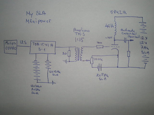

My CD player
I try add the schema where use Raytheon 5842Q.
Tõnu
