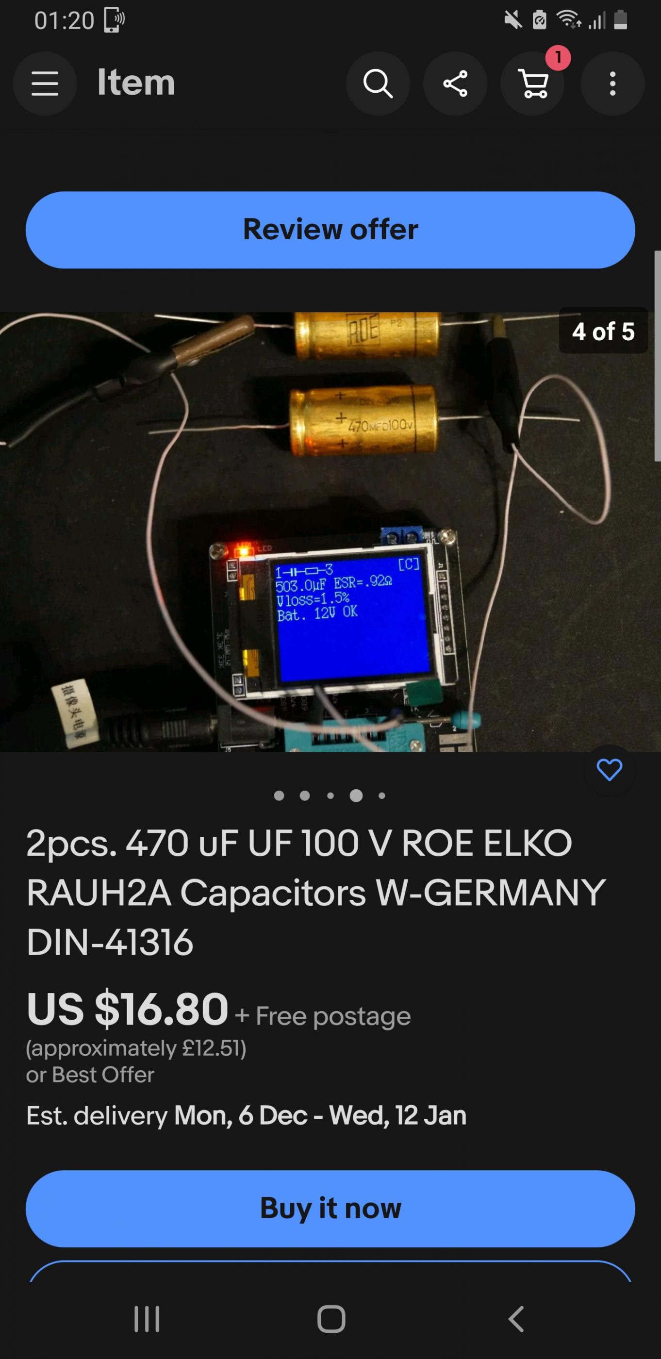

On the description for Sic-Safco its says they are new which means nos, I asked the seller if they were tested but no response.
I also found these German branded caps, ROE ELKO, russian seller sent me offer $9/£6.70 for 2pcs. did anyone used them for coupling?
I'm still waiting for my Peak ESR70 then I'll test them.
The issue with 'testing' is that is quite involved with caps and and Arduino attached to a screen doesn't quite demonstrate it's all great with the cap.
1. impedance vs frequency
2. leakage
3. voltage applied
A cap may give you one set of responses at low voltage but a different set at higher voltage, especially where leakage is concerned. Testing a 600Vdc cap at <1V may not indicate its failure. At least without some high degree of sensitivity (ie Carlson Labs style).
I'll be interested to see how you get on with the Peak ESR meter. Looks like a handy addition to the standard L-C-R measurements from a multimeter.
