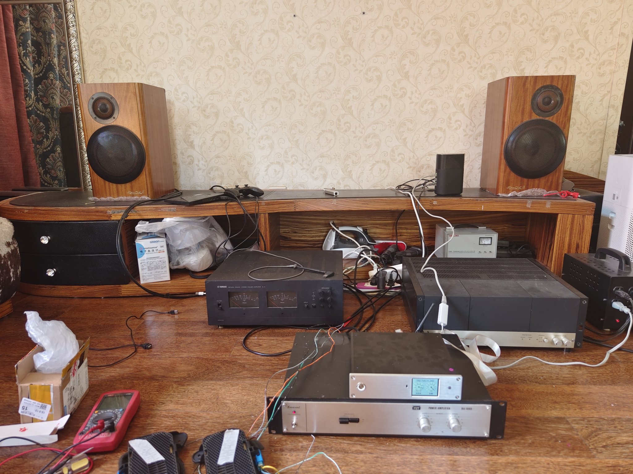

I admit I started to buy vfet amp years ago influenced by some "internet influencers" they make me to believe they have unique sound, like no other trasistors can compare.
So, I got Yamaha b-2, Yamaha b-1, recently a Sansui ba-1000. Sure they sound similar sweet and smooth and i am satisfied.
I also found that not all vfet amp is so sweet and smooth for example hitachi ha-500f. I haven't heard one but according to kitr's review and listened to some youtube recordings I feel it sounds a little dull maybe on par with sony ta 4650. lacks some airy and live feel of ta-8650 from videos recorded in same environment. So I feel circuit design is more important.
I wonder is that true no other transistor can achieves sound like vfet? what about mosfet, high current mosfet like uhc or lapt, SiC depletion jfet? Anyone know any non-vfet amp with similar sound?
I am also curious about how vintage vfet compare to modern lowest distortiin class ab amp(
topping la90) or a GaN fet class D?

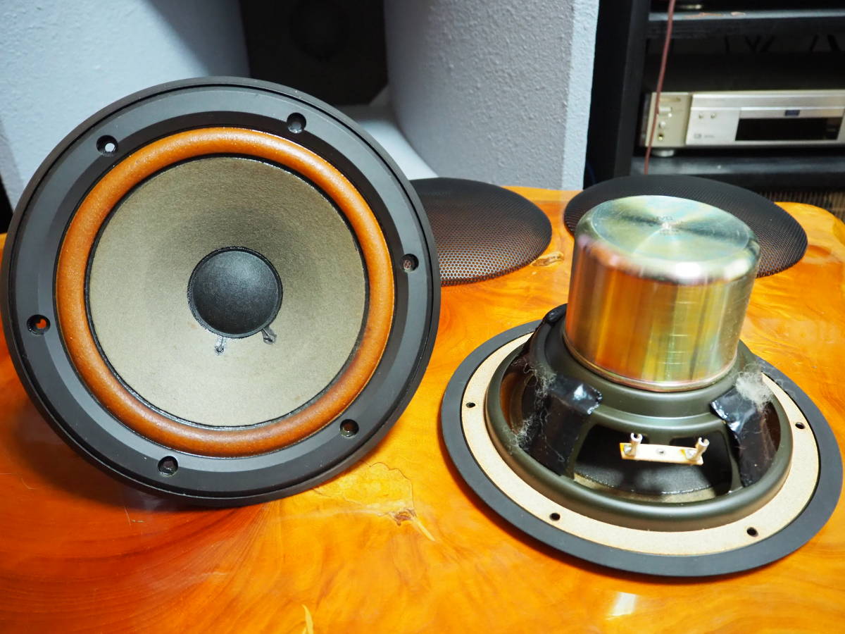

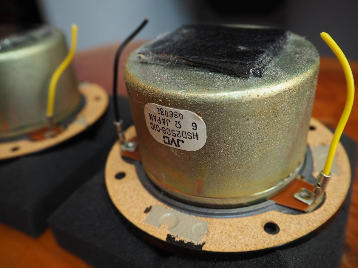

These are not rubbish at all, they are Victor Sx-500 dolce II. Internal alnico for both tweeter and woofer, real wood panel, real wool damping filling. the paper cone's sound I like the most. I have not heard any bookshelf I love more.

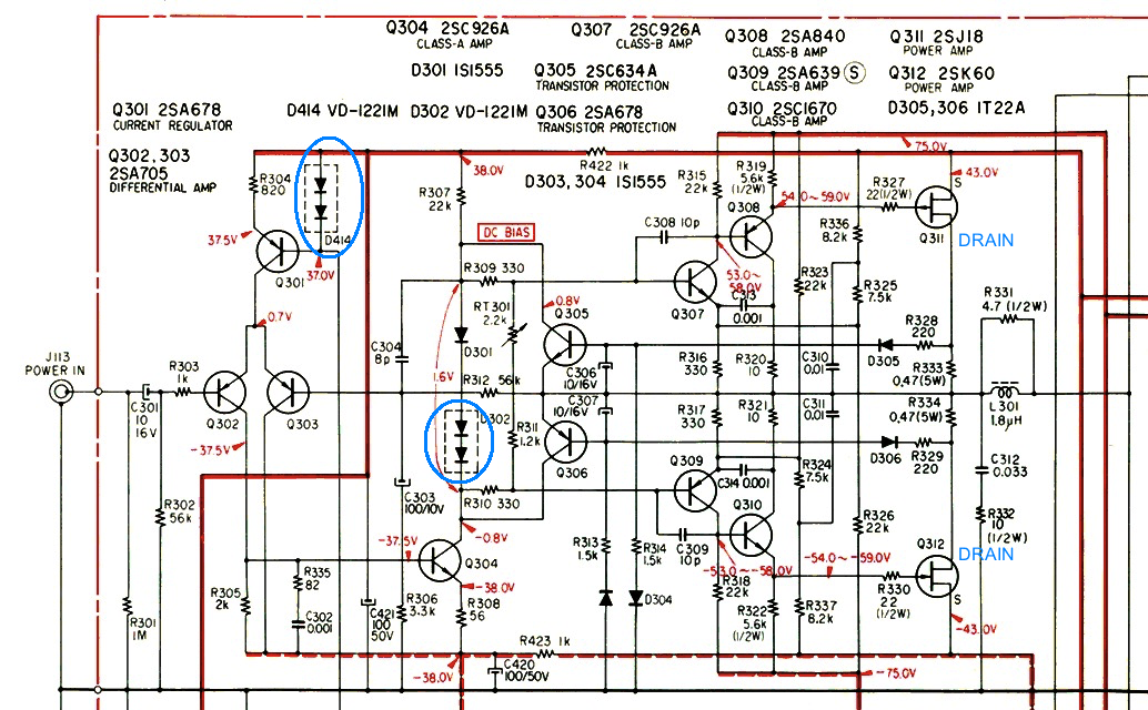

There are only two amplifiers where the j-V-fets are connected drain-to-drain to the output: Sony TA-4650 (singels) and Sony TA-5650 (twofolds). All other j-V-fet amplifiers have a classic topology with the sources (or emitters - bjt) to the output. SIT's and the like from N. Pass are the current exceptions (hats off!)....maybe on par with sony ta 4650... circuit design is more important.
I wonder is that true no other transistor can achieves sound like vfet? ... Anyone know any non-vfet amp with similar sound?
There is no other topology that can manage an stable output as all other drains from whatever fet and collectors from bjt's have an high output impedance making it impossible. With tubes, triodes especially, only an output transformer is needed. So we're stuck with available V-fet's and SIT's until stocks depletes.
But there is more! What distinguish that very specific drain-to-drain topology to make it sound so well? I'm a regular visitor of live classical music performances and an owner of a (serviced) 4650 for over a year now. It does indeed sounds very good, close to the original. However, It is not the same as live, but pr-claims like detail, placing and accuracy are in place here, with distance. But why?
One has to analyse and decode the inner working of a triode /V-fet / SIT to understand what's happening in the device. There are only three nodes involved that interacts with eachother, and more intense (!) than with all other semi's or multi-plate tubes. Consider the pentode, which has extra 'layers' (the screen and the surpressor) to protect the grid from being 'influenced' by the up and down swinging anode. Connecting the screen to the anode yields a triode again.
This works well with tubes (N-channel only!), but not with solid state devices, except the V-fet's and SIT's. They're actually conducting devices which must put to a close state by the controlling gate. Normal values (Rds, gate nc) for the 2SJ18 / 2SK60 V-fet's are some 2 ohms.
Is it possible to cook a solid state device with V-fet characteristics? Yes: the V-fet's (obsolete) and the SIT's (very rare). Commercially a no go.
But is it possible to mimic a V-fet? To create with ordinary components, current available solid state devices together with (non-frequency-dependent) simple components like resistors (20% grade) only, comparable with other well known and understood compounds like the differential and current mirror, Darlington and Sziklay, and the lone cascode (all with only two active devices!), a sixth compound, both N- and P-channel, or likewise NPN / PNP variations, that will do exactly tha same as V-fets (& SIT's) can do? Drain-to-drain, collector to collector and 'midpoint-stable'?
YES.
And it is earth-flattening simple. Staring in your blindsight face.
What's involved? Ohm's law, and if bjt's are used, you've only got to estimate the square root of beta for proper biasing. It is even possible to re-create an ordinary tube replacement out of it, say a EC83 or a EL519, using the heater voltage to power some orange (or blue!) leds.
How? That will be disclosed as soon as I get my patent awarded. Two semi's, three resistors, that's all. All (accurate) calculations fit on one single letter.
But currently servicing another 4650 and a 5650 as references, and a curve tracer to build to prove all things for the lawyers. (They are s... l... o... w...)
Cheerio.
