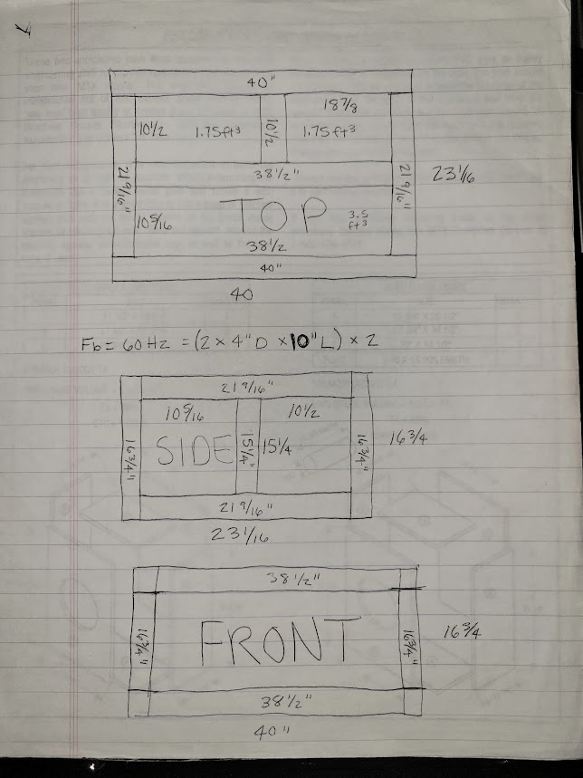

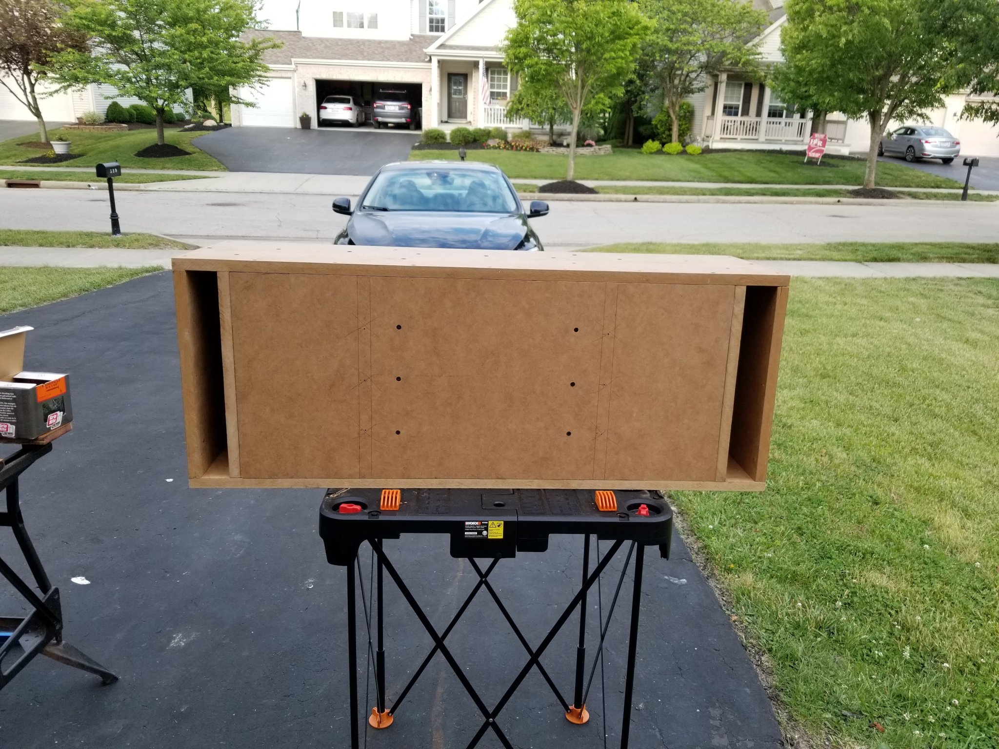

OK I did this and it is the most incredible sub I have come by. This is how I did it look at this picture the two outside Chambers with the drivers or different volumes I went with a slotted port but had a good idea in the process of coming to the decision of a slotted port I used PVC pipe one inside the other so that they would slide to tune it hope that's helpful this thing will knock full drinks out of the cup holders in my ride

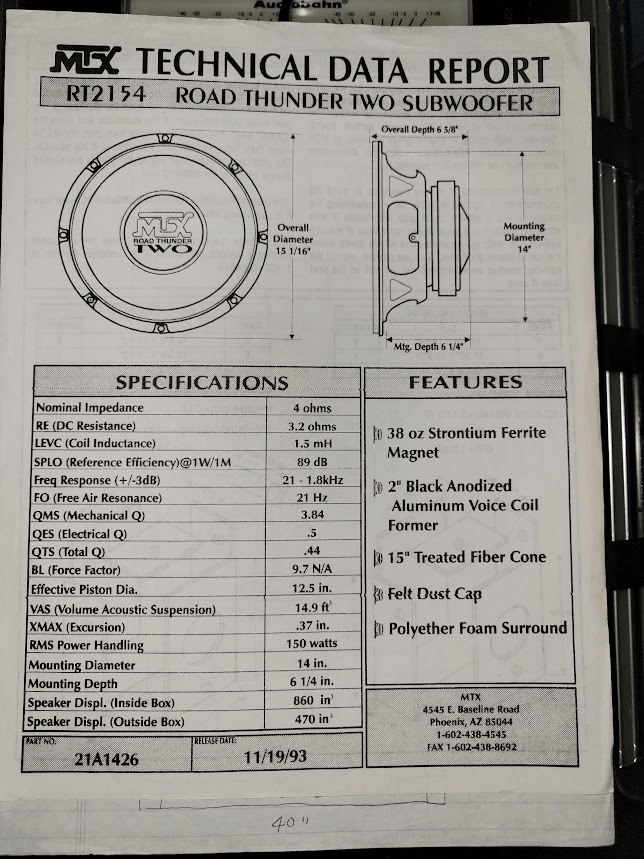

I had 4 MTX RT2154's in an isobaric BP4 enclosure in a 1983 Mercury Grand Marquis LS.

Looks great, and using four different units may be just the the thing that makes it incredible! Enjoy 🙂OK I did this and it is the most incredible sub I have come by.

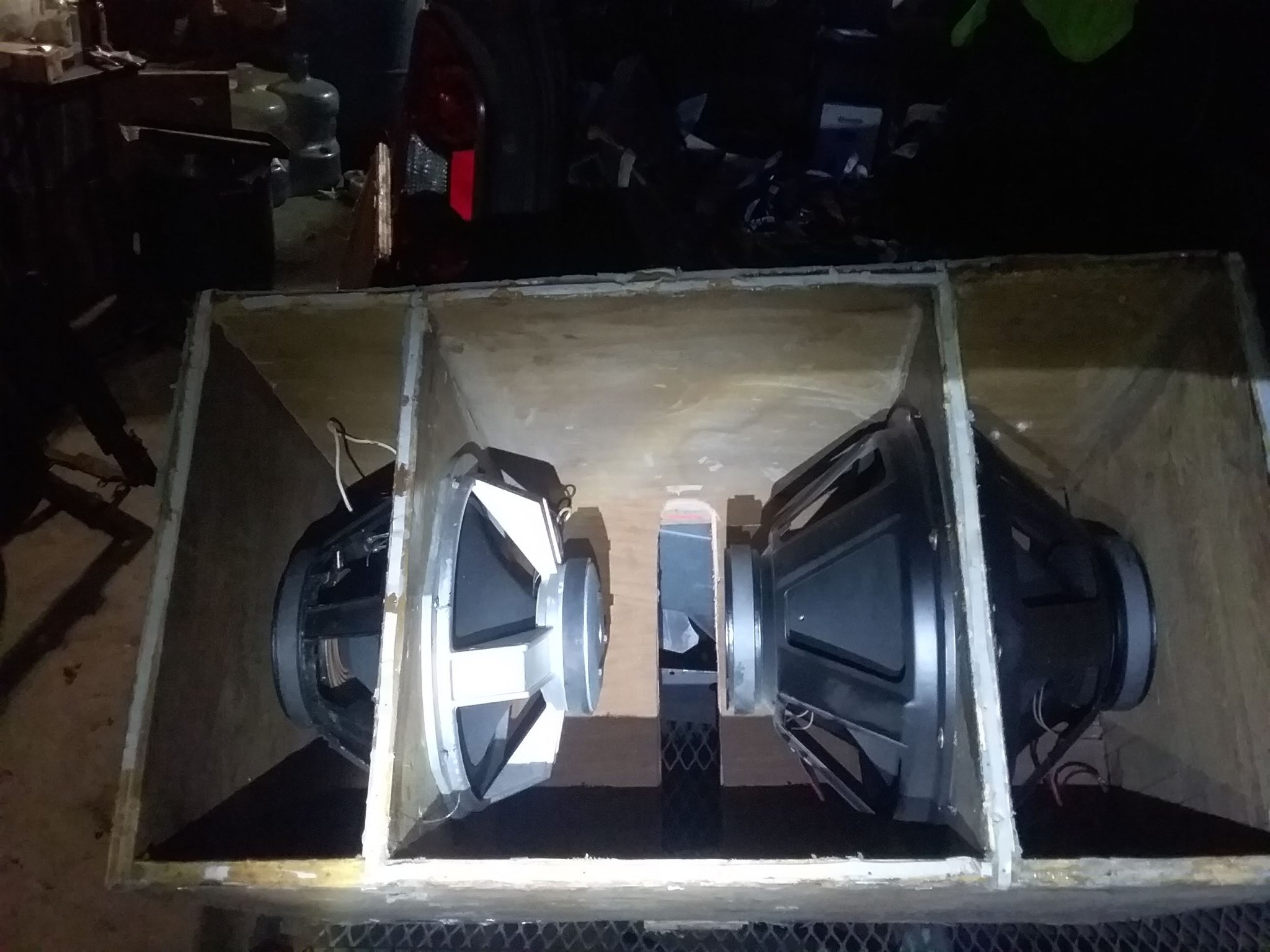

OK so the 2 15" Cerwin Vega Subs or the same speaker just different models with basically the same parameters I've since replaced them with identical Subs the 2 18s on the other side are also the same. It's exactly like they say. " a lot of output out a very small hole. I you really do want to use the same drives. In each push pull configuration or you will get cross correction.the shared chamber you don't have to worry about that so much as long As each pair have the proper volume as if they were independent just like the mass of the air between the isobaric spkrs it adds to the overall mass of the drivers the shared chamber air mass adds to the overall mass of the output of port. If anyone has any thing to add or if I got anything wrong. Lmk
How did you get the exact tune for 2 different size drivers with the same common ported chamber?
If anything, I would have the shared chamber sealed and vent the 2 outer chambers.
Roll off is that really a think...speakers are not where the sound reproduction comes from in this instant that's why they are referred to as drivers the volume of the cavity doesn't change the Box itself becomes the resonating chamber think of it as like when you have a bottle and you blow over the top of it you'll get that kind of hum whistle out of the top of the bottle the two sides can be tuned to two different frequencies I think the one side I have at 53 Hertz it's tuned to and the other side it's like 80 something hurts I have it crossed over to about 200 HZ but that's only because a crossover limitations 2hz to 400 befor roll off 8200 watts total givs 1800w 15s 2400w 18s doing the damage speakers kept breaking my bolts and eventually broke the screws holding the cabinet together the entire thing is screwed together with three and four inch screws you could have damn near a 20 oz cup of coffee in the cup holder and it'll come right out the head room is I've never turned it up passed 1/3 out of fear of breaking out the glass with windows down
