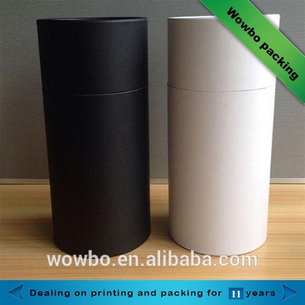

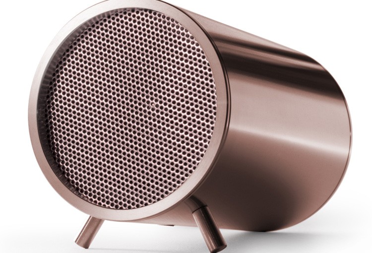

Tang Band make some drivers that look just right for this. e.g:
Tang Band W3-1876S 3" Mini Subwoofer
Stuff the driver and PR into opposite ends of a mailing / packaging tube, and it'd be a pretty simple build (example pictured).
The 76dB spec is low because of your other requirements.

Another question: the "mailing tube" configuration more or less forces a single passive radiator at the same diameter as the driver. Would it be unreasonable to use a pair of those passive radiators, one at each end, and have the driver face forward in the middle of the (not tubular) box? I'm thinking something about the size of a brick.
I have NO problem with a fairly steep rolloff below 60 Hz. It sounds like you're saying if I force that by high-passing the input signal I'll make things easier on the sub?
Also, a few WinISD calcs seem to indicate one of the other drivers I am looking at would lead to a fairly decent output bump a bit below 200 Hz, which I'm fine with.
You could mount a 3" driver opposite a 4" PR.
That'd work.
For this, it doesn't really matter what shape the enclosure is, or where on the enclosure you put the drivers.
The only exception would be if you used drivers on opposing faces of the box (like a micro Boominator).
The Boominator - another stab at the ultimate party machine
