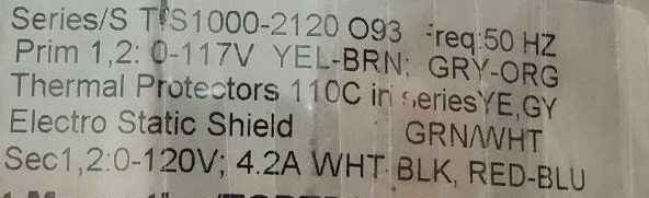

Thanks for your input kodabmx.
The label says 50Hz required. Is that a minimum? (Just making sure this thing is for our USA 60hz.)
I see the specs say 60 Hz or 50/60 Hz but am unsure if that means both, either/or or what. 🙂
Thanks Speedskater50 Hz is the minimum power line frequency.
a 50 Hz transformer requires more metal than a 60 Hz transformer.
That transformer will be happy at 60 Hz.
Good to know it is built better than needed for 60 Hz. Now to figure out what else is needed.

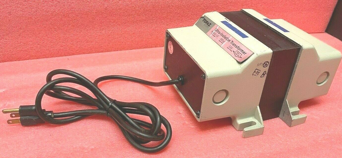

I came across this while looking for ideas on the IT build:
"You also require a low capacitance from primary to secondary for proper isolation. A transformer that is just 1:1 is not enough. Also there's fusing, a LED to indicate the primary is on, a LED to indicate the secondary is available after its switch and fuse (that shows the switch is on, the fuse is intact and the output is available). A fuse won't protect YOU, it will protect the DUT (device under test). An installed mains earth interrupter will be good too."

Assuming you are in the U.S. or Canada I think he is talking about what we refer to as a GFI or GFCI, respectively "ground fault interrupter" or "ground fault circuit interrupter". They sense leakage current by comparing the currents in the line and neutral and if they are not very close to identical this is regarded as a ground fault and they open the circuit. Mine don't have them but they are a good idea and will still work without any ground being present.<snip>

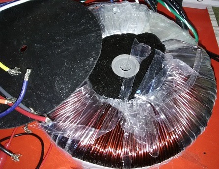

The transformer came in; it is beefy. I'm clueless how to proceed.
The cellophane wrap is tough and is bonded tightly to the top and bottom centers. Is it cut at the center or
maybe dissolved with a solvent?
The transformer comes with an epoxy potted center with a drilled hole and a flat bottom. Is it laid flat on the
rubber pad and just bolted down?
The wrap is part of the transformer insulation system (it is not cellophane) and should never be removed. If you did this unfortunately you have damaged the transformer, if you didn't you should send it back. There should never be exposed magnet wire. The transformer would be installed on the rubber pad with a bolt through the center.

Well, I should have asked first before assuming it needed to be removed.
Any recommendations on how to proceed?

I guess how to proceed depends on how much you have attempted to remove, if only a little you could get kapton (polyimide) tape and secure the insulation with it. Otherwise you should replace it.

Having a GFCI is always a very good thing, but be aware that using an isolation transformer can defeat their effectiveness, causing you to not be protected if you get your fingers tangled in high voltage on the secondary side.
The GFCIs work by detecting a current imbalance between active & neutral, which implies that there is a leakage via ground somewhere.
If you touch the secondary of a 1:1 transformer, you will get just as serious a shock as if you touched the mains but the current in the primary will remain balanced and the GFCI will not trip.
Provided the inter-winding capacitance is low between primary and secondary and the windings are floating you won't generally get a shock when you touch one side of the secondary winding, this why we use isolation transformers to service old AA5 and other devices with a live chassis.
Also we were talking about using GFI/GFCI on the secondary side, they are effective in specific instances where a live chassis has been connected to GND through test equipment and you touch the other side of the isolation transformer secondary.

What is pictured is the extent of the damage that I caused. Thanks for the polyimide tape advice.
Is 1 mil, 4.5kV rating sufficient? (I see some rated 7.5kV.)
