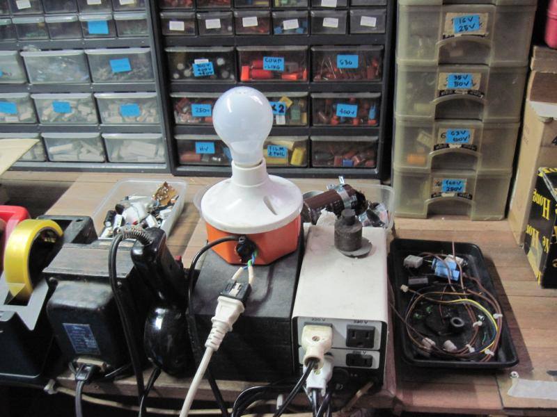

Isolation Transformer, Variac and Dimmer Bulb Tester, I have all three. What order would you suggest I hook them up ?
Hi BassNoid,
Ignore the dim bulb tester for starters, you have very good equipment there that allows you to control the energy input to the device under test.
I would use the isolation transformer to feed the variac. This keeps the current in the isolation transformer low unlike what you can get on the output of the variac.
It would be really nice if there was a voltmeter and current meter permanently connected to the variac.
-Chris
Edit: Install a fuse in the primary of the isolation transformer.

No Fuse on any of the devices ! Simple enough to add one or more of them. What value of fuse ? I have means to connect a variety of meters in the chain between the devices.
You need a fuse in the output of the Variac as the winding is the same rating all the way through so at lower voltages you can easily overload it.
Hi BassNoid,
The very first item I bought was a variac. I still have that one, it's a light duty one. I now use three depending on the current expected. The largest one is simply too big and heavy to leave on the bench. That would be for huge tube power amplifiers, or Carver power amps. I bought it under the direction of technicians that were training me. I already had a good meter and a 'scope (500 KHz - don't laugh Ray! 🙂 ). They were adamant about this, and 40+ years down the road I have to agree with them.
Some equipment can do very strange things with a light bulb in series with them, and you aren't really controlling the current with a light bulb if the device normally draws low current. With a variac, you can run the power up partially, and that allows you to troubleshoot something at lower voltages and currents than you ever could with a light bulb. The variac allows you full control over current, and allows you to correct for normal variations in your house supply. In my case, I adjust the voltage to 120 VAC and also correct for load.
The isolation transformer would work for the light bulb tester too. It can break ground loops, or allow you to work on the primary section of a device a bit more safely. They are invaluable when fixing an "all american five" type table radio as they are normally chassis hot. One side of the AC line is directly connected to the chassis. Some small TVs are that way too.
The fuse should be rated for the rating of the lowest current device in the chain. So, look at the variac's current rating, and the one for the isolation transformer. Use a fuse rated for the lowest current device.

The important thing with a variac is that it is a transformer although not an isolating type. If you set it to 12 volts and the load takes 10 amps the input of the variac will only be 1 amp at 120V. If the wire gauge of the variac can only take 5 amps there needs to be a 5 amp fuse in the output. The input fuse will not save it.

It is normal practice with variac power supplies to fuse the output. It is the most commonly overlooked thing and cause of burn-ups.

One more thing, make sure that you know the actual voltage output of the Variac. Some can boost the input voltage by a substantial amount, depending on how they are wired.
Isn't the series bulb a good idea, along with the variac, when firing up something that has sat for a long time or when working with very questionable power supply parts? I'd rather wake some parts out of a coma very slowly while looking, listening, and smelling for signs of "grumpiness".
