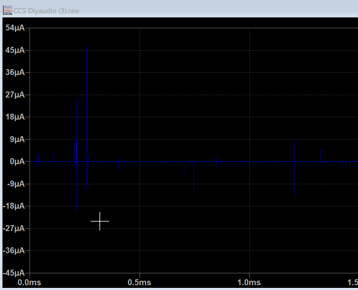

First of all thanks for all the help.
I have used the information posted by Ray to get the right IXYS part in the diagram. But I cannot get the MOSFET working in simulation. There should be around 4 mA running in each triode, with 8 mA total running through the MOSFET.
This is not true in this simulation. LTspice runs the file without any errors. I'm pretty sure I made a mistake somewhere, but I don't have enough knowlegde of LTspice yet to find out what or where.
I attach the essential part of my diagram with the MOSFET CCS. I see the old ISYS part is still mentioned, but I don't think that causes the difference.
Regards, Gerrit
Regards, Gerrit
If you reverse V3 (negative bias voltage + tied to ground) and set value to "-40V", the result on "-" pin is +40V!!!
Change "-40V" to "40V".

Thanks for correcting my serious voltage error! I will check the other tube models tomorrow.
I changed my "big" diagram too and now it looks a lot better.
