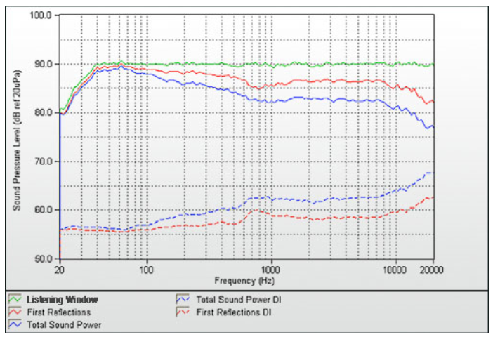

The way JBLpro speaker measurements are shown, is special
At first look it is excellent. When we read it more carefully we notice that (perhaps)
Listenig window response is averaged response 0 to +/-10 or 15 degrees horizontally
First reflection response is 30¤ or averaged 30-45¤ horizontal response
Power response is sum/average of 0 to 60¤ horizontals
This way of presenting anechoid measurement data is not standard but very good! Ít tells a lot of a speaker's performance
