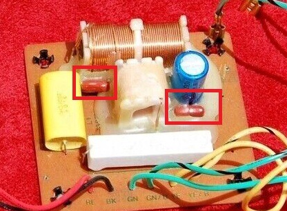

I have a pair of JBL L1 standmount speakers and I'm looking to refresh their crossovers capacitors and change the resistors for better quality ones.

I've found that Clarity cap have 3uF capacitor in their CSA series.
BTW what is the purpose of the 0.01uF bypass capacitors?
A large value capacitor exhibits inductance at a high enough frequency, an effect known as ESL (Equivalent Series Inductance).
The small value bypass capacitor eliminates the ESL.
Personally. I don't consider ESL to be an audible problem in loudspeaker crossovers, but some audiophiles with ears like bats would disagree!
My opinion is that there is no need to include the bypass capacitor if you employ a high quality tweeter capacitor.
I'm curious to know if JBL actually physically included a bypass capacitor across the woofer capacitor in your crossover.
If you feel you must include a bypass across the tweeter capacitor, the likes of an Audyn 0.01 uF at £2.50 would be more than "fancy" enough.
