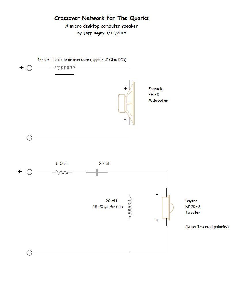

a Boenicke W5 type enclosure, add the following:
Jeff Bagby's Quark
https://techtalk.parts-express.com/...ery/65800-the-quarks-m-o-s-d-computer-speaker
Subwoofer- you could use no crossover for the sub
https://techtalk.parts-express.com/...-blue-quarks-with-a-not-quite-voxel-subwoofer
https://www.parts-express.com/100-H...utm_medium=Impact&utm_campaign=Impact&irgwc=1
Jeff Bagby's Quark
