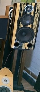

FS my Jeff Bagby Helios Spaeakers.
Simply the best 2 way bookshelf I have ever heard.
SB Acoustics Berillyum Tweeter in waveguide + 9,5" satori bass driver + 10" SB acoustics passive radiator.
Crossover was built with intertechnik and Jantzen Audio air core coils (Cu 1,4mm) and jantzen z-std and cross cap
The best speaker Jeff ever made, and his last creation before passing.
I'm asking 1400€ for these fully built speakers, what I think it's like a bargain because only the drivers, not including crossover, wood and work, will be that amount.
they habe been used less than 15 hours.
Shipping within EU will be like 40€. I have all the original boxes for all drivers and would be safely shipped in separated boxes if needed.

The bigger towers (white drivers) are Jungson HSBS speakers.
Those you say "stunning" (thanks) are a self creation. SN acoustics Berillyum tweeter+Textreme midwoofer+Satori bass
For sale too if interested

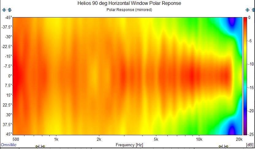

I promised I would write up a little on the Helios that I received (in excellent condition thanks to raelman!).
Some notes on this speaker:
How do they compare with the LX521 - surprisingly close despite being a completely different design. LX521 has a more open sound with more depth, and neutral tuning. Jeff Bagby Helios is slightly warmer, slightly less open and less soundstage depth.
However, LX521 is a pain to live with, you need DSP/ASP and 6-12 channels of amplification. I am sufficiently satisfied with the Helios, and can also run them with a regular 2-channels of amplification. I think SIT-3 will significantly narrow the gap. I also prefer the slightly warmer tuning of the Helios. Pass amps are also buttery smooth, which is really nice (I had no hope trying to use a First Watt amp to drive LX521's, they need 50-80w per channel).
I did previously have Troels 3WC-15 with the SBAcoustics TW29BN-B-8 and 18 SOUND 8NMB42 - Didn't last very long in my setup as the vertical sweet spot was very narrow and they just didn't have much soundstage height (due to MTW?). I significantly prefer the Helios, although the 3WC-15 has a more lifelike and detailed sound. I thought the waveguided Beryllium tweeter in the Helios would have equalled that of one in the 3WC-15, but it does not - perhaps it is the fact that the TW29BN-B-8 is a direct radiator (no waveguide) in the 3WC-15, or it's the 18 SOUND 8NMB42 which is superior, or a combination... I don't know.
Things I would like to improve on the Helios - it would be great if they had a wider power response (30 degrees both vertical and horizontal) from 5kHz to 15kHz, but try finding a tweeter that will do this kind of response off axis is almost impossible. It'd also become a completely different speaker, perhaps as a 3-way.
- They're circa 85dB efficient and 8 ohms or higher throughout most of their frequency response (only dips down to 4ohms once in the bass). They work fine off my Aleph 3... I'm yet to test them with the SIT-3... will do so this week hopefully.
- They have excellent wide directivity - and I believe this is one of the key features why they sound so good.

Doesn't helios have a waveguide? You could try and design one that widen the response up top, as replacement. Hard work though.
Some diffraction interference seen on the helios polar map, dip on axis ~2kHz, peak at ~3kHz. If you want to improve the helios you have you could do it by adding slants/roundovers to the baffle reducing the baffle edge diffraction effects, like the Joachim Gerhard speakers have for example. If you end up making new front panel with slants the mid tweet c-c spacing could be changed as well to help the vertical dispersion at the xo, reduces the effect of lobing you mention but needs changes in the crossover as well. Search for alias Kimmosto suggestion to use ~1.4wl c-c with slants for smoothest early reflections.

Uh, edit time over and I now see photo of the speakers on the first page. New front panel might ruin the nice enclosure so bad advice, keep them as is. Seems to be close how they are designed. If interested on any of my suggestions new enclosures would be better option, prototype or two after measurements, new xo and all means lotsa work but could be interesting to compare if the sound gets any better.
