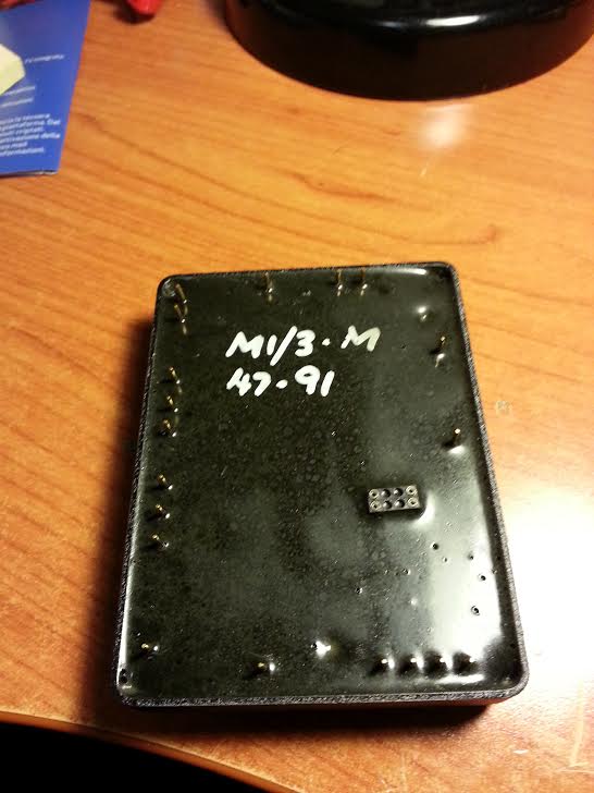

Are you able to open it and take high resolution close-ups? We always appreciate it and someone may well offer advice.

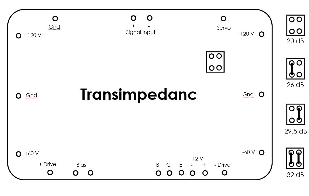

I have removed the driver module of my Jeff Rowland Model 1 from the main board. As described in the user manual, the back of that module shows some sockets meant for jumpers (see attached picture).
Unfortunately I don't know how to place those jumpers to set the gain at 20, 26, 29.5 or 32 dB (the values indicated in the user manual).
Can anybody help me?

Please, I have the same problem. I have two model 1 used in mono and there is a gain difference. Can someone telo me how I can check gain and how adjust, user manual given't instruction?
