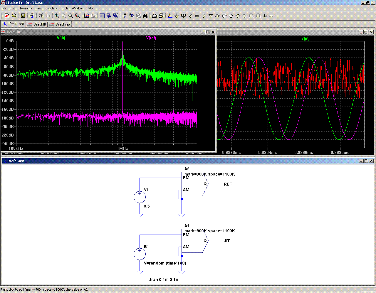

Is it possible to simulate the jitter of an oscillator with LTSpice ? If not what software can do that (preferably free) ?

Something like that?
You can change the jitter profile by inserting any mathematical expression into B1's value.

It is possible to reproduce any measurement you make in the real world in simulation: the FFT tool is the equivalent of a spectrum analyzer, and by measuring and integrating the power vs carrier offset, you could derive the phase noise.
You have to configure carefully the simulation and fft parameters to avoid measuring sampling artefacts.

high Q oscillators are painful to sim due to the huge number of complete cycles of oscillation you need to sim, each at good resolution for the phenomena you want to see
the other problem is noise modeling in a .TRAN analysis isn't "native" - you have to add the component noise as additional models with the statisitics you expect
better oscillator circuits have low enough electronic noise that thermal drift, microphonics from external vibration become important - you would need to add even more "custom" sources to the standard Spice models to see these effects in a sim
