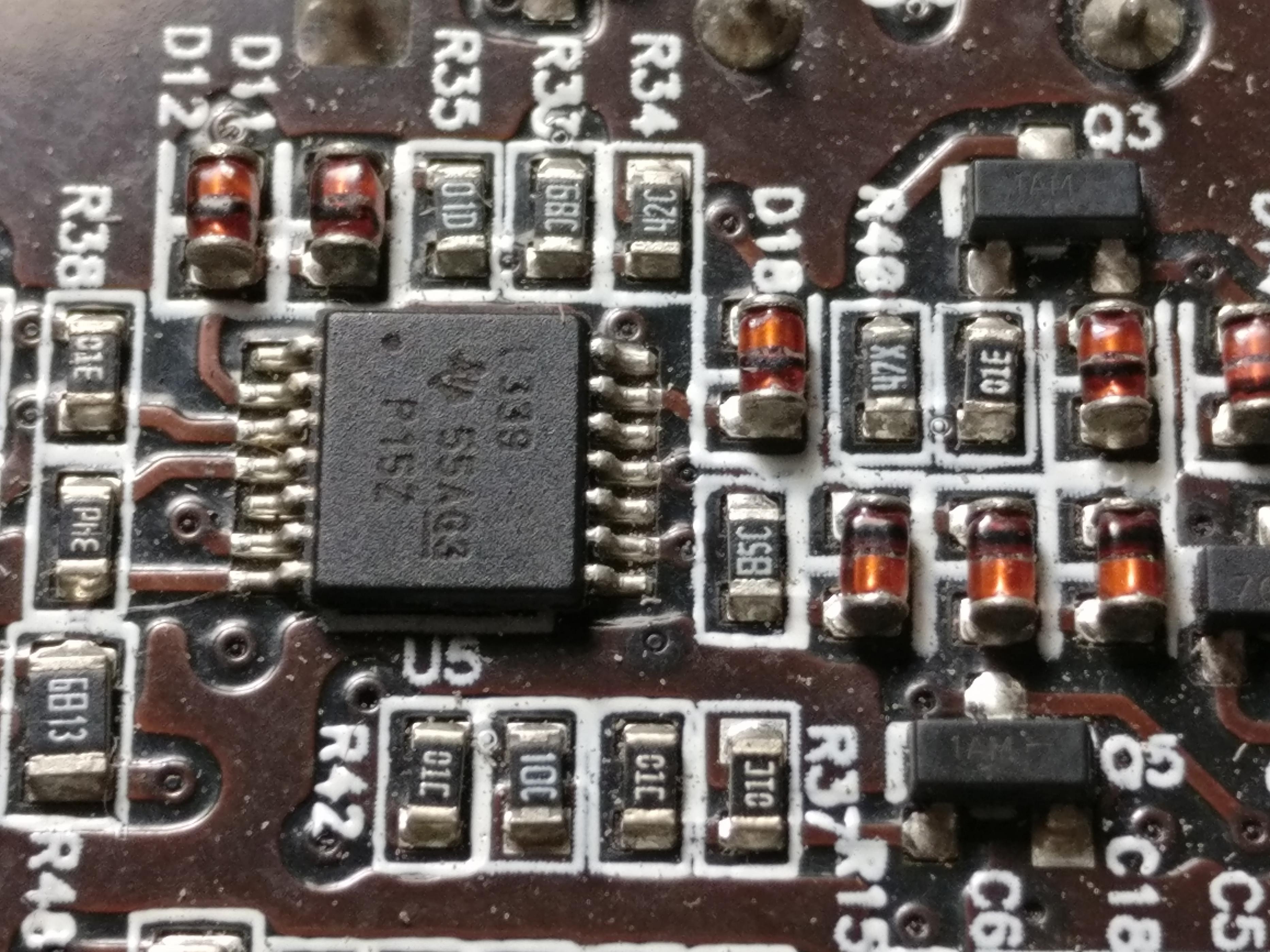

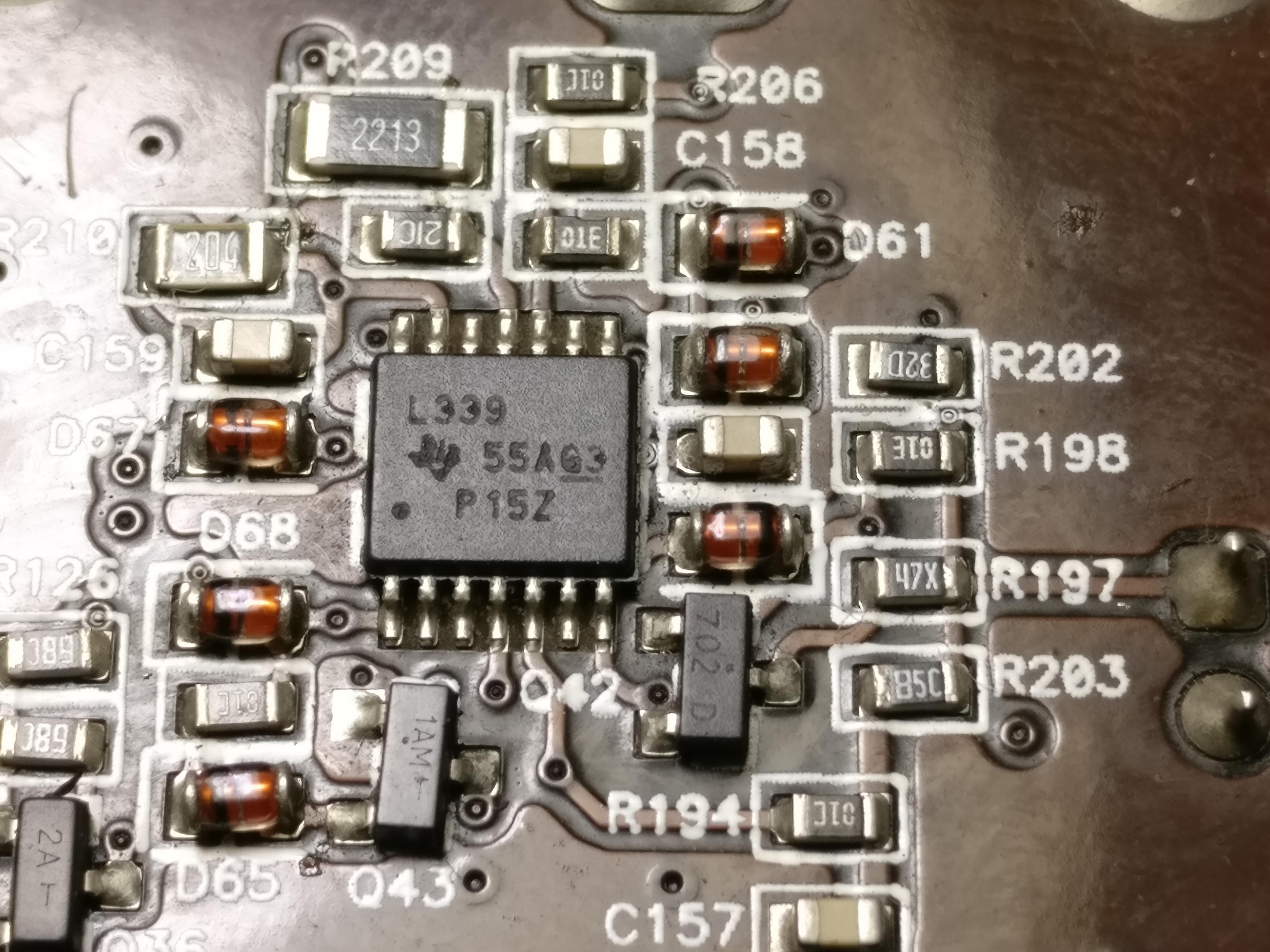

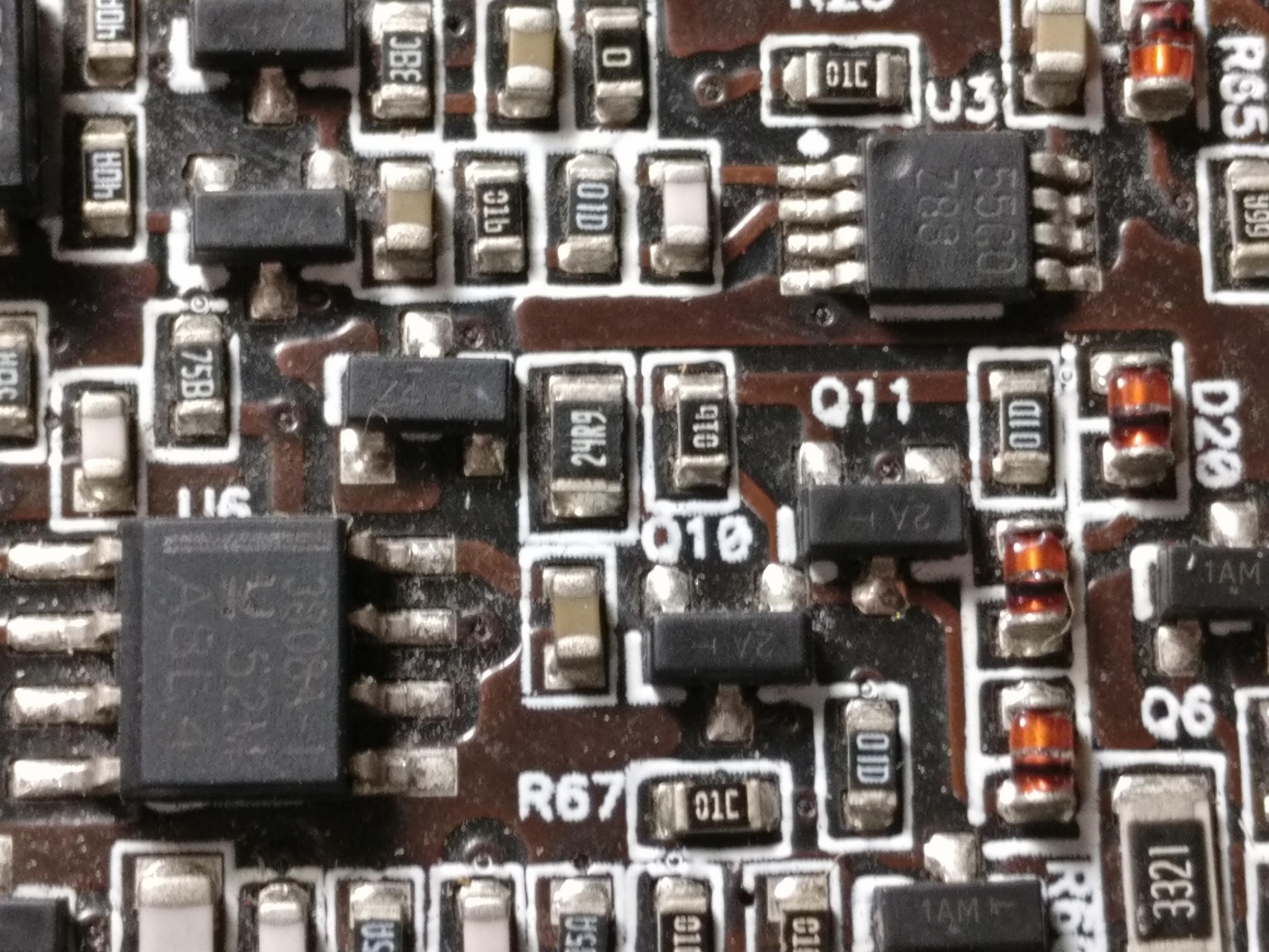

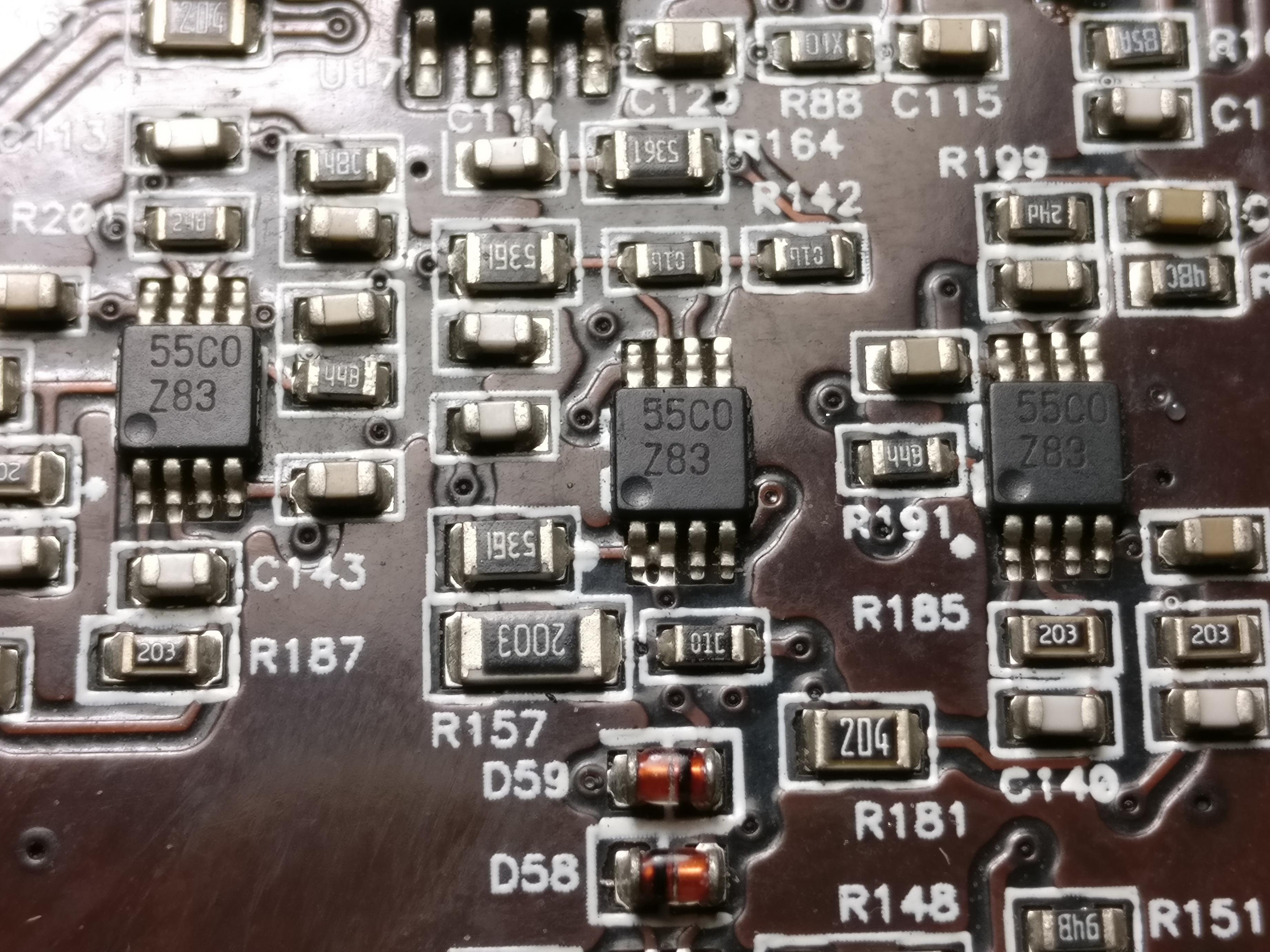

What are the other ICs used with the output drivers?
I am really hoping to at least get some suggestions as to what can be used on these locations quickly as I have to place a Mouser order no later than tomorrow....
These are the ICs on the board...
Also, what is L4? I believe it is still functional but it sustained some physical damage. It is the same as the other 3 just like it.

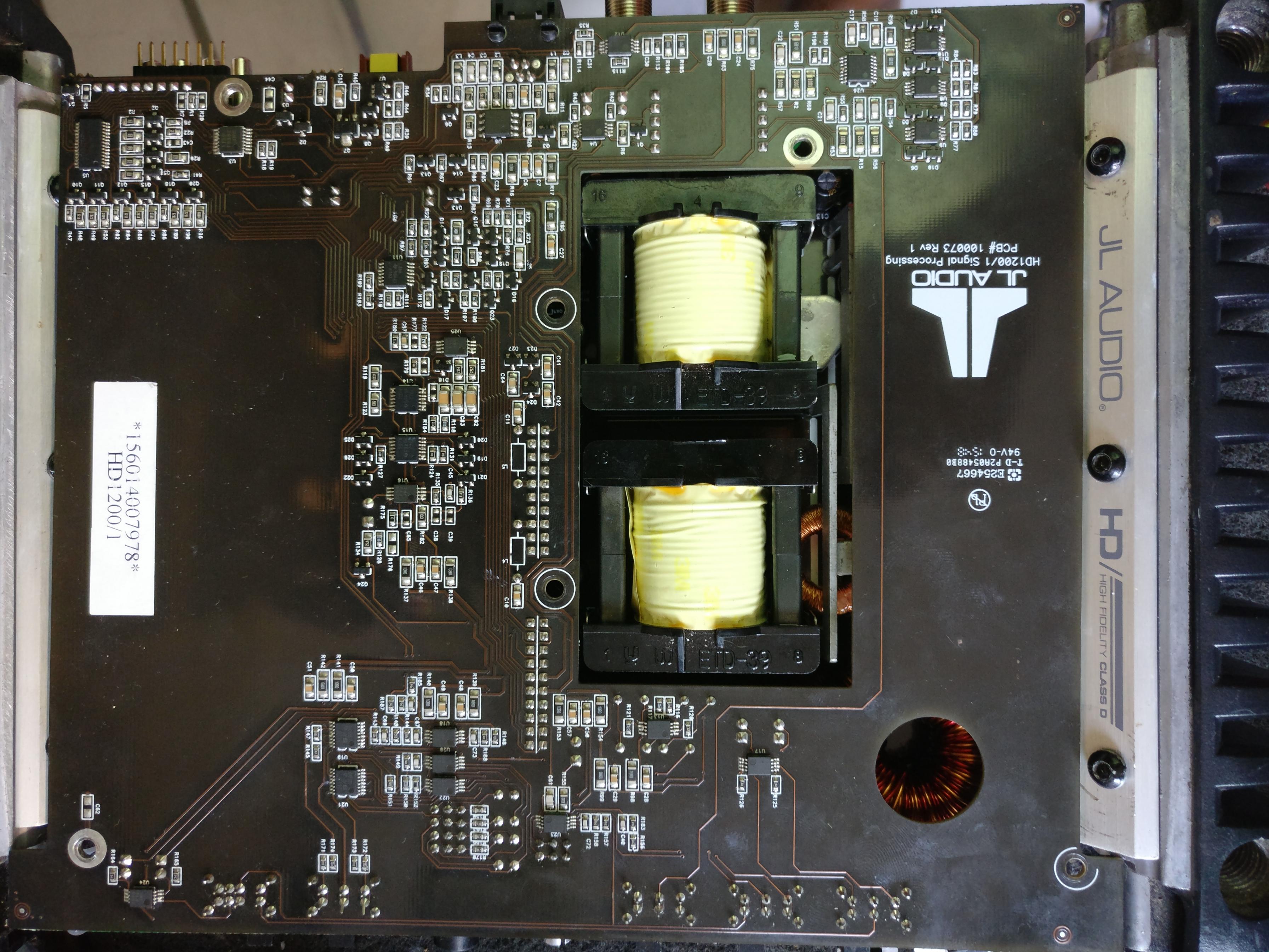

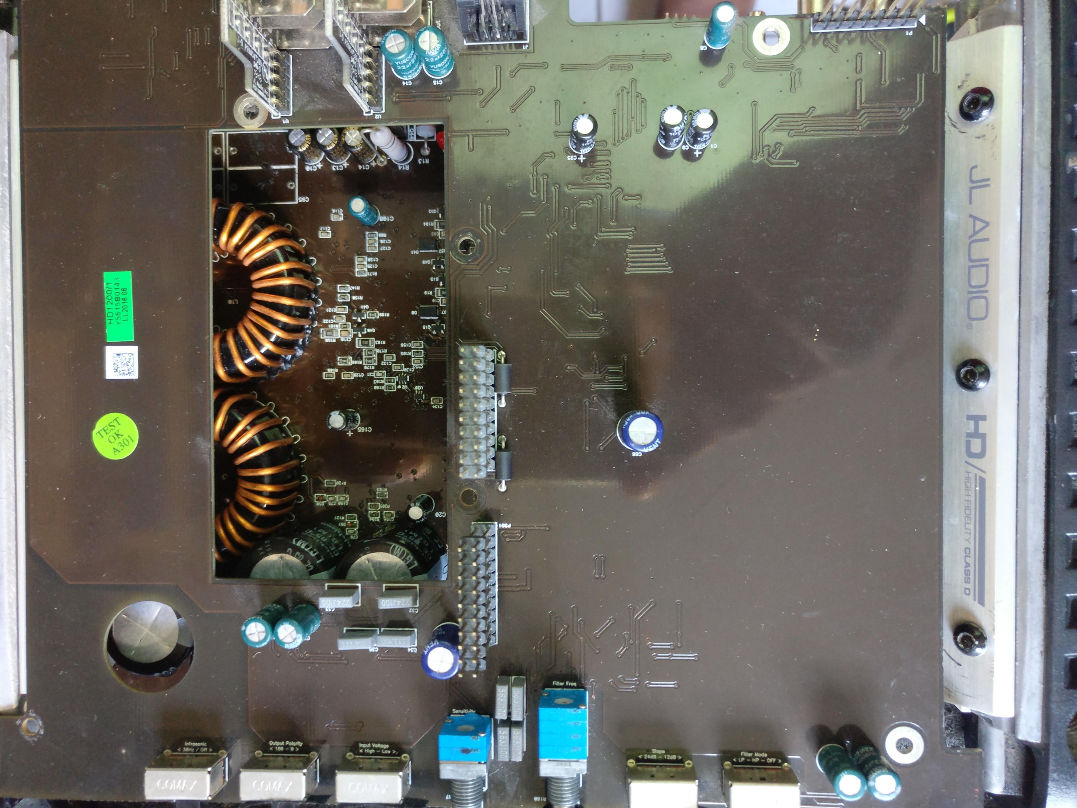

Hey mild2wild, can we get a overview shot of the whole board. JL had several amps that they did revisions on and then called it a different part number.

Hello. How did the amp work out? I also have HD1200 and also it needs to be repaired. Did u find any schematics or service manual for this?Board pics...
Hello. Hope there would be a reply on thks.Hey mild2wild, can we get a overview shot of the whole board. JL had several amps that they did revisions on and then called it a different part number.
