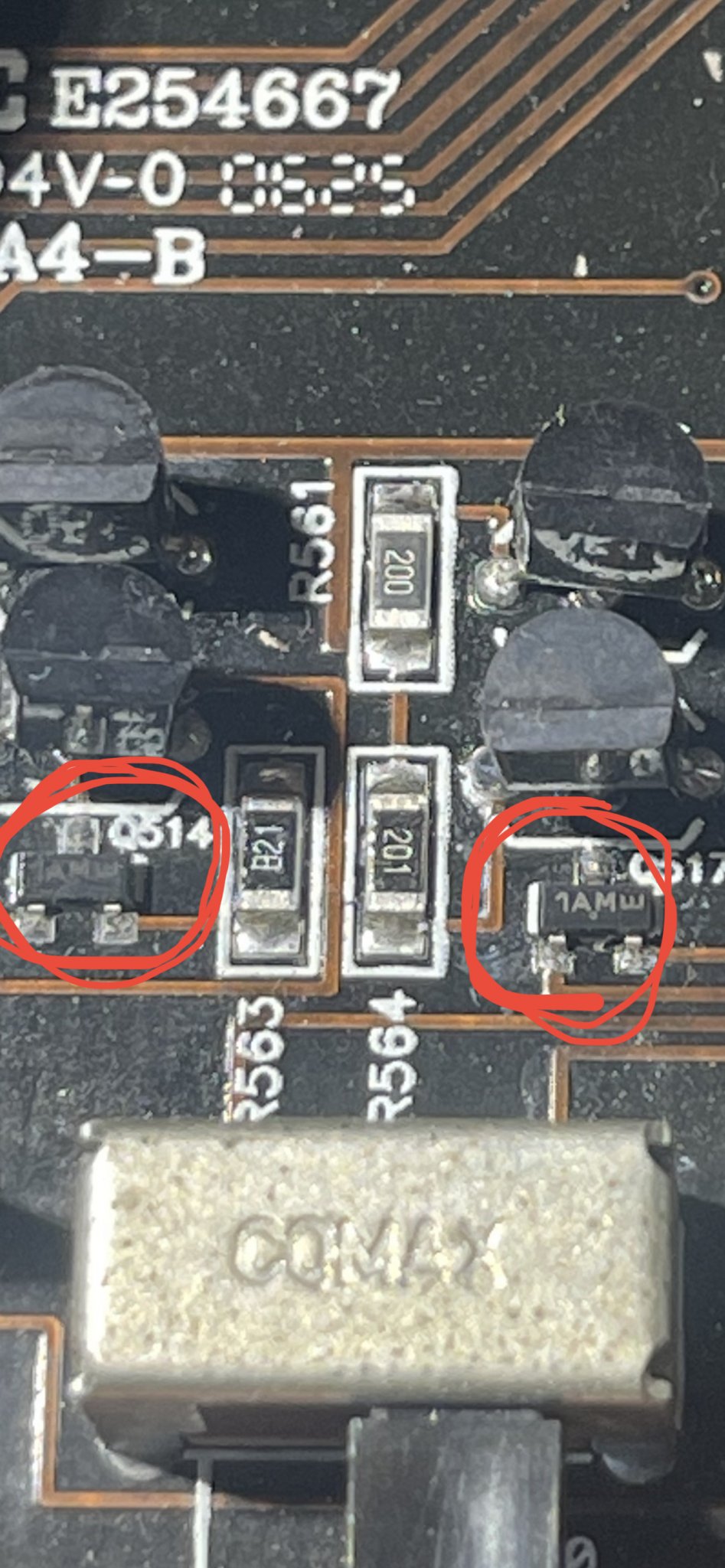

Next move is to order and replace those MMBT3904L BJTs @ Q514 & Q517.

Replaced the Q514 & Q517 with MMBT3904L and still “Low voltage” LED, no others.

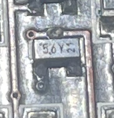

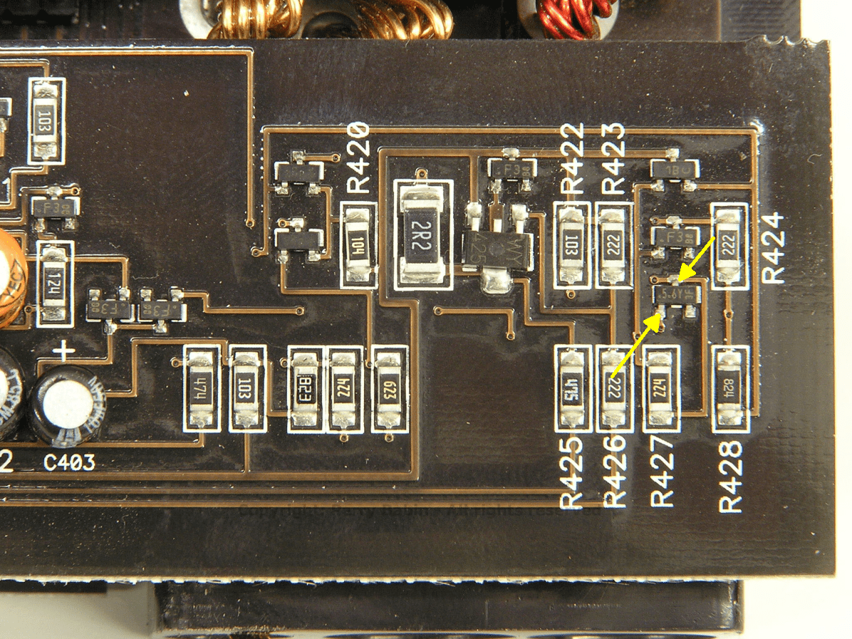

That Zener diode has either a 5.6 or a 6.2 on it. That's the rated voltage.
Lift the diode and see if it's leaking. If so, replace it.

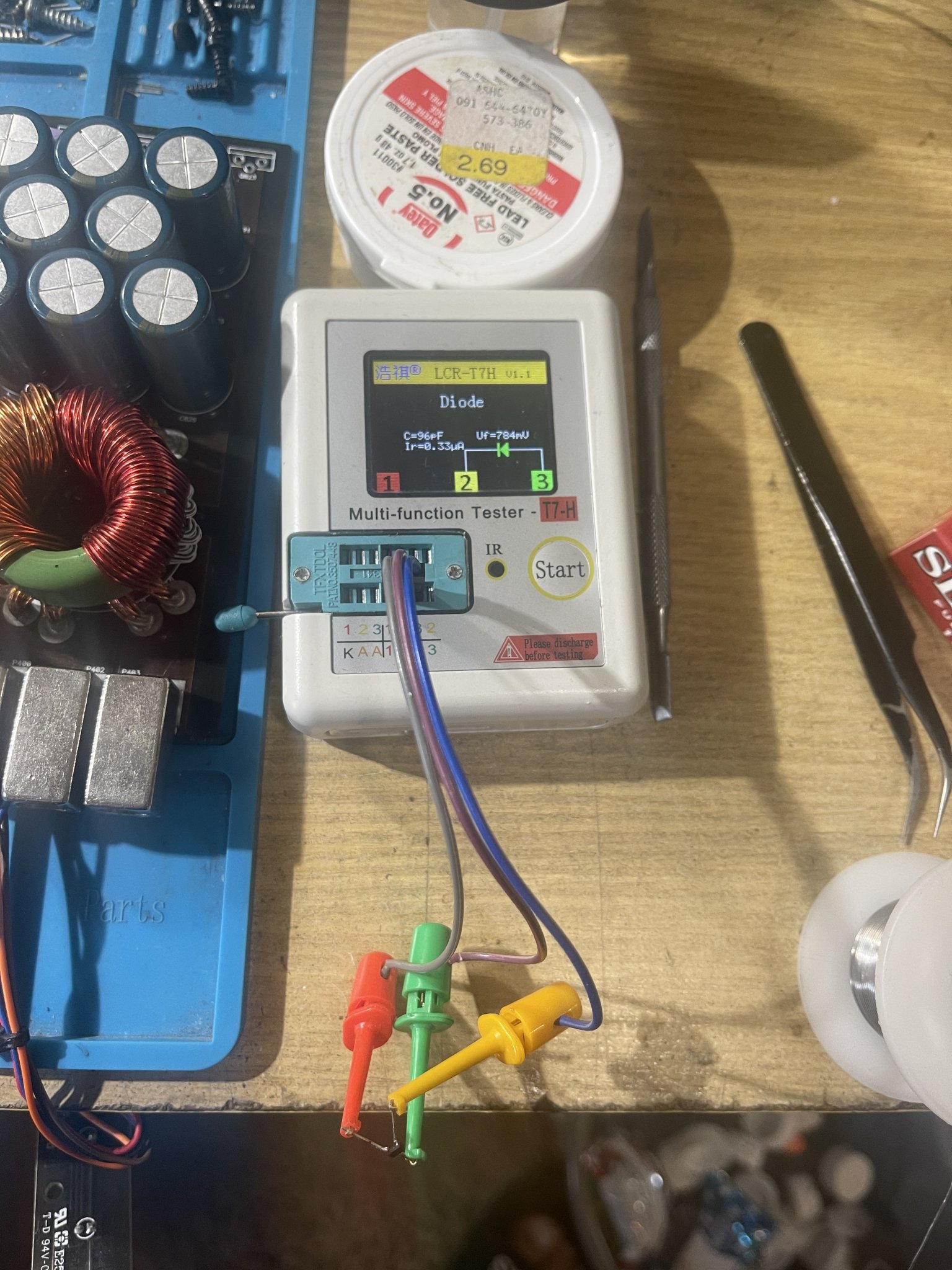

This is embarrassing but I do not know if this is leaking or not from the LCR readings. The amp I have uses the 5.6 diode, pic included. I actually only have experience with the glass axial leaded type of Zener Diodes, I didn’t even know they came as this type. I’m going online now to research it, if there’s another testing method other then my Cheap-O/T7-H, and to find out what exact Zener diode this is and find an exact replacement.
Checking with a multimeter across the terminals with the arrows should check just like a diode. Current passes one way but not with the probes reversed.
If the diode isn't leaking, there may be a break in the source of voltage feeding it. There is a resistor feeding it. What is the voltage on both terminals of that resistor?

“5.6” as follows with with DMM in diode mode:
Zero reverse voltage
.728v forward voltage
Looks like R427 “224” (which is within spec) is feeding the Zener Diode 5.6, I am barely reading any voltage on that resistor. About 220mV on each end of the resistor. I’m going to remove my kapton tape and check the area more finely

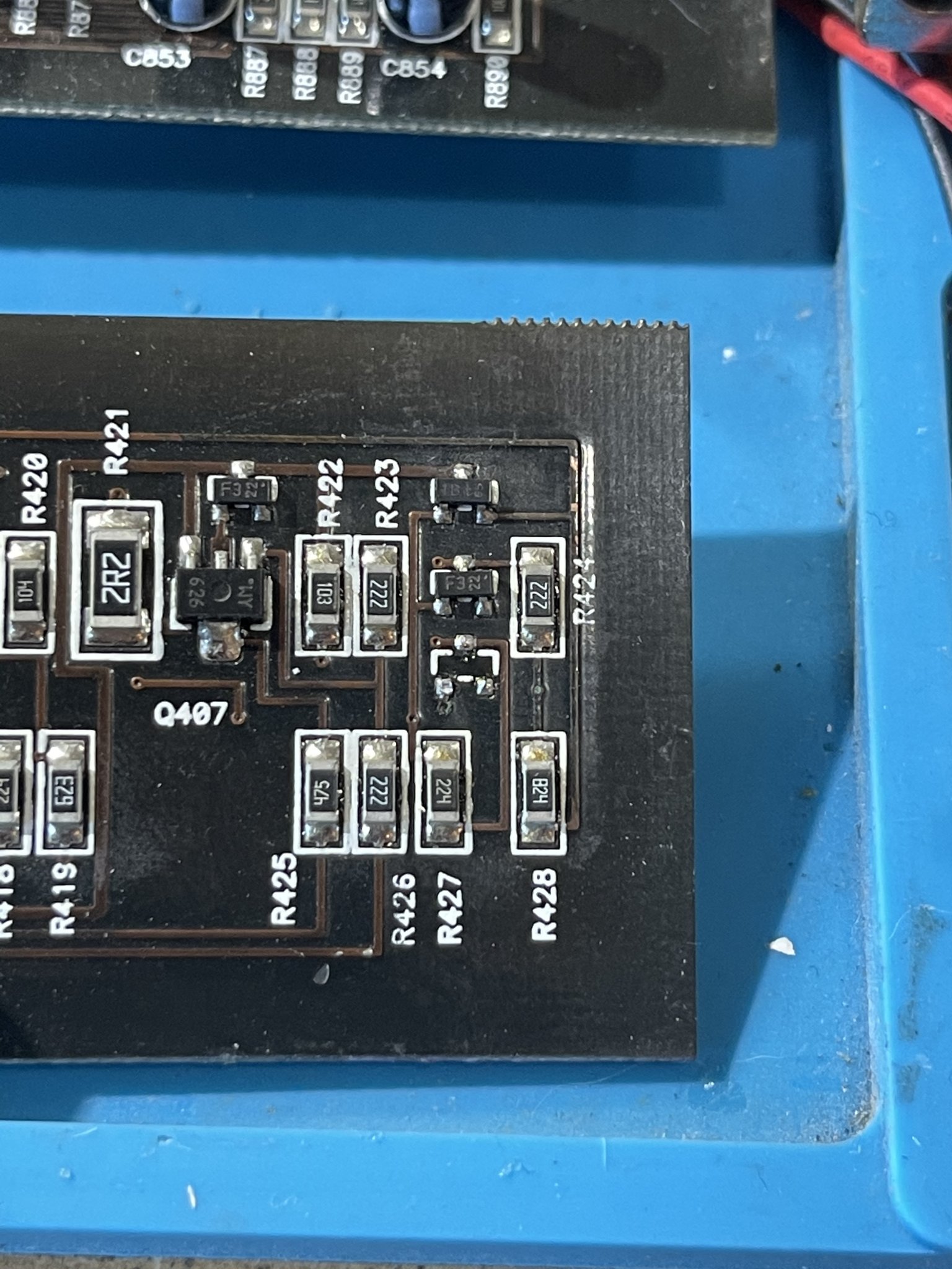

I don't think that's the right resistor. Follow the trace on the back of the board that leads away from the via on the top of the Zener.

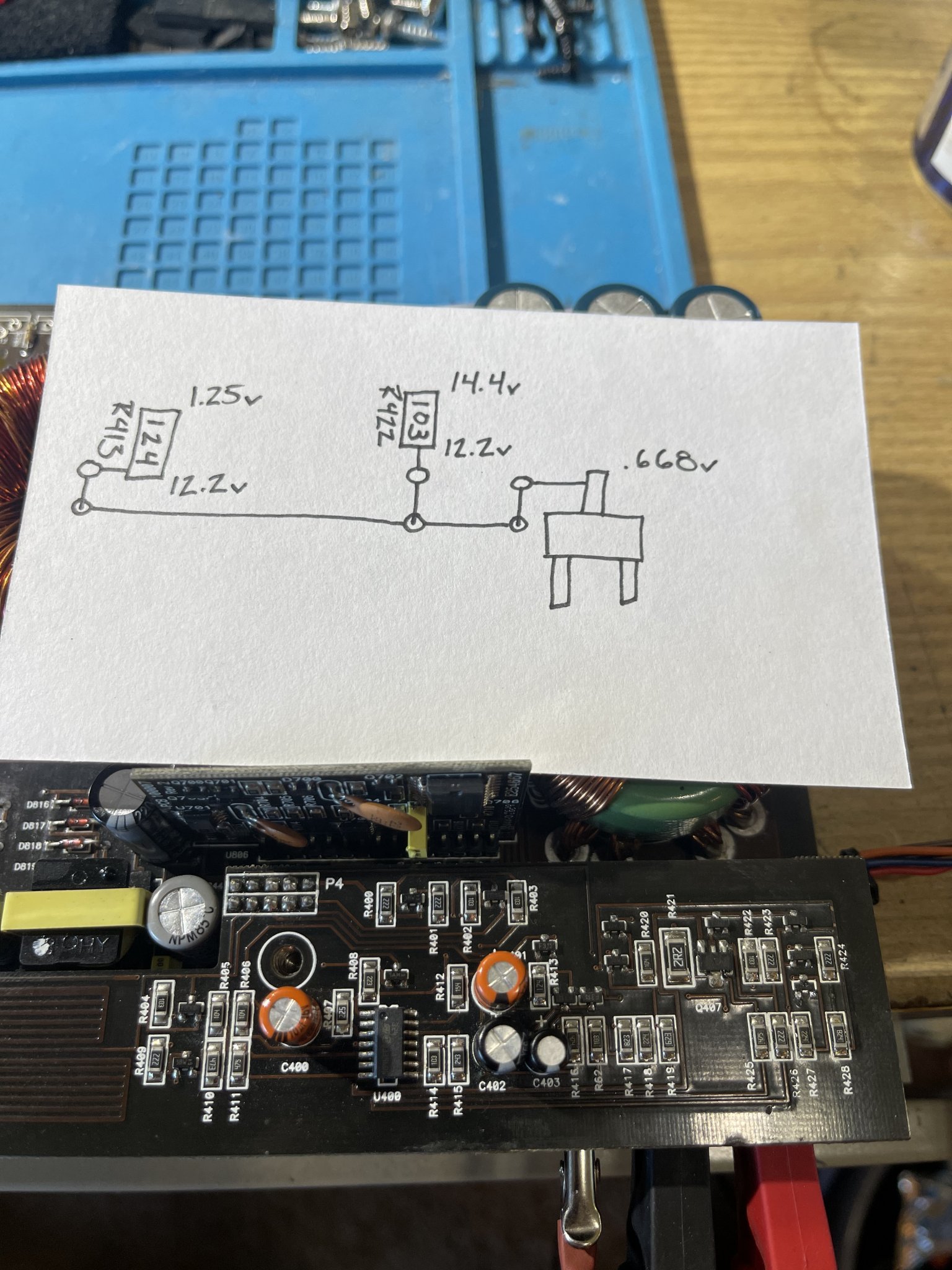

So it looks as if there’s 2 resistors on the trace feeding the top leg of the 5.6 Zener. The left bottom leg is connected to the copper backplate, doesn’t look like right bottom leg is used.
i drew it out to be more clear. 14.4v/10a feeding amp.
Looks as only .668v is getting to the top leg of the 5.6 (still removed as in pic) when 12.2v is feeding that trace. The via must be broken/corroded to the point only .668v is passing through right? Arrows drawn on reverse of daughterboard is pointing to via that feeds the top middle leg of the 5.6. Seems that the top leg should be recieving the 12.2v that’s on that trace from what I can see. I didn’t even think a via could break/corrode but it does make sense when specifically thought about.
That is exactly what has happened I think, continuity mode shows there is no contact between the vias, and I think that voltage is from the resistor below. I have micro drills I use for modeling I am now attempting to reconnect the via.
you called it Perry, a break in the trace 🙂 tysm
