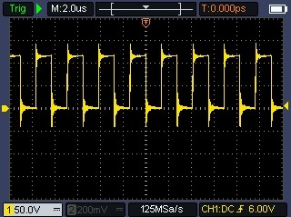

With the preamp board installed and the amp in protection, I checked for rail voltage and it was present. I checked the drain of one of the output MOSFETS (Q106, the only one I can get to with the preamp board installed) and it had the switched rail voltage present ~120v square wave with a frequency of 360-370kHz.
