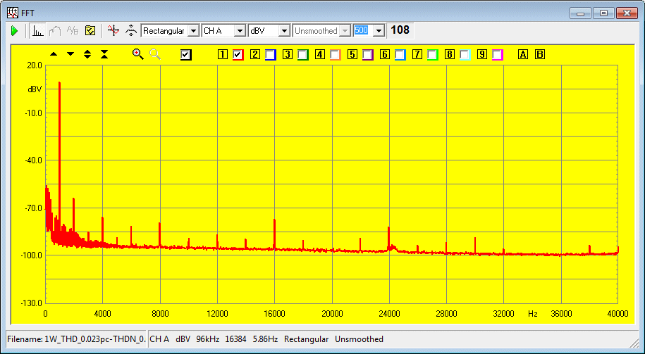

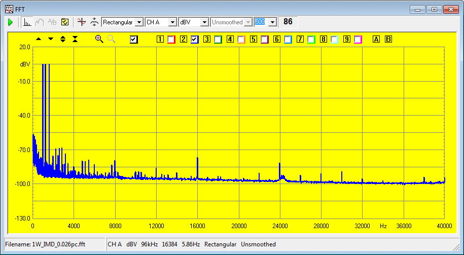

1 WATT DISTORTION MEASUREMENTS:
The "First Watt" is always the most important. All below measurements were made into an 8 Ohm Dummy Load.
1 Watt THD 0.023% & THD+N 0.051%
Note that Odd Orders are well suppressed. Small amount of 1/3rd and 1/5th. All the others are Even-Orders and of less concern, even if elevated relative to Odd-Orders. Higher power measurements shows an interesting trend, the Odd-Orders are on their own plateau than the Even-Oders on a higher plateau. So please continue...
1 Watt IMD 0.026%
The clusters form around Even-Order frequencies. Quite pleased.
Next, higher 10 Watt measurement.
Cheers, Joe R.

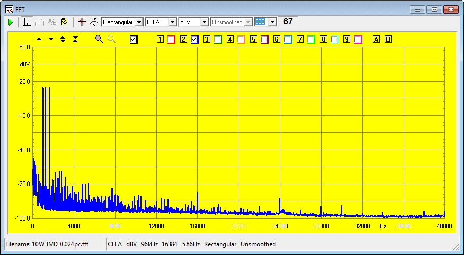

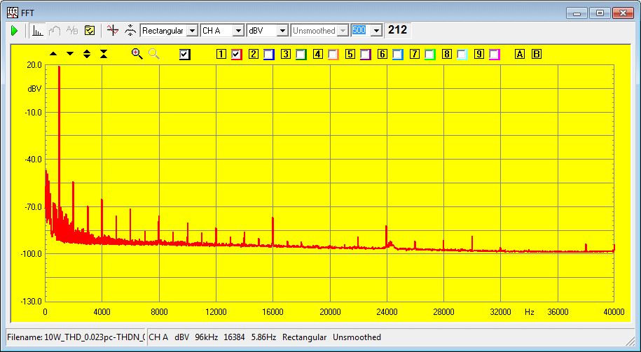

10 WATT DISTORTION MEASUREMENTS:
10 Watt THD 0.023% & THD+N 0.028%
Here we see that interesting trend again. All Odd-Orders are suppressed relatively to the Even-Orders immediately above and below - on a lower plateau.
10 Watt IMD 0.024%
Quite pleased.
Cheers, Joe R.

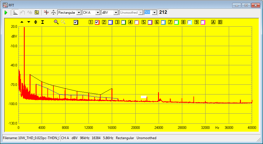

And interesting trend when looking at 10 Watt THD:
I would ignore that 16KHz peak, I seem to get this quite often when using 96K sampling frequency with other DUTs (devices under testing). So it is an aberration of some kind.
DO YOU SEE THE TREND?
The Black lines join Even-Order Harmonic Distortions and the Blue the Even-Orders. Note they are on different levels or plateaus?
I see a similar charactersitics in the 10 Watt and 20 Watt IMD measurements, the IMD clusters are visible for the Evens, but noticeable suppressed for the Odds.
This may well seem a characteristic for transconductance amplifiers.
I can say that the amplifier is very nice to listen to, IF you have compatible loudspeakers. Not your ordinary Chip Amp.
Cheers, Joe R.
PS: I also have 40 Watt THD measurement, showing that it clips well above 40 Watt. Also have IMD measurements up to 20 Watt (with current setup limited to 20W IMD). May post these later.
