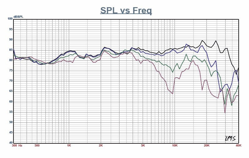

Please do dave's Gloss coat and let us know!I'll throw a wrench in this thread and introduce you to the SBAcoustics SB65WBAC25-4, if you like small metal cones.
That little driver renders woodwind and stringed instrument like crazy. Its dispersion pattern is closer to a tweeter, and it doesn't ring in the mid-high range like some metal cone drivers out there. Of course, it needs support in the low end, which you say you have already.
It impressed Jim Griffin so much that he made line arrays out of them.
Something to add to your list of 2.5" stellar drivers.![]()
Below 2 kHz they're champs, flat response and low distortion. Higher the response goes haywire. Best used in a 2 way IMO.3 of the first, it was hard to believe what we were hearing given their stellar rep.
https://audioxpress.com/article/Test-Bench-SB-Acoustics-SB65WBAC25-4-2-5-full-range-driver
