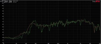

By the way, I've been experimenting with Bose 901 Series III Drivers and threw one in a .2 cuft vented box and measured it's FR with and without three coats of Wet Look treatment for paper cones (sold by Parts Express). That stuff makes a HUGE difference!
The beige curve is with three coats of Wet Look and the green is uncoated. The F(s) drops by ~10Hz and the response is much smoother with the coating.
wow! - do you figure Wet Look is different than Mod Podge?
They don't disclose its composition of Wet Look, but my guess is polyvinylacetate binder with some graphite pigment. The first coat gets sucked right into the paper and leaves a flat finish. Second and third coats bring out the gloss because they sit more on the surface.
I originally did this because I have 38 of these drivers and the blue color varies quite a bit from lot to lot. The idea was to make them look more uniform for a potential line array project. The good testing results were a surprise...I was just hoping not to ruin them with the stuff!
