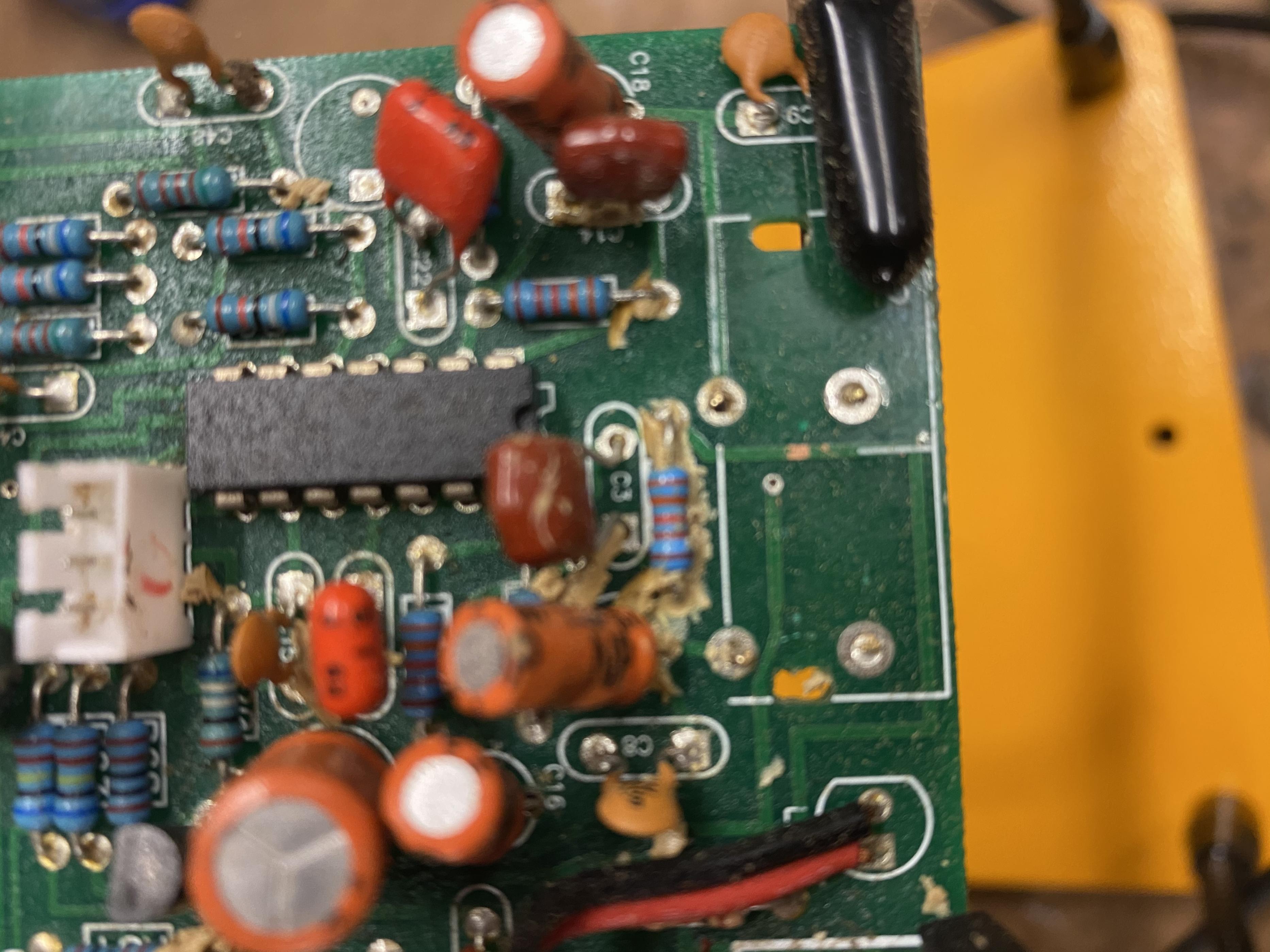

I’m new to this so please go easy on me...I have a Boston acoustics sub woofer with an rca jack that I need to replace. Was able to get the old jack off the board but I can’t seem to get the old solder out of the 4 holes so I can install a new one.
I’m looking to recap my old hailer amp and get into some diy audio a bit and figured this was an easy starting point. I got a hakko soldering iron, tried 750 and 850, different tips, lots of flux, suction and wick. It’s like the solder in the board won’t melt at all. I tinned my tip and all that. Not sure this picture helps but I must be doing some newbie mistake...

So the thin leads on the inner are the RCA tips, which should be easy enough to get out. As rayma says, if there was lead-free solder in there you have your work cut out for you. More so on the ground side, if there's a ground plane it will be even worse.
There are a few strategies. One is to mix 63.37 in a couple times and wick up the residue. Sometimes it might not work even after your best efforts, depending on what the base solder was. I also see your chosen method of removing the jacks was cutting off their leads, but they are now sinking some additional heat.
For simple connectors like RCAs you can choose a shortcut and drill the holes out. The ground plane is on the reverse, so if you choose a small enough drill bit you should still have enough pad area to solder to. You'll likely drill out the hole plate when drilling so the top/tip connectors will need some deft work, but should be doable with a thin iron and steady hands from the top.

Thank you all for your help. Today I did the following...
- used 63/37
- bumped iron to 454C
- used largest tip and tinned it real good
- preheated the area of the board with my hot air gun
Using solder added to the existing and then wicking it all up worked! Some holes took more patience than others. On one hole I pulled the old pin out from the top of board and it looked liked the tiny round plate it was attached to came with it. Looks like I remove a very small part of the PcB board. The bottom of this hole looked fine though.

If there were pads on top and bottom, at least it´s twolayer.I pulled the old pin out from the top of board and it looked liked the tiny round plate it was attached to came with it. Looks like I remove a very small part of the PcB board. The bottom of this hole looked fine though.
Have to wire it up after replacing the RcA jack. Just wondering if these boards are usually multi layer or s9mething? Or if the bottom solder is solid and goes through I’ll be ok?
Does any track or copper fill led from top pad to anywhere else?
IF so, you lost a connection and have to replace it, maybe with a thin wire "hair" pulled from regular multistrand wire, which is as thin as you´ll get at home/hobby level.
If possible, show a topside closeup picture.
SOMETIMES there is a top pad leading nowhere, just created when drawing the PCB .
IF so, don´t worry about it, but to be certain post that topside picture.

layer but if it did, it needs to be connected. JM Fahey mentioned "a thin wire "hair" pulled from regular
multistrand wire". The finest strands I have found come from old style computer cables for COM
or parallel ports. Those strands can be used to repair 5 and 7 mil traces as I have done on Sony digital
BetaCam boards when recapping. Normal stranded "hookup wire" is way too coarse for board work.
30 ga wire wrap wire is a big as I use for board fixes. I keep and old printer cable in my desk for
occasional board fixes. I've been nibbling wires out of the same cable for 10 years.
G²
There was no need to use a heat gun.
You can damage the bond between the copper tracks and the base laminate if too much heat is given.
And if you heat the same place too long also the track comes off. That is why I said 5 seconds heat, then leave it for a minute.
And patching tracks - a hack I saw - has been thin insulated wire, the kind that is used to wind motors and transformers.
I saw it on a PLC, nice idea, it was stiff, the repair man had removed the insulation from the ends and soldered it where he could do it a little away from the damaged area on the board.
Anyway, I hope you learned something, and if your project succeeds, good for you.
