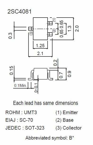

What's the DC voltage on the three terminals of Q3?

Q1, Q2 Voltages
Q1:
1) 4.8
2) 4.8
3) 4.4
Q2:
1)4.8
2) 5.3
3) 12

The emitters of eaach of those should be at 0v. It appears that you have an open/bad ground. Are W114 and W122 marked on the board? Both are jumper wires on the top of the board.
If so, what is the DC voltage on them?

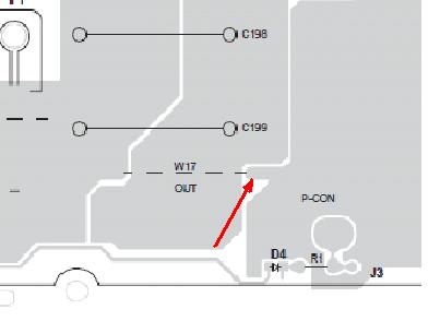

After doing some more inspection, I've found a problem. There is either a broken trace or missing component at one end of W17. I have marked it's location with an arrow in the attached pic. It looks to me like something was there, but, I couldn't find anything on the schematics.
Sorry my inexperience is showing through.
After checking and re-checking the schematics, I concluded that it was only a broken trace. I re-flowed the trace and like magic....the amp powered on. I'll have to do some final testing later, but, I think we got it going.
