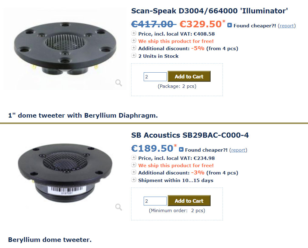

Some says the SB Be are not at the level of the SS Be !
Well, you also have to consider the difference in price.
