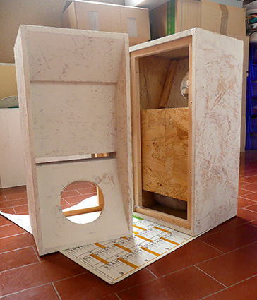

Hi

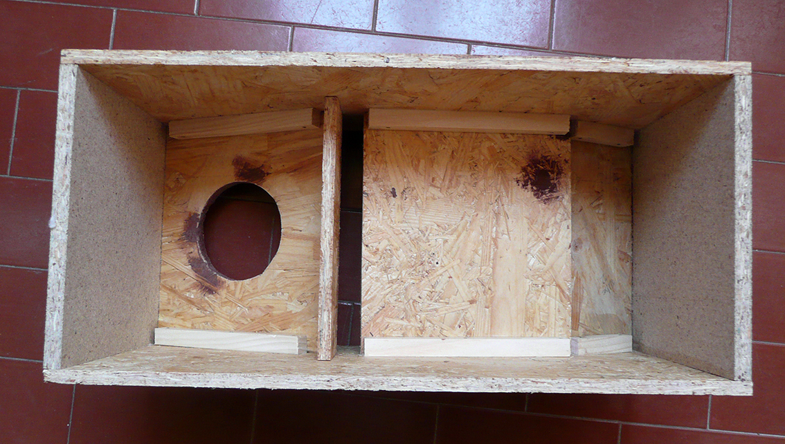

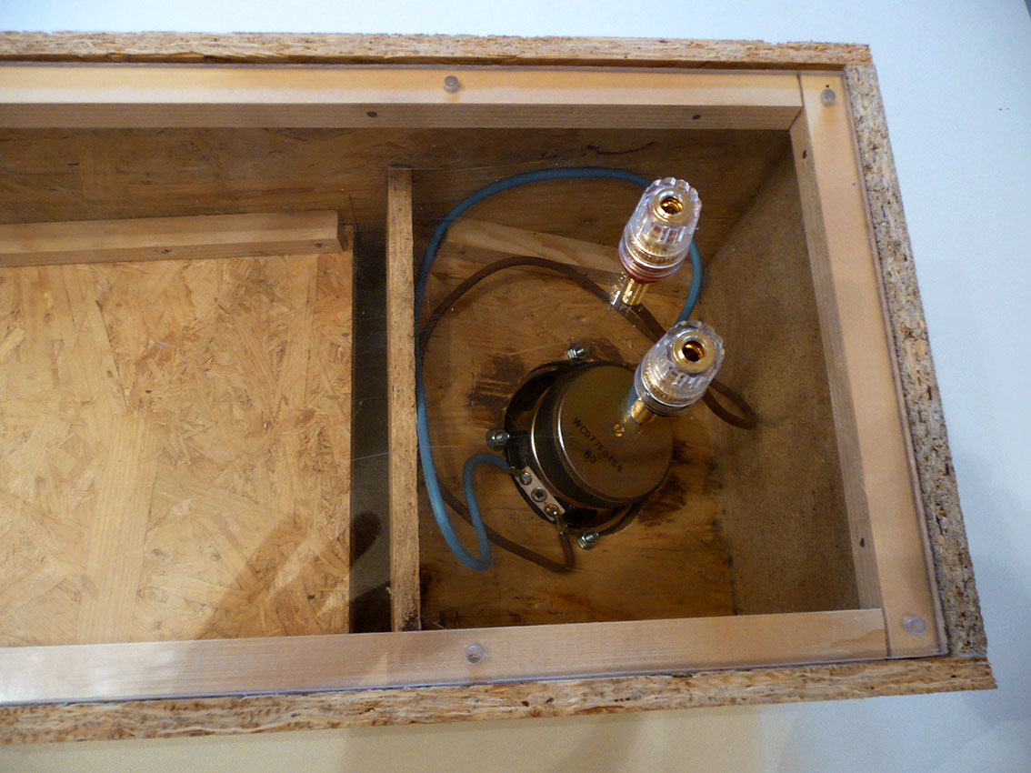

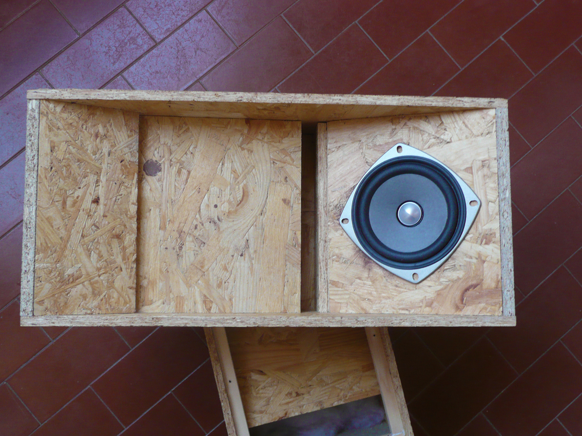

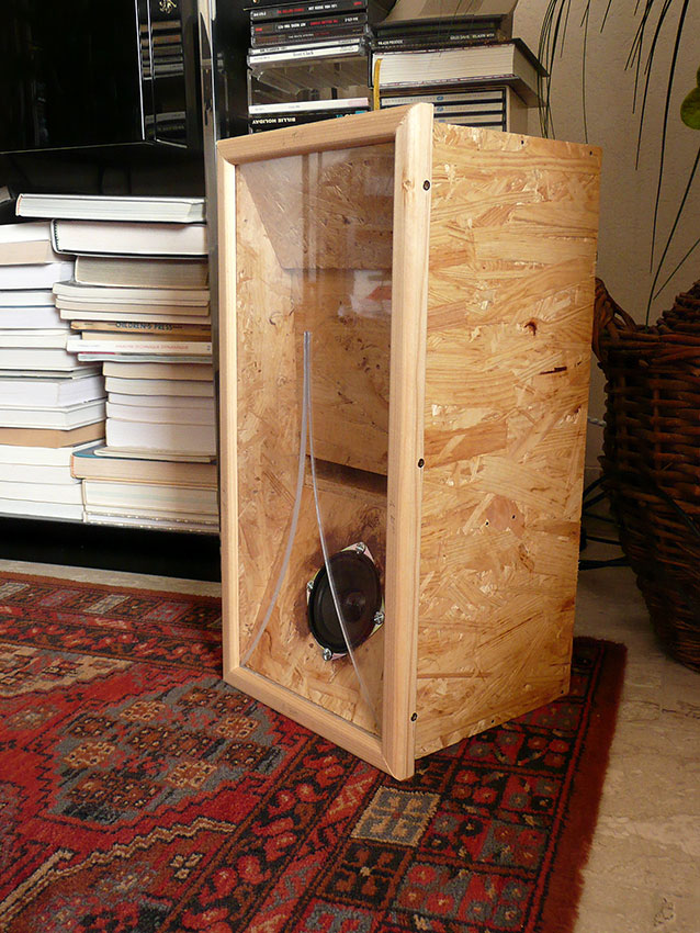

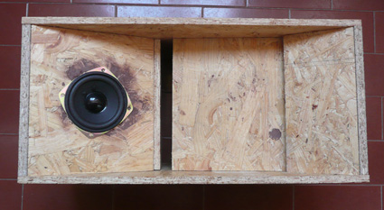

Some years ago, I posted my built of a XK-4 on a dedicated Karlson site.
Since then, these have been working like charms and give a lot of pleasure to listen to so I think it could be a good idea to post here.
XK-4 is a rather small enclosure but deliver great sound, small enough to placed a bit anywhere in a flat.
An ACA amp is plenty to feed them and with a Shiit Sys preamp, you have a solid system for your bucks, just chose your source.
In fact at first I didn't know anything about K's speakers and didn't want to spend much on trial.
So I recover 9mm OBS from a transport pallet and small Bouyer's speakers and built the box.
The result being promising, I bought two Fostex FF105WK and adapted the holes to fix them.
Then I started listening and ajusted the vent with cardboard sliders to get the final opening. I listen to a long while and compare them with Rogers LS3/5 to avoid bumps somewhere in the range.
It come out they were better than the Rogers in that they get much lower, they are a lot more sensitive and far less critical for the listener position.
The picture is also wider.

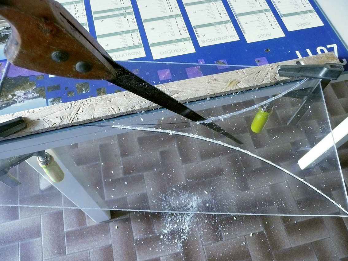

At that point, I was a bit pissed off of having using junk material to built !
So I decided to make them pleasing looking but add more difficult material like plexi front & back!
Finally there is no absorbant material at all, no filter, just the box and the Fostex and I am a happy listener.

Nice looking speaker! Interesting that no damping was needed. Probably not having any parallel walls near driver helps with this regard. Usually adding a small puff of polyfill in section behind driver helps tighten up the sound but if you find it is good as is, that’s great.
I just noticed a close similarity of this (post #8) very tall stuffed hybrid design (and with great results) to my 17-foot sub. See post 20:K15 is alright...
Long pipe to sequester rear wave
B.
Sides are parallel, top and bottom as well, I have tried stuffing behind the driver with polyfill, it made no improvement to my ears at least, so I took it off.
