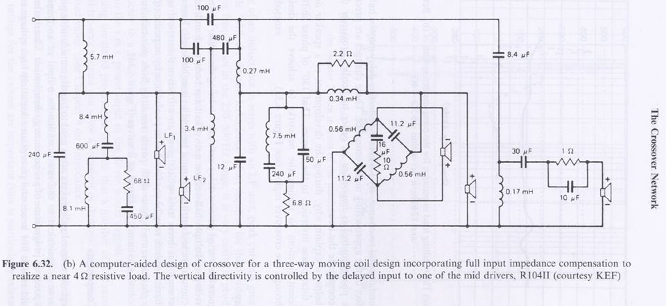

I just bought a used set and the original tweeters had been changed out to the Morel MDT29 4 ohm tweeters. This seems to be a common replacement but I was hoping to find something better. The Morels sound "forward" if that is the correct term. I am trying Kef T33 SP1197 at the moment. They us a smaller magnet so a thin spacer behind them is required to mount them. They sound more neutral than the Morels but I'm going to have to listen to them for awhile before I know if I'm going to stick with them. Has anybody found a better match for 104/2's.

The Morel MDT29 4 ohm is a suitable replacement by all accounts:
https://www.youtube.com/watch?v=YlZuaTBnzLQ
The Morel has a removeable front faceplate that makes this doable, but as you say, the spacing needs some bodging.
Nevertheless some sensitivity adjustment is often needed. You could either put an ohm or more in front of the tweeter filter to take the Morel down at the top end, or fit about 1 ohm/10ohm attenuator to generally reduce output if it sounds forward. We are talking a couple of dB here. I've used this tweeter in 8 ohm version so I know what it sounds like. Taking out the 10uF in the tweeter filter out would reduce the very top output a bit too.
Getting tweeter level right is one of the more critical adjustments. Often a single dB will make or break. Soft domes are soft domes IMO. They all sound much the same. I see a reasonable stab at one of KEF's 4 ohm filter below. Not sure how the Martin Colloms quoted R104II schematic relates to your model, but the 3rd order tweeter filter is as expected for 4 ohms.
The sp1191 is the original and the sp1197 has a smaller magnet. I might try to adjust the level of the morel down a couple db.
I don't know how well I can describe this, but you could listen to the Morel 30 degrees off axis, and if it then sounds reasonable, that suggests it's the very top around 10kHz that needs taming. A zobel around 6 ohms and 2uF might do that as an alternative to taking out the 10uf. You could even remove the 10uf and add the zobel for a serious impact on the very top end without mucking up impedance.
Impedance Equalization (L-Pad) Circuit Designer / Calculator
If it's still forward around 3kHz, the whole thing needs attenuating. Presumably the T33 SP1197 is just quieter than the SP1191. But it would be worth measuring its DC resistance.

I tried using the morel in one speaker and the Kef sp1197 in the other and did some listening tests. I'm going to remove the morel and install the other sp1197. The morel just doesn't match as good as the sp1197 to the midrange units. I have them about 2' from the back wall and about 6' from the side walls. The room is about 16' X 20'. I've tried two different amps with the same results. A Yamaha A-1020 and a Dynaco st-70.
I found a direct replacement at Midwest Speaker Repair. https://www.midwestspeakerrepair.com/mw-audio-mt-1191-1-inch-dome-tweeter-for-kef-104-2-speaker. No modifications needed and it sounds great. I listened to two 24-bit 92 mHz remixes buy Steven Wilson and the clarity, definition and presence is awesome. I never appreciated my KEF's so much. KEF wanted $150 each for a replacement and I has to ship them back the entire speaker section. These were $45 each.
I do not have the equipment to measure curves and even if I did I did not have any working tweeters to compare against. I acknowledge that my assessment is purely subjective. Since I did not have any T33 speakers that were repairable, these replacement speakers were my best option and I am quite pleased.
What are you trying to debug? Everywhere I've read folks are looking for a replacement 4 ohm speaker for the 30-year old T33. Here is an option. Maybe someone can measure the curve, but to me that is irrelevant. The speaker is a direct replacement with no physical mods and sounds great. I'm not a high end audiophile, but I'm am a happy listener again.
