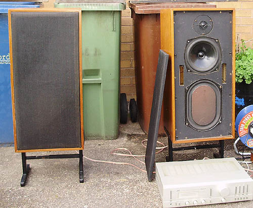

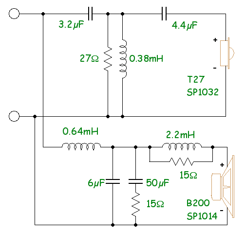

There are many, many Kef B200s in the UK and elsewhere. Mostly SP1014. Both used driver units and 2-way speakers from Kef, Tangent, Monitor Audio etc. All going pretty cheap. Crossovers on these models were always between 3K and 3.5K, which was the style at the time. But several posts have suggested crossing the B200 over lower, like 1.5K to 2K with a more modern tweeter, maybe in a waveguide. Here's the data below, so what do you think?

Why not? You have to equalize the mountain between 500Hz en 2 kHz anyway, which may lead to a somewhat more complex LCR contraption than the original DN 13 (?) lowpass.
X/o frequency depends on the tweeter, but any half decent Peerless, SB or Dayton 25-28 mm dome with an Fo of say 700-800 Hz could be used at 1800-2000 Hz with an acoustic Linkwitz-Riley 4e order.

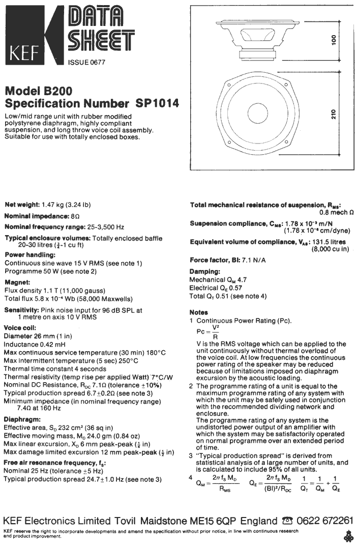

I have only the basic information on the B200 I'm afraid. If we can work out a 1.8 - 2K crossover we'll make many Kef fans happy! And they can start modifying all their old Kef speakers with lower crossover points and tweeters that go low. Most of the originals had 19mm tweeters like the T27.
I have a pair of SP1014 but they are unmounted and I don't have any measuring equipment. Some more data attached

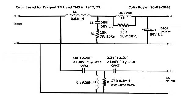

The most memorable implementation was the IMF TLS50 (you could use a good 3” FR as a midTweeter to emulate that XO point). Next the Tangent TM-1. KEF never seemed to get it quite right.

What is needed:
1) In-box measurements of B200: near field until 200Hz and than farfield from 200 Hz upward, combined/merged in 1 full range file plus B200 in-box impedance measurement.
2) idem tweeter, but then without the nearfield measurement
3) a measurement file with both drivers in-box parallel and unfiltered, in order to establish their respective acoustic centres.
What is needed:

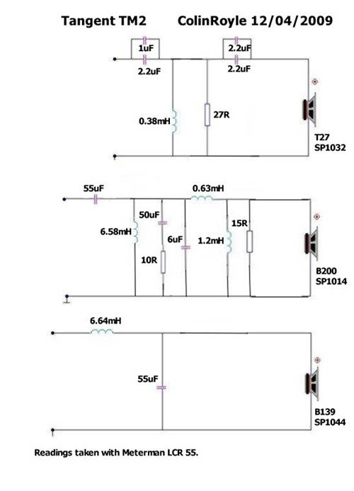

Tangent TM1,2,3
TM-2? We were likely the largest Tangent dealer in Canada, likely North America. Never saw or heard of the TM-2.

The TM-3 XO drawing is my work.

Isn't that picture the 3-way Tangent TM-2? Not a 2-way but it has the B200 crossed over to the T27
