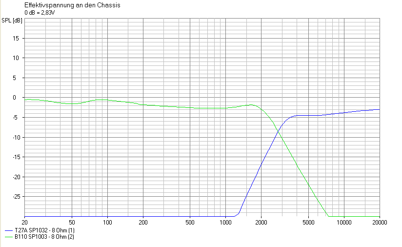

Fig.: KEF CRESTA 10 xover electric
R1=3R0
C2=6uF
C3=6.8uF
L3=0.21mF/0.50R
A.
L1=1.15mF/0.55R, L2=0.20mF/0.30R, C1=10uF, R2=1R5,
R1=3R3
C2=6uF
C3=6.8uF
L3=0.21mF/0.50R
The curve does not have much difference.
