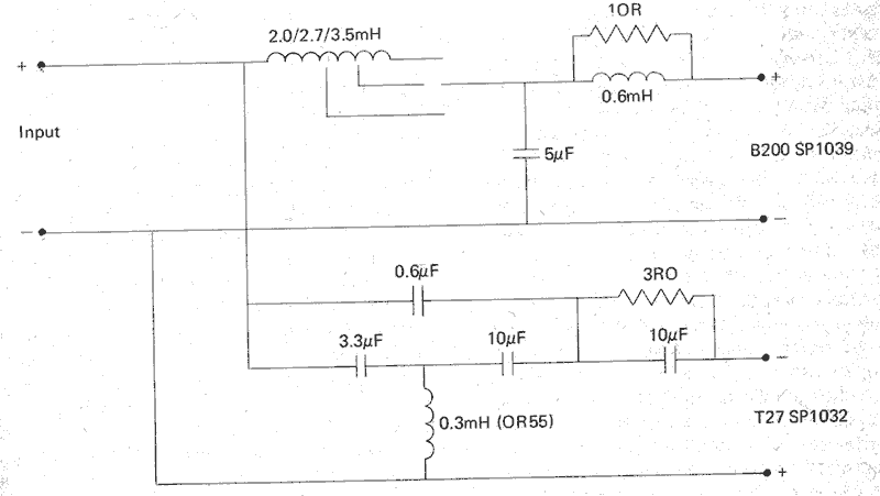

Is the crossover assembled, or do you need the schematic also? If you can't get the crossover diagram, you could list the parts here and someone could work it out. Given the age of the kit there would only be a few parts, anyway.

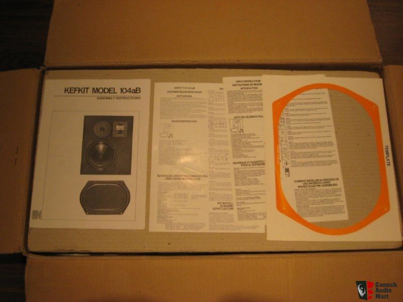

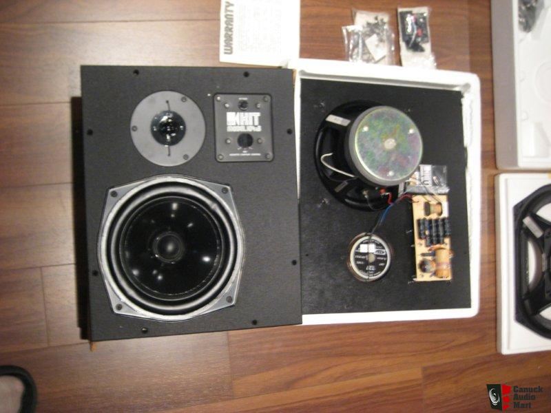

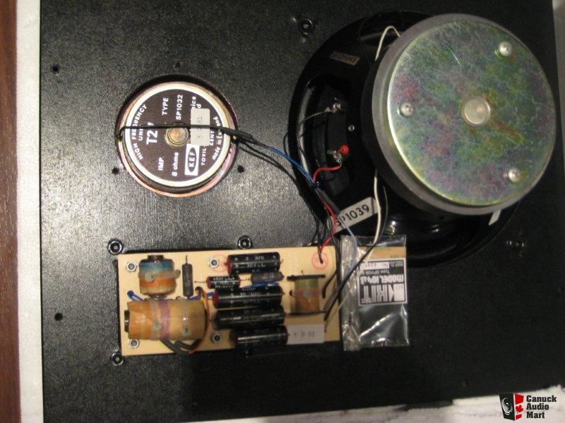

For the record - here's a good image of the pre-prepared mid/tweeter baffle and pre-prepared crossover board that come in the kit.
More images here: Kef Kit 104ab, Brand New in Original Packaging Photo #565754 - Canuck Audio Mart

They should be replaced with modern bipolar (non-polar) electrolytic capacitors as a matter of course.
I have, and would replace with poly caps.

I did the same, Falcon Acoustics used to stock all the odd values (.6uf , 3.3, 5uf) in ClarityCap ESA. They only offer them in Solen caps now.
Alternatively they do offer new electrolytics KEF 104aB REPLACEMENT CAPACITOR SET

Cool, Wieslaw. A scan i did (you can see my values placed on the XO diagram), from an official documant straight from KEF (late ‘70s), part of a big blue binder of really interesting stuff and a live set of 104ab.
