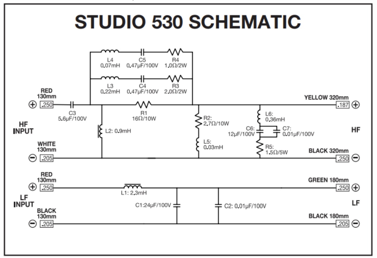

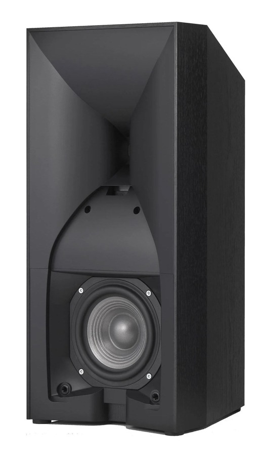

I have an easy project. Take a JBL530. Place it on top of a tall box with 4 or even 8 side firing woofers. Cross over around 250Hz.
Rework the crossover or make the bass only handle below 100Hz like a sub.

JBL 530’s are very nice. A steal at $220/pair.x- are these any good?
I have a thread on them here.
I was thinking of modifying them to be synergy like but you know what, they sound pretty darn good stock - with 5ohms extra padding on tweeter. Easy since bi-ampable with dual binding posts standard.
That waveguide is very nice. The crossover is quite complicated and I am surprised they went to such great lengths for a budget speaker. It had like 18 components! (Which sort of means the drivers were not the most well behaved?)
The crossover alone seems to indicate that this was meant to be a true studio monitor in the $600+ range.
