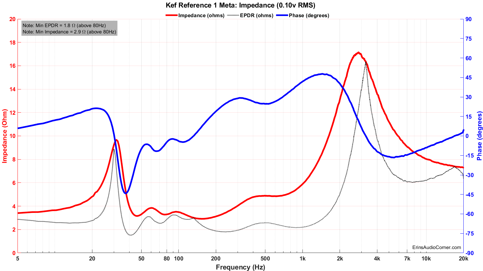

I have a puzzle and I don't have the money and funds to track it down so was hoping others could chime in. It's not even a piece of gear I own, it's just ... a puzzle.
A while ago a user on Audiogon was complaining about how poor his Kef Reference 1's sounded in the bass. TL;DR: These are 2 Ohm speakers with peculiar impedance curves. At Audio Science Review Erin's Audio posted a great and detailed series of measurements, including this impedance plot. Mind you, this IS a ported speaker:
So where is our double impedance hump? Is there an impedance compensation circuit misbehaving here? Poor high pass filter design? A missing shunt resistor value?
I'm wondering if anyone here has an explanation or can lay their hands on one of them to measure the impedance of the two sections independently?
