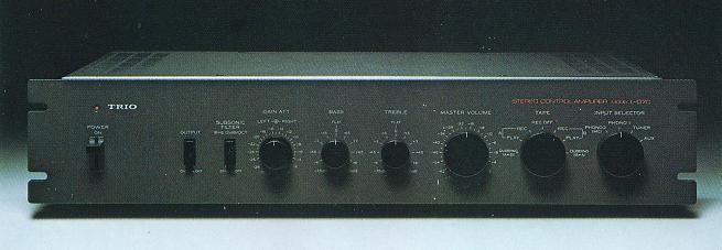

I have a Kenwood L-07 CII with a problem on the right input phono MC stage ( noisy with cracking... ).
But without diagram impossible to repair.
And also impossible to find service manual, schematic, information about, ...
Please I need your help !

Hi and wellcome to forum dray177,
I've just being given a schematic for L-07C model, so you can send me a pm via forum with your private email so I can send.

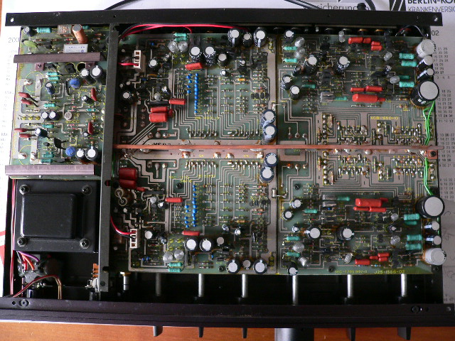

And still, I never found these faulty components in the right MC phonostage of my preamp !
In fact, would L-07CII be more difficult to repair than a Levinson ML-2 ???

No.
.....on the right input phono MC stage ( noisy with cracking... ) ???
At first you must perform a failure isolation.
If there are switches to select the input impedance and gain factor, remove it and solder wires to get the neseccary values (no longer non linear transition resistance there are)
Now check out and compare the behavior with
- open input
- short input and
- normal input connection to your moving coil cartridge.
What happens? Is sound to hear? Or only noisy with cracking (flicker noise, shot noise)? Then there is a complete break in the signal line.
Are there a reaction by a slightly mechanical strain to the j-FET's and BjT arround the MC head amp?
If yes, and there are no bad soldering in this aera, the internal bond wire of the transistor itself has temporary interruption or unwanted transition resistance.
What about the color of the MC head amp transistor pins (black or silver)?

NO !!! L-07CII a bit less complex than Levinson ML-2
Yesterday failure was solved.
In fact only ( I don't know which one ) a bad solder on the mother board ( a double-side one ) and the solution was to re-solder on the two faces all components on the MC stage.
But without your help, Aparatusonitus and Tefbassuebertr, I think I lost my footing !
Raymond.
