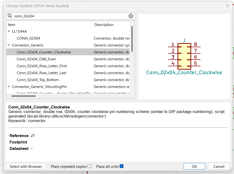

You should be able to make one, as a connector (which is what it is).
If you're not making a board, just use any existing connector with the right number of pins.

I would take a generic connector and modify the symbol. Start with a generic connector like the one shown below.

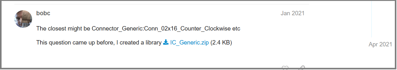

Thanks Kevinkr....I did see those.
I just found someone on the Kicad forum that made some....
Click for download:
https://forum.kicad.info/uploads/short-url/3DJGheoaZB23uJyJ1Ke6rmoyl1q.zip
