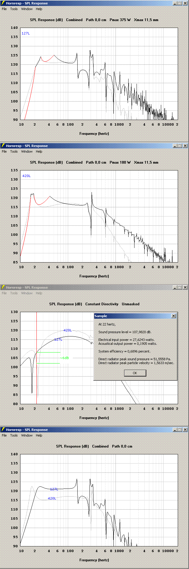

I'm surprised too,In case this is true the size of the box and ported system would be quite large...compare with this HR simulations:

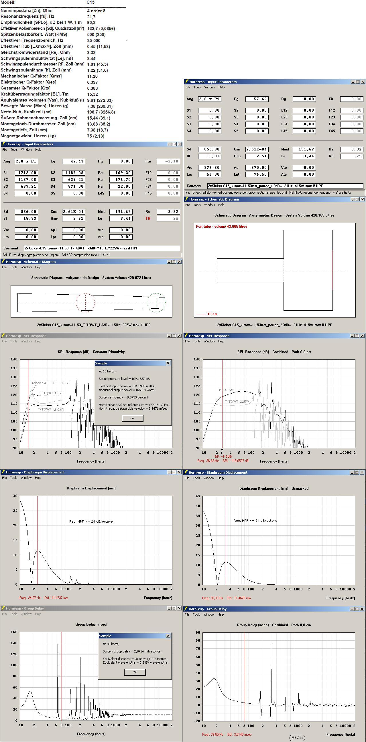

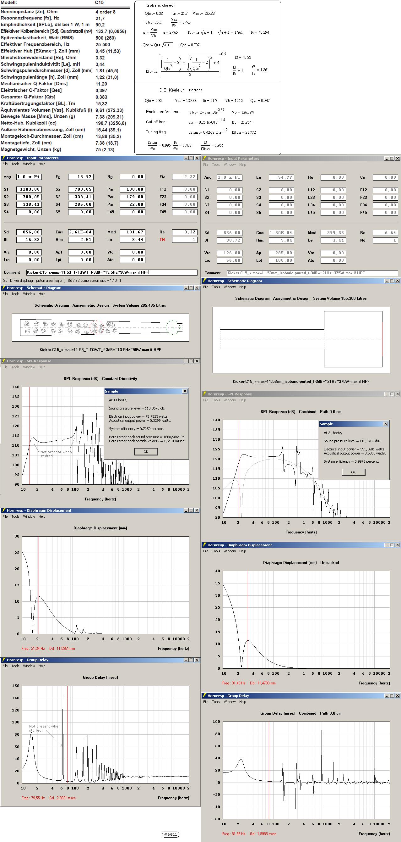

It's always possible to tune low at an expense of performance... See the submitted pictures.

I guess playing music with non whatsoever frequency contents below 22 Hz would be acceptably if the peak at the lower FR end is tamed using an EQ or HPF, but for HT use, I would use a > 24 dB/octave HPF at or above the driver fs.
