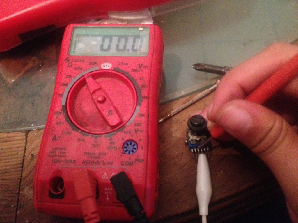

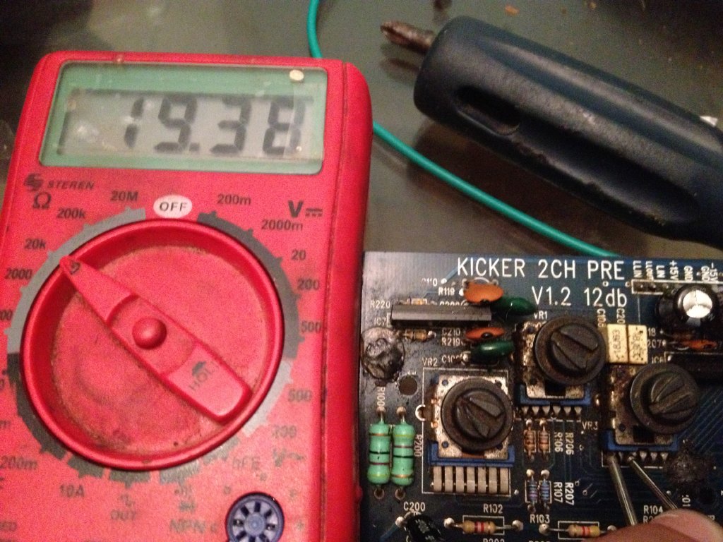

I'm not convinced.
I have a junk preamp board here and the pot had to be turned hard into both of the high and low stops for it to read as 0 ohms between the wiper and the high/low terminals. To get it to read a as 1/2 of it's rated resistance when it's centered (as it should) I had to push down hard on the knob. The pot looks and feels flawless but neither section is good.

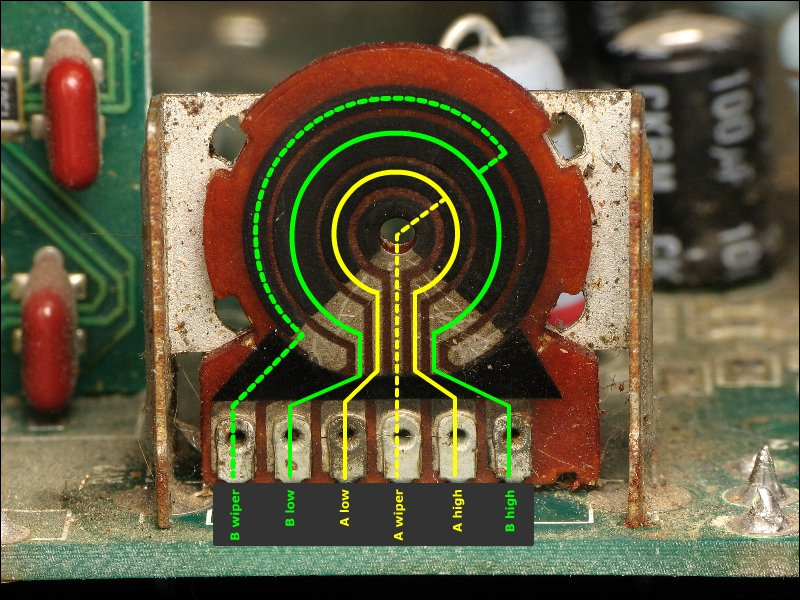

Using the attached diagram, confirm that you read 0 ohms between the wiper and the corresponding high/low terminals when the pot is in either extreme position. Then set the pot in the center position and confirm that you read approximately 9k ohms between the wiper and the corresponding high/low terminals. Do this without touching the knob or shaft of the pot.

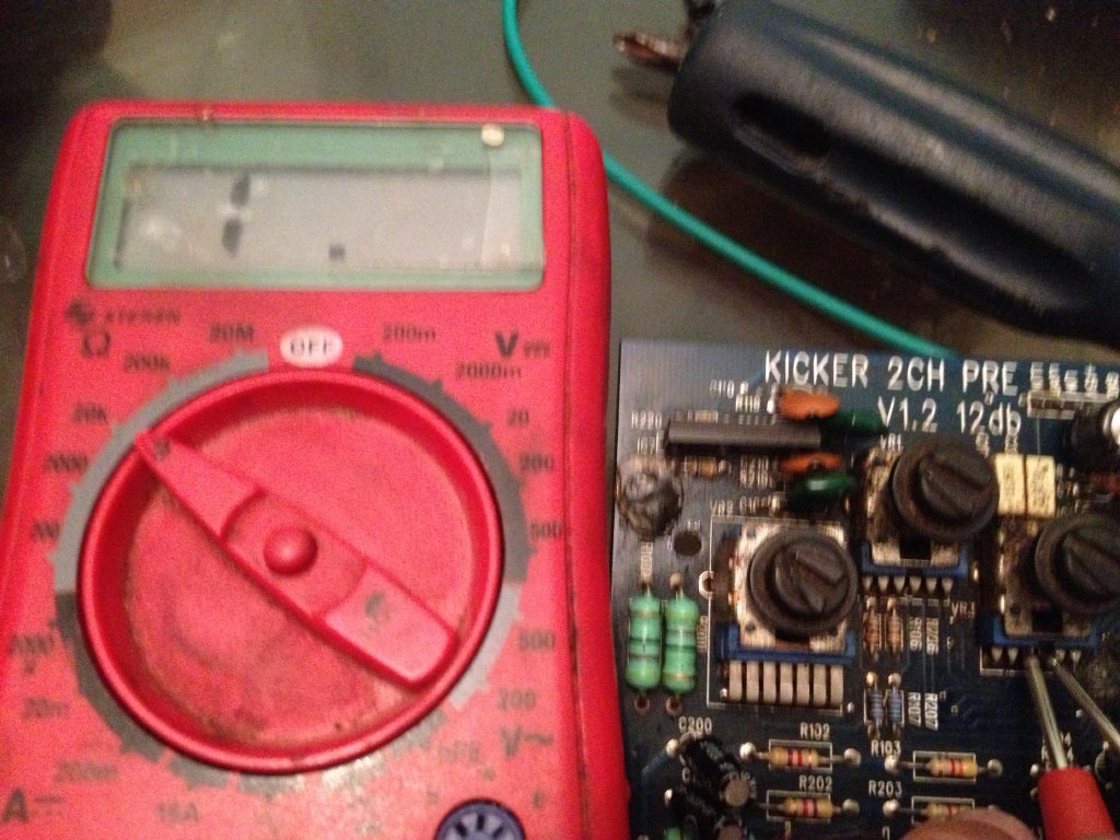

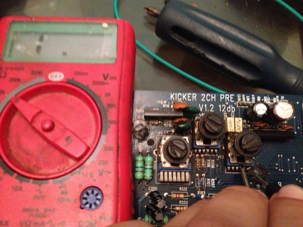

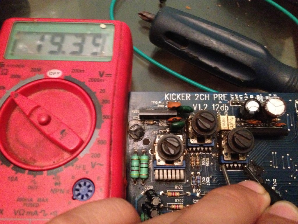

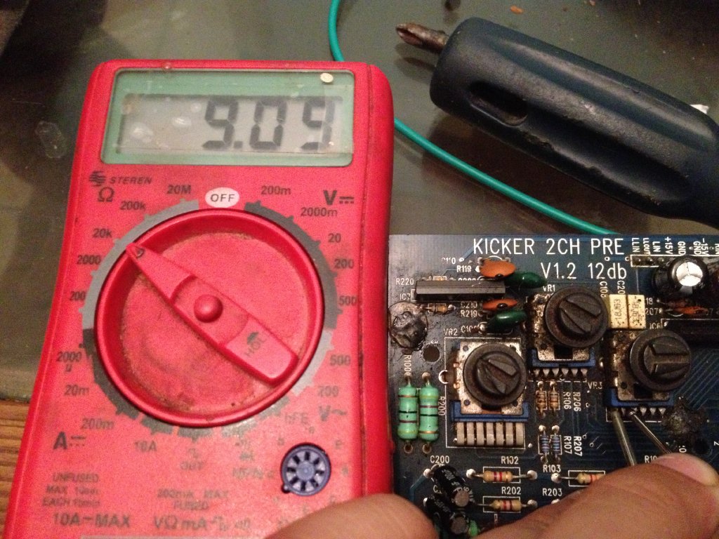

Im back with the testing results:

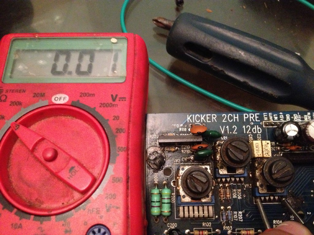

B WIPER / B Low = 0.01 ohms wide open
B WIPER / BHigh = 19.38 k ohms wide closed
B WIPER / Center shaft Position = 9.09 k ohms
All the previous readings are reversed when moving the pot. It looks like B WIPER operates correctly.
But A WIPER gave me infinite ohms (no reading) at A Low and A High, regardless of the pot position.
I think this is the culprit , right ? what would be a suitable replacement for this part ?

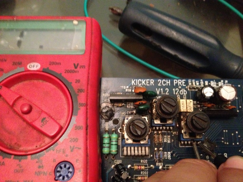

Here are some pictures of my tests ...(not all were included)
Thanks in advance.

Yep. it looks like its toast...or not ? it doesnt looks good....or what if i do a good cleaning ?

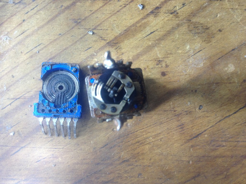

Removed and dissassembled the pot from the preamp board.
It says B20K, that is the name of the replacement , right ? or there are another suitable replacement ?
Thanks a bunch,
Thanks a bunch,

I did some cleaning of the pot, and the metal parts. Reassembled and tested , and i got readings at A WIPER, very similar to B WIPER. Checked if i had a smooth measurement and looked ok. I decided to reinstall at the preamp board and reassemble amplifier, and yep, it worked as normal. Both bass boost channels are now operating correctly. Even i got rid of a very faint sound at that faulty channel.
I will be looking for replacements anyway, i understand this is a temporary fix, but definitively this was the problem.
Thanks for all the responses. Thank you guys !!!
