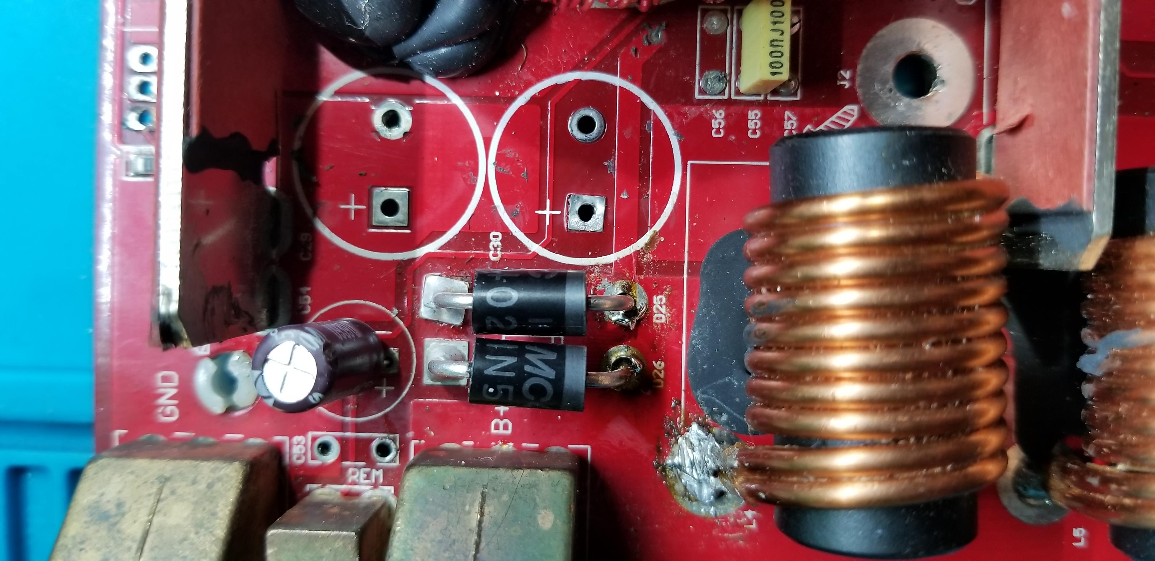

I have a zx1500.1 that burnt up all the power supply mosfets and shorted the output section. I can get it to just power up without any mosfets in the amp. I replaced both 5402 diodes. Same result.

ok will do, I have them all out of cuircuit with no outputs or power suppy mosfets and it just draws current, despite changing the shorted diode. I was told that B+ touched ground? Seems more likely it was run at avery low indepence load. The power supply is burnt badly. I worked on this amplifiers output section a few years ago.
The D25 and D26-1N5402 are across the power terminals-B+or Battery terminal to Ground terminal, which is there to protect against reverse polarity, but can be a casualty when there is an excessive load or improper fusing and under rated cable gauge. So, you may be right, shorting the B+ to ground should not have caused the diodes to short.

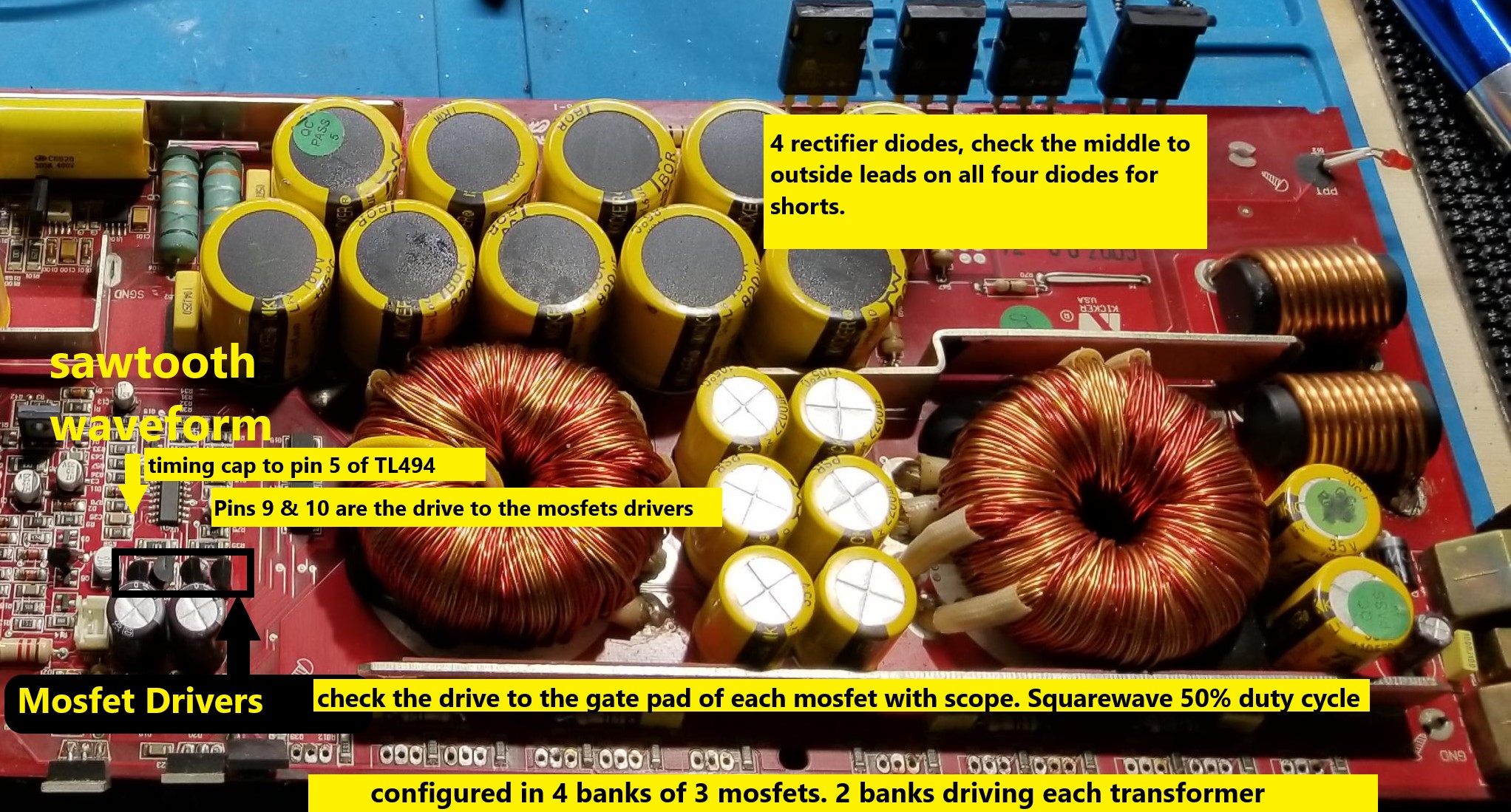

Using the edited pic check the sawtooth and drive waveforms and post screen shots of sawtooth, drives at Pins 9 & 10 of the TL494, one screenshot of each bank of the mosfet gate pads.
Also, Check the DC Voltages of the pins on the TL494, using power ground for the black probe of meter.
Check the rectifier diodes with an ohmmeter.

Ok this amp does not power up properly. It draws 8amps with no class d board and no mosfets at all. Rectifiers are ok. This amps power supply and outputs were shorted. +- voltages are not present. On the pads for the class d board nor the preamp board.
There are a number of things that may be causing an 8 amp draw.
Q12,Q13 shorted, check these mosfets first.
Check to be sure you have no solder bridges on the power supply mosfet pads and check the 1N5402's to be sure you have them installed properly.
Shorted windings on one of the power transformers(Twisting and turning the transformers may bear this out).
Shorted or leaky input capacitors(C29-36) or L4.L5 may have damaged cores or shorted windings.(If you don't see any obvious shorts and twisting and turning transformer doesn't change current draw pull inductors out one at a time. Check across the capacitor bank(C29-36) if shorted you will have to remove each cap one at a time.

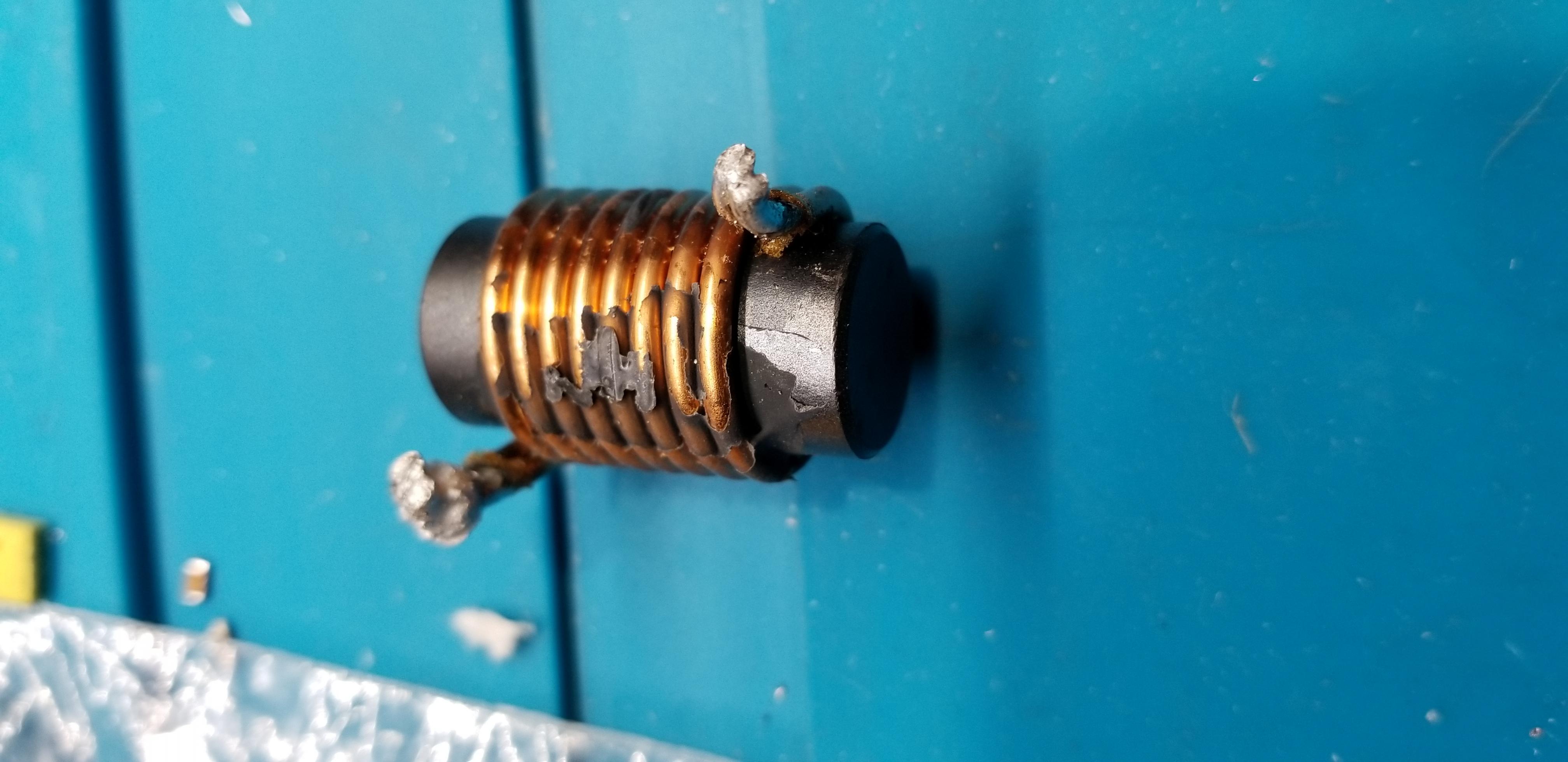

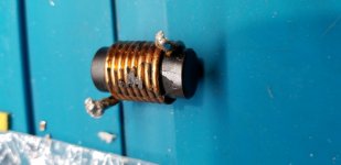

That was not a crack an optical illusion I took the ferrite out of both and they are ok. So I removed all the capacitors and the power supply torrids. The board now Powers up and the relay engadged. So it was something short,,all the capacitors tested fine. I do know that if I place one of these toriods back on the board, it draws 8amp of current.
