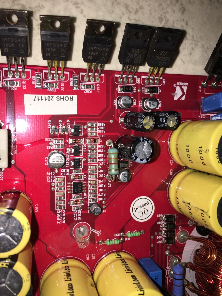

Opened it up now and started to measure resistors, then i came across r171 wich is a 3,3kohm resistor, but i only measure 2,2kohms. There are 4 other 3,3kohm resistors nearby that seems fine, but the colour is not the same as the one thats broken.. Is this a sign of high temps or is it supposed to be this way?
And, is it most likely the r171 resistor that is causing the amp to not work?:confused:

That resistor is part of the over-current protection circuit. It drops voltage to D111 (12v Zener). It's common for them to become darkened from heat. If it's out of tolerance, it needs to be replaced but isn't likely preventing the amp from working.
The click from the speaker when the relay engages is likely due to excessive DC on the output. The amp is shutting the output down to protect the speaker.
Check D111 to confirm that it's not shorted.

Post good quality photos of amp, one overall and another of the area around R171.

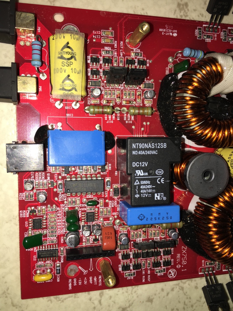

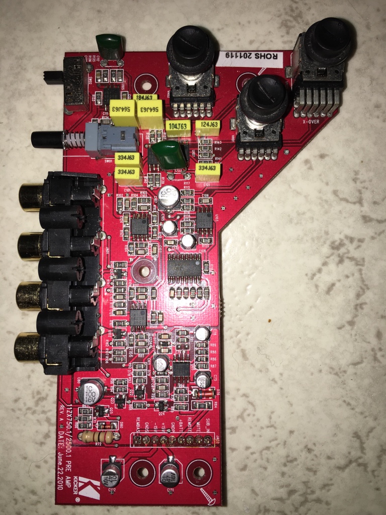

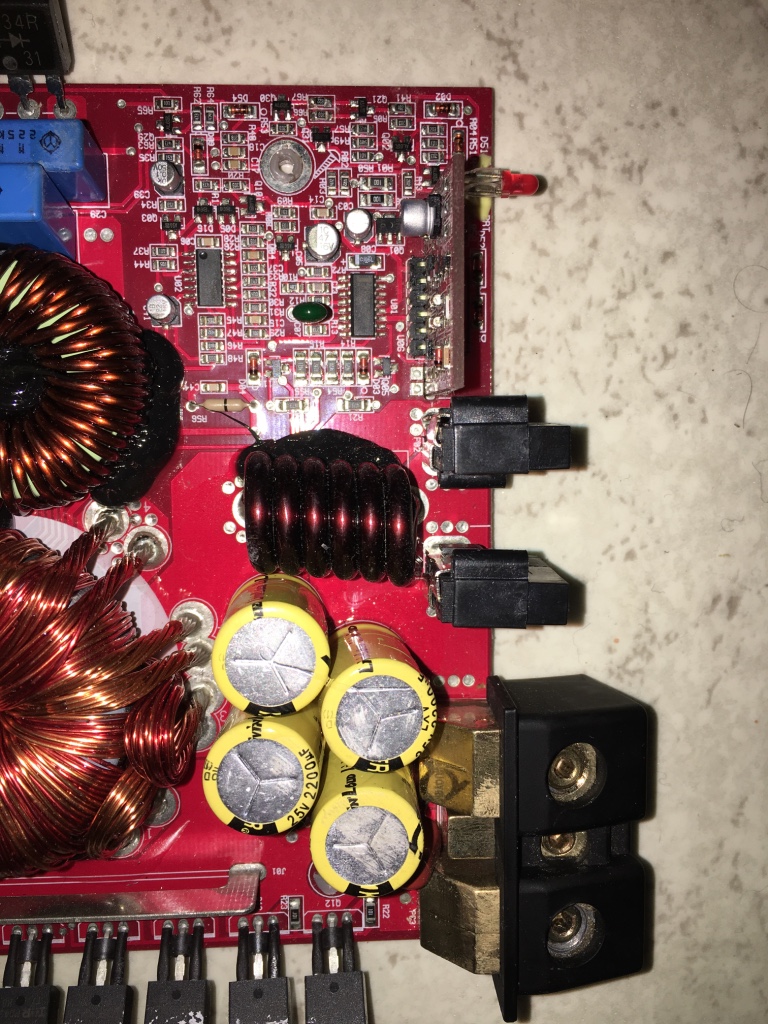

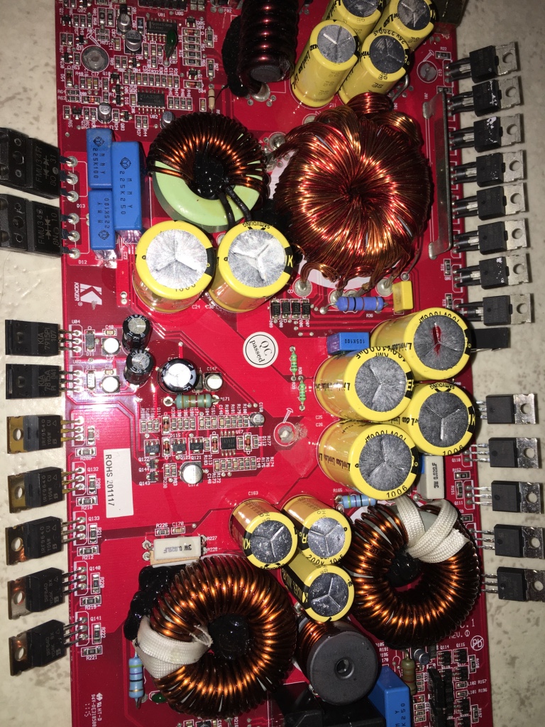

Here are some pictures.

If you haven’t already remove R171 and check with an ohmmeter, and then check the ohms at the location of R171.The 2.2 k ohm reading is most likely a result of a parallel connected component such as D111,U17 or C146,C147. This may be the reason for the abnormal indications your getting when you power up the amp.
Whenever you are removing components, make sure that all power cables are disconnected and it's recommended that you test amp with the board clamped down in the chassis.

IT looks like The d111 is shorted, is this the one causing the amp to cycle? If so where do i buy new one? Its a BZG03C12, found it on a website but there is 3 different types.
If you can locate a Vishay BZG03C12 you should be fine. You need a 12 volt zener with about a 3 watt rating and the right case, according to the datasheet is a DO-214AC that measures 5mm.Someone else maybe able to recommend an equivalent zener diode, if your not able to locate this one.
