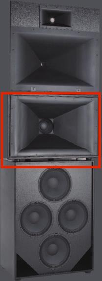

Here is a picture of the mid-bass module I refer to above (highlighted in red)... sometimes I need visuals to know what someone is talking about. I'm asking about taking the existing 8" driver out of the horn and replacing it with a coaxial one in order to cover everything down to the crossover to a sub. Sort of a MEH treatment without having to cut holes in an expensive horn. Of course I have full expectations that Murphy's law would kick in and that any 8" driver I choose to replace the existing one would not bolt directly onto the horn 😒
I'd rather do what @Cask05 did with a K-402 on the Klipsch forum but I don't have access to any of those... only the mid-bass units.

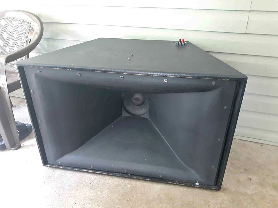

Actually, what you have posted is a KPT-XII, which has a much bigger throat than the K-402 horn.Here is a picture of the mid-bass module I refer to above (highlighted in red)...
The KPT-XII is not made anymore so if you're going to use these with a cone-type coaxial driver, you'll have to source a couple of old used XII horns if you can find them. The K-402 horn is the horn above the XII horn in your horn stack picture that's posted above.
The KPT-305 midbass module uses the same horn as the Jubilee--the K-402--which has a 2" diameter throat. If you're set on using the KPT-305, then I' recommend using a Celestion Axi2050 driver, which has good output on a K-402 horn down to 250 Hz--but it requires a DSP crossover to flatten the SPL response.

Hooking up a coaxial cone driver with compression driver to a midbass horn will not work very well as the tweeter horn area expansion has a massive discontinuity. This is formed by the end of the tweeter horn, the throat chamber of the midbass horn and the throat of the midbass horn. A better solution is to move the driver forwards so the throat of the horn meets the compression driver horn. Then the cone driver is fed into the horn via bandpass ports. This however does require some fabrication.
That was what I suspected. Out of curiosity, do you know how a driver such as the one I posted above (B&C 8CXN51 8" Professional Neodymium Coaxial Speaker 100 x 100 8 Ohm) is intended to be used?Hooking up a coaxial cone driver with compression driver to a midbass horn will not work very well as the tweeter horn area expansion has a massive discontinuity. This is formed by the end of the tweeter horn, the throat chamber of the midbass horn and the throat of the midbass horn. A better solution is to move the driver forwards so the throat of the horn meets the compression driver horn. Then the cone driver is fed into the horn via bandpass ports. This however does require some fabrication.
The K-402 horn is the one in the KPT-305 midbass module. I own one--and that's now the center K-402-MEH loudspeaker in my 5.2 setup.I think Klipsch has changed some things up since you last looked?
