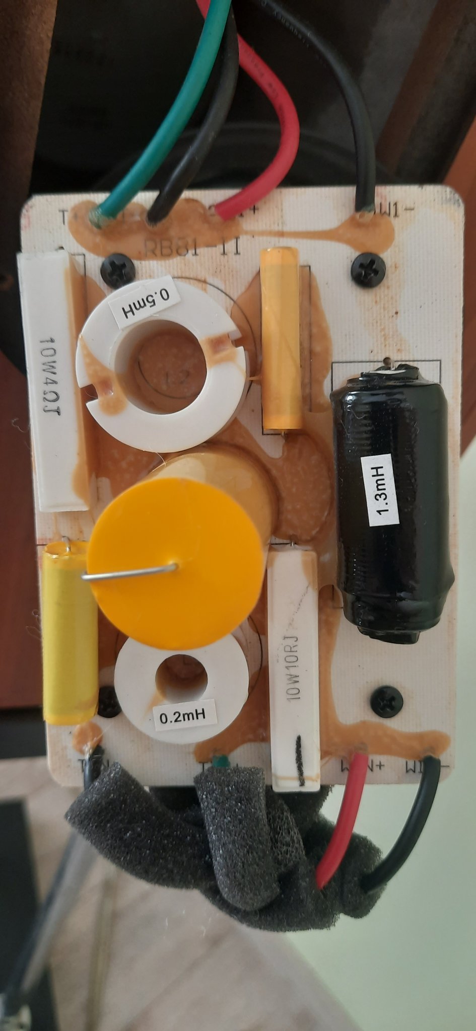

Dear, tell me if there will be an improvement in the sound if I replace the crossover components with these:
10w4ΩJ - Mills 4.5 Ohm 12W https://www.parts-express.com/Mills-4.5-Ohm-12W-Non-Inductive-Resistor-005-4.5?quantity=1
7.5 uf 100v - Dayton Audio DMPC-7.5 7.5uF 250V https://www.parts-express.com/Dayto...0V-Polypropylene-Capacitor-027-429?quantity=1
0.2mH - Dayton Audio 0.20mH https://www.parts-express.com/Dayto...AWG-Air-Core-Inductor-Coil-257-024?quantity=1
0.5mH - Dayton Audio 0.50mH https://www.parts-express.com/Dayto...AWG-Air-Core-Inductor-Coil-257-036?quantity=1
10w10RJ - Jantzen Audio 10.00 Ohm 10 Watt https://www.parts-express.com/Jantz...dio-Grade-Superes-Resistor-255-954?quantity=1
1.3mH - Jantzen Audio 1.3mH https://www.parts-express.com/Jantzen-1048-1.3mH-18-AWG-Air-Core-Inductor-255-256?quantity=1
3,3 uf 100v - Dayton Audio PMPC-3.3 3.3uF 250V https://www.parts-express.com/Dayto...-Precision-Audio-Capacitor-027-222?quantity=1
336j 100v - Dayton Audio DMPC-33 33uF 250V https://www.parts-express.com/Dayto...0V-Polypropylene-Capacitor-027-441?quantity=1
Is it worth making a replacement? Or is it better to choose something else?(preferably a link)

There will be a difference in the sound - perhaps for the better, perhaps for the worse. How will you tell, by ear or by measurement?
What do you perceive is wrong with the present crossover components that warrants you replacing them?

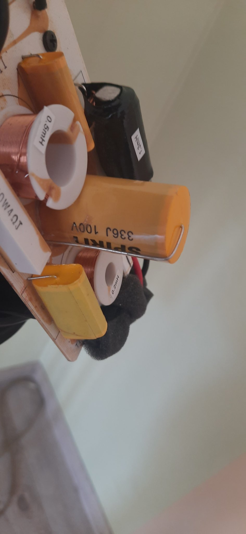

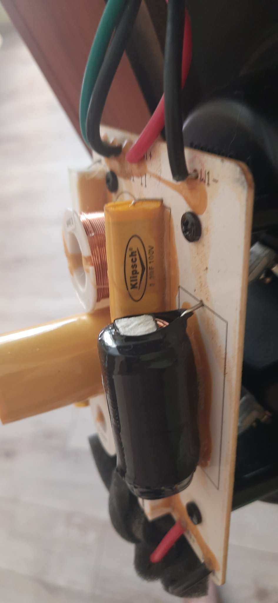

It would be helpful if you should post photos showing the existing components.
Do you have a crossover schematic that you can share?

Up to date nobody has been able to detect any difference between two resistors in a blind test.
High quality inductors can measurably decrease distortion compared to saturation-prone iron core ones, but without a very high performing drivers (read Purifi or TAD) this difference (of questionable audibility anyway) will be lost in driver's own distortion.
About the only somewhat reliable capacitor blind test I know found very little difference between ordinary, if high quality, PET capacitor and audio-grade PP capacitor.

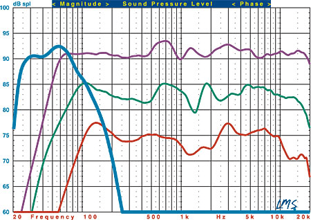

Klipsch RB 81 II themselves has no obvious flaws (see top trace) that can be easily fixed. They are thoroughly OK speakers. Their most distinctive featuare is the small horn which constrains treble radiation into appr. 90 degree angle, changing acoustic signature compared to typical cone-and-dome system. No XO fiddling is going to change that.

The opinions stated above indicate that there would be little to gain, if anything, by simply substituting the crossover components.
The components on the board are already of good quality and, to answer your question, I do not think it is "worth making a replacement".
