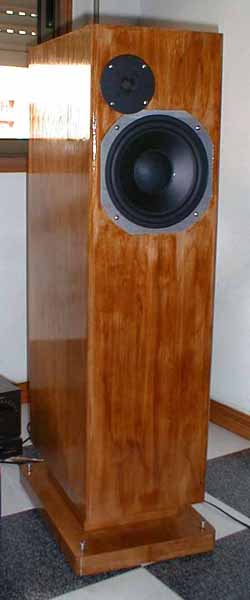

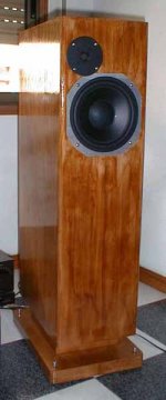

here are my KLS-9..original design from Noel Kenwood.The woofer is changed for a" Beyma 8 Woofer P" a polypropilene cone whith very good properties.. www.beyma.com the tweeter is an AudaxTWO25AO,a silk dome 3/4 inch. www.audax.com.
How it sounds?.A very detailed trebble,good soundstage,and deep bass...better sound than my old Polk-Audio monitor reference rta-11t.

Very nice finish on the box! Must have taken a lot of time...
The KLS9 is indeed a nice speaker, I've built two pairs myself (modified)....

The enclosure of the original design is 72 liter.
>bostarob
The dimensions: 100 cm high (whith stands),38cm deep,25cm across front panel.
19mm mdf on sides and rear,plus sandwich of 19mm mdf and 7mm plywood on front.Whith this solution you don´t need a router.
Dayton audio caps,Mills non inductive resistors,Monacor air core inductors.
Next proyect: Pro-Ac Response 2.5 clones made in granite!!!!.

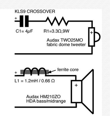

The designer was Noel Keywood, IIRC. Back in the day when Hi-Fi World offered kits.
Well behaved 8" polycone and 1" fabric tweeter. Some interesting port tuning options. I think a 6cm port, but anything between 4-12cms long. Middling at 6cm.
TUNING KLS-9
The crossover is the SEAS Njord / Monitor Audio R852 simplistic style. Not very exciting, TBH. 🙂
TUNING KLS-9
