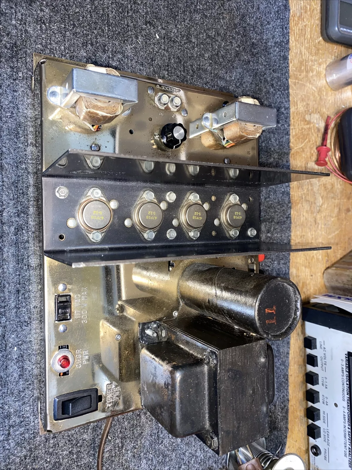

I lucked? into two vintage automotive 8-track players for $5 at a trash heap of a garage sale this summer. One was a Kraco in a classy brown wood grain vinyl wrap with chrome face, the other was a Muntz A30 4-track player, minimalist bare bones but in chrome as well. Old madman Muntz was fun to research, what a character he was, and since that one is a little more historic I'll tuck it away on the shelf of tomorrow and play with the Kraco. I despise 8-track, have ever since I was a kid in the 70's. You kick the damn cartridges around on the floorboard until packed with dirt, then jam one in the slot mid song and let it grind and gurgle along struggling to carry a straight tune. Them were the good 'ol days boy. Better than noisy AM radio or your cousin on the harmonica I suppose. Instant fodder for the trash can as soon as you could afford a cassette, like that was any better in a hot dirty car. I could not wait to rip the germanium amp out of that fine brown wood grain vinyl wrap, scrape out the 8-track guts like cleaning a fish, and see how it works. Maybe if it worked well I'll Frankenstein it into a different can to be a kick-about guinea pig test amp. Since it was basically free I did not have anything to lose and a lot to learn.
The amplifier was actually a surprisingly good but simple design from Japan. The layout of the amp was excellent and well thought out. The small isolated island of components in the foreground of the left photo is the transistor tape head pre-amp. This whole portion of the PCB was removed as it was no longer necessary. The tape head pre-amp output signal ran up front to the volume, balance and tone pots, then back to the power amplifier across the very back. The left and right silicon NPN transistor pre-driver circuits are at the farthest left and right ends, with the interstage transformers, output biasing networks, and speaker output capacitors as you move towards the center. The symmetrical and well separated layout with a good star-ground strategy was smart, helping to minimize oscillation since the overall gain has to be so high from tape head to speaker. The four totem-pole Sanyo 2SB474 PNP germanium transistors were mounted on the back plate with surprisingly long wire lengths used to connect them to the pre-driver PCB. Only two of the transistors needed a mica insulator, as for each channel one collector (case) was grounded to the chassis and the other collector tied to the output and floated at half the supply voltage (hopefully not shorted to ground by a tool during installation).

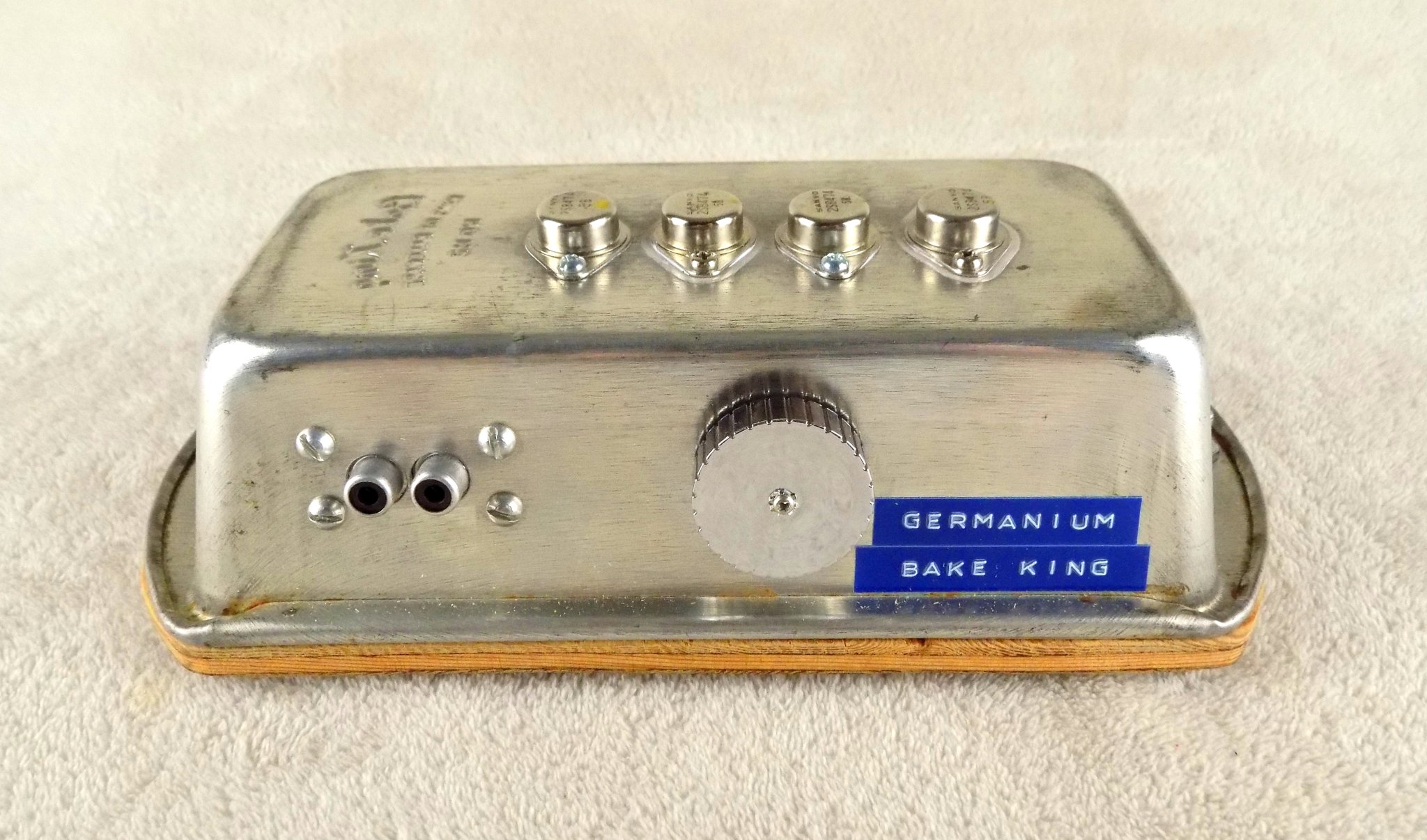

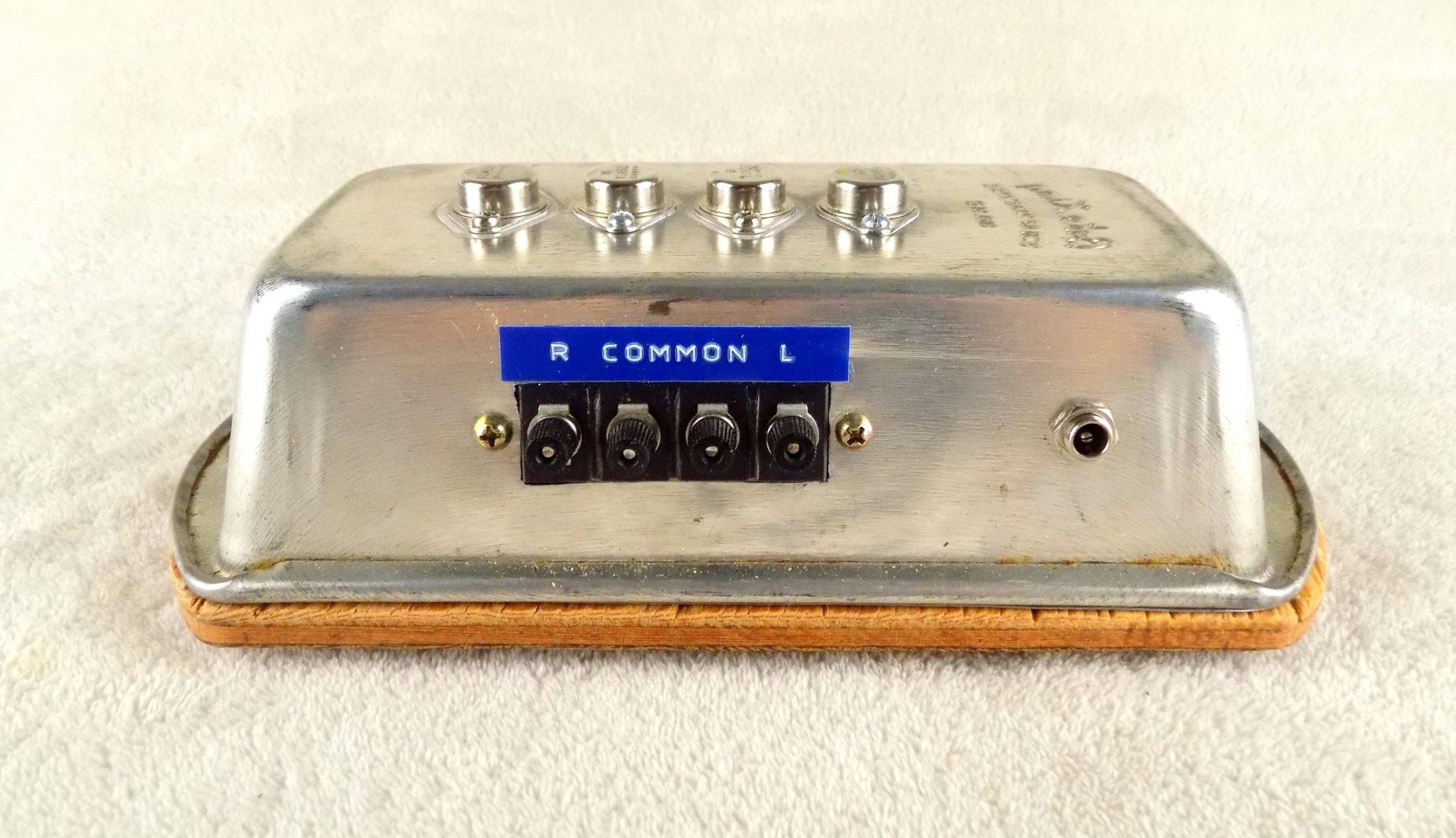

I didn't want to spend the money to buy a fancy aluminum box for this amplifier, so when I found a couple of tin plated steel bread pans (the small ones, like for zucchini bread) I could not resist. "Bake King - The King of Bakeware" was stamped into the bottom. The Bake King was born! I cut away the unused areas of the PCB (previously for the tape head pre-amp and the huge supply filter capacitor) and the PCB fit beautifully into the bottom of the pan. I used the hole pattern from the original back plate to mark and drill the transistor holes, and mounted the transistors sandwiching my sheet metal test plate underneath to give a little more thermal bulk. I used a Dremel tool to cut out the square hole for the speaker connector, which was an old AM/FM antenna connector block. The pot and chrome volume knob are from the Kraco, the input RCA terminals from an old console, and a chunk of scrap plywood. I tacked the PCB ground trace that ran around the outside edge to the inside of the pan with a soldering gun to hold it in place.
I power the amplifier with a switching 18V @ 1.5A wall wart, with an output plug that matches the power adapter jack from my scrap box. I have to say- it sounds pretty good, certainly better than it did as an 8-track player. The Kraco specs indicate it will drive 4W into 4 Ohms, and I have confirmed that with my 4 Ohm resistive load and pocket oscilloscope. Obviously it drives less into 8 Ohms, and sounds best under 2W. It's small, super easy to set up, and great for testing speakers, source components, or rigging up a test lead with alligator clips to test capacitors in series between the output and the speakers. It was a great exercise for learning about the care and feeding of germanium transistors, and I'm into it all of about $4 for the 8-track player and Bake King bread pan. Everything else came from scrap. Hope you enjoyed the journey with me, and remember, always "bake until golden brown".

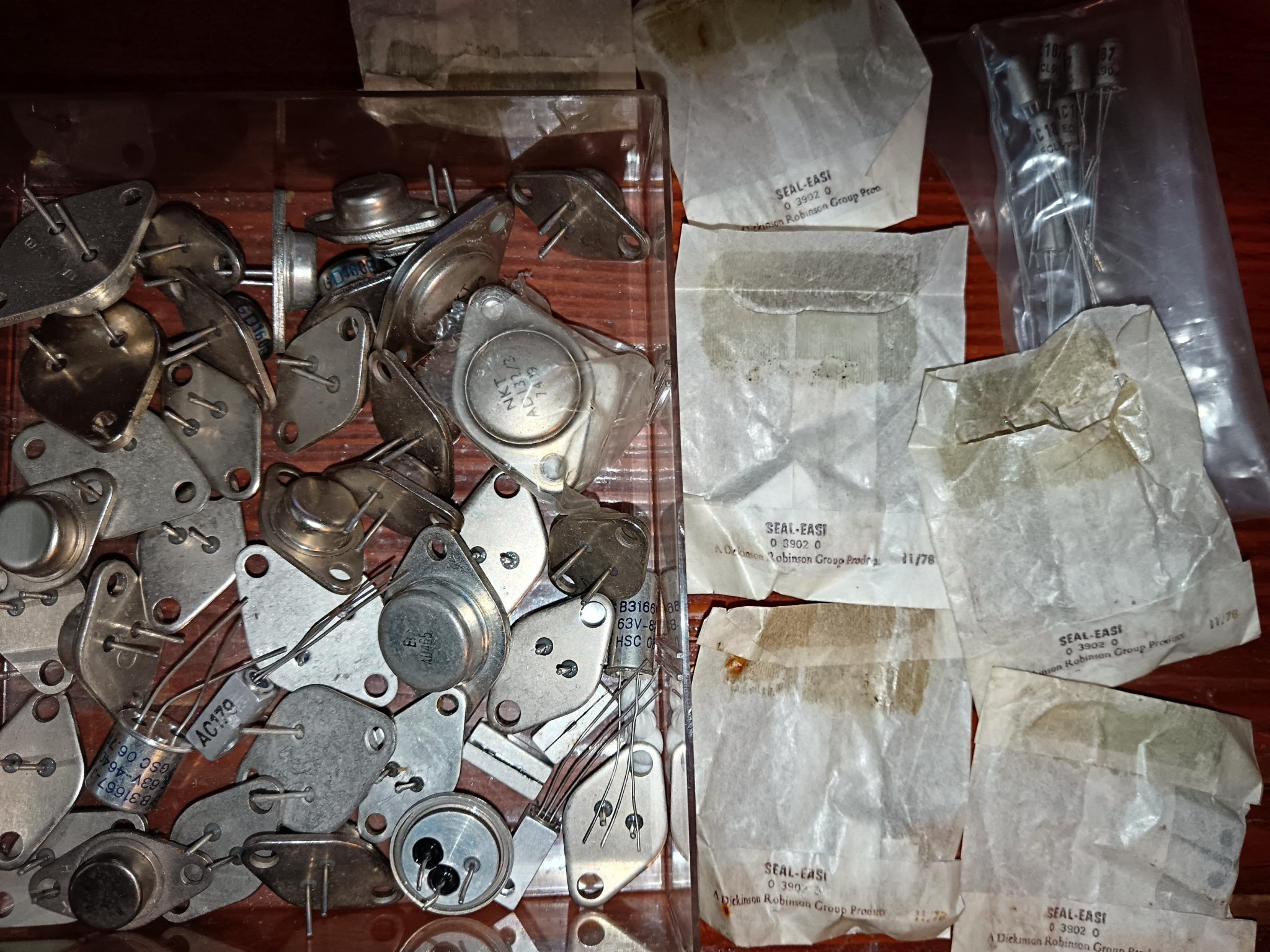

I have these in my drawer and actually don't know what to do with them. They are all new, some years ago I bought left overs from radio repair shop from guy that retired some years ago before that... Non of them is tested but also none was ever used.
Might be Ill regret it one day, but if you like them send me a message...

Please be aware of the possibility of tin wisker build up even in »new«, i.e. unused Ge devices over the decades.They are all new, some years ago I bought left overs from radio repair shop from guy that retired some years ago before that... Non of them is tested but also none was ever used.

Tin whiskers are easy to “clear”. Not always 100% successful, as collateral damage may occur. Run a couple hundred mA through it in reverse bias. That will open it right up. CLAMP the reverse bias down to 1.2V with a pair of silicon diodes. When the whisker does fuse open, the reverse bias on the junction goes to 1.2V, which is safe. If the fusing itself results in other internal damage, there is nothing you could have done about it so nothing is lost

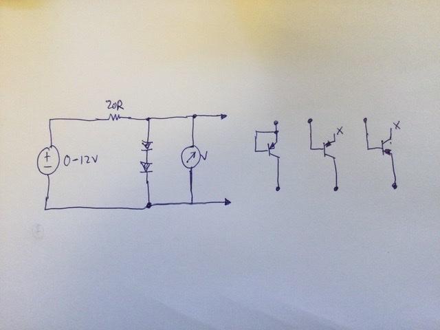

This sounds interesting- Could you post a simple hand-sketched schematic or something? This would make a great subject for a post if you can. It would be good to include a short section on how to determine if you are having this problem. Anything to save these disappearing treasures.
Turn up the supply till you see a solid 1.2 volts in all 3 modes. Do it gently, use only the current (energy) necessary to avoid splattering fused tin on the inside. Reverse the transistor for the rare NPN. It should then test normal instead of shorted.
Thank you very much for the illustration- I understand now. I'm guessing the whiskers cause the intermittent pops and grumbles in operation? Or perhaps short entirely? Fortunately I have not yet run into this situation, but as I play with more germanium I guess I will. Since you have used this method I again suggest it would make a great educational post. It would be very useful to some, and perhaps draw others into the conversation that can add their own experiences. Thank you again.
