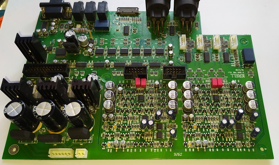

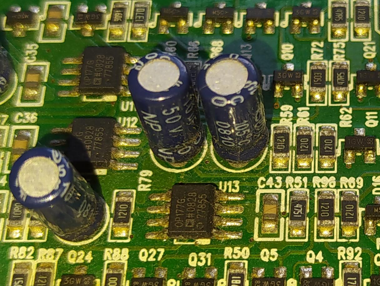

I decided to take my amp apart to clean it. Its really dusty inside. Bought it 2nd hand a few years ago.... Hmm.... Also wonder if some of the bits could be replaced, esp. the caps!! Its also over 10yrs old. Not sure if the caps are still within spec.

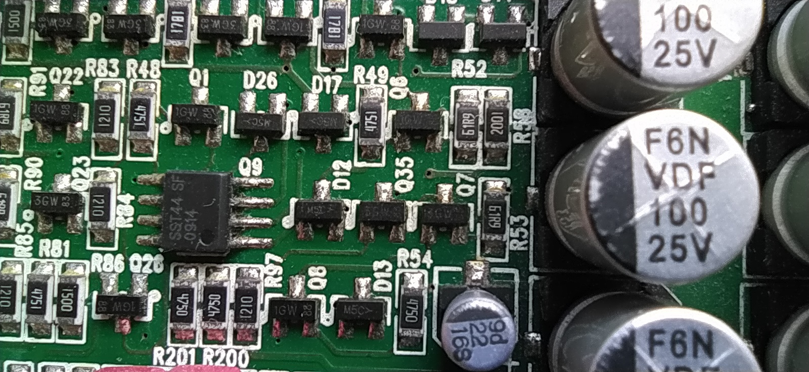

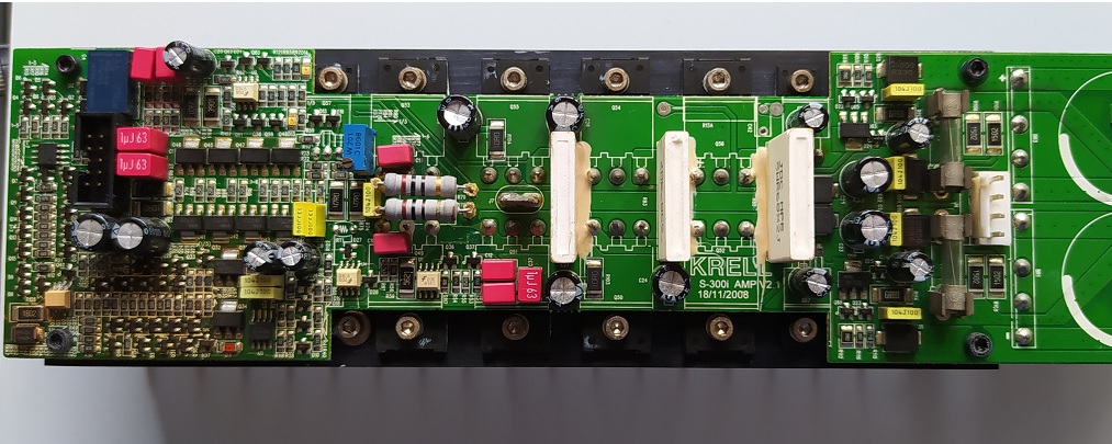

The preamp board is using 3 x OP177G. There is also 1 x SST44 (not sure what it is). The caps are mostly rscon. Btw, I just realise the power amp board has also 1 OP177G and another SST44 SF.

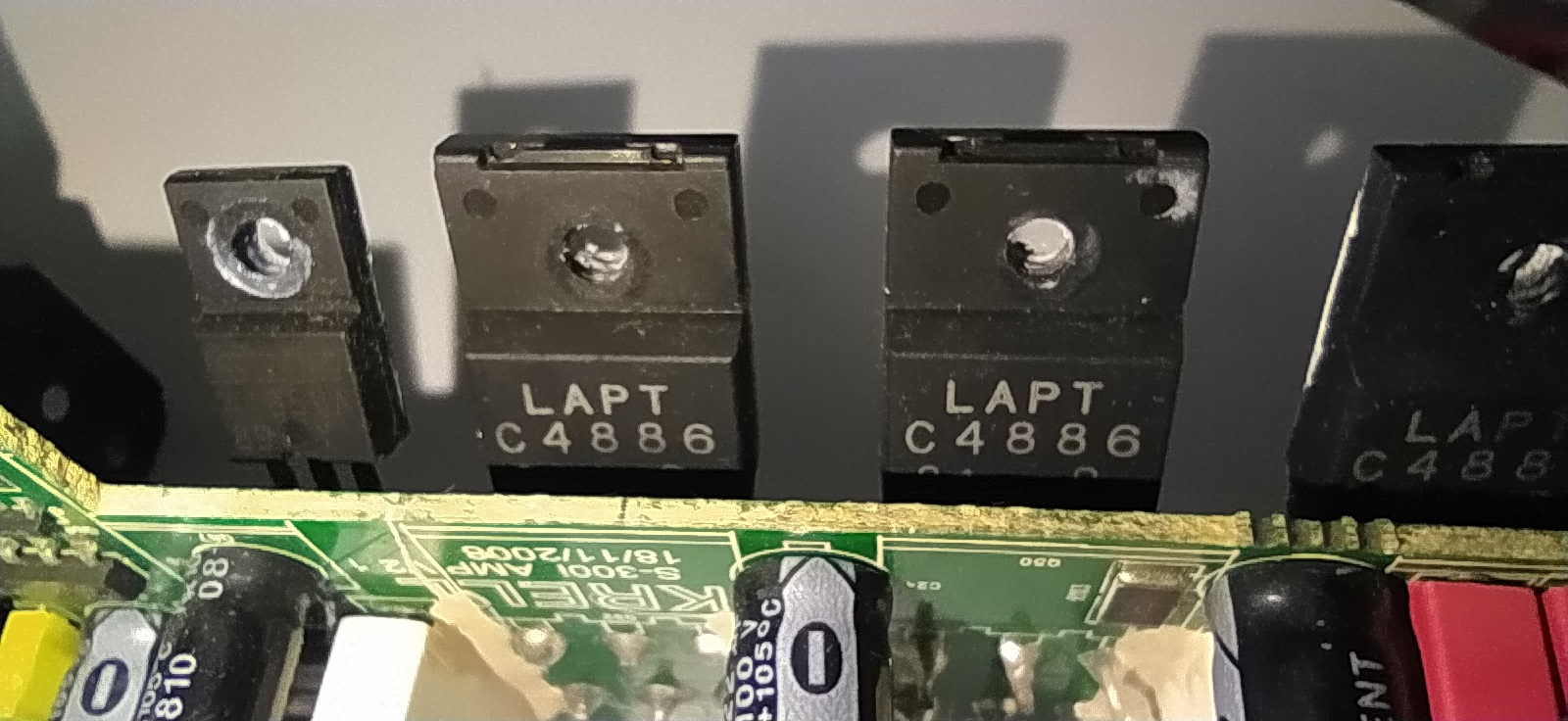

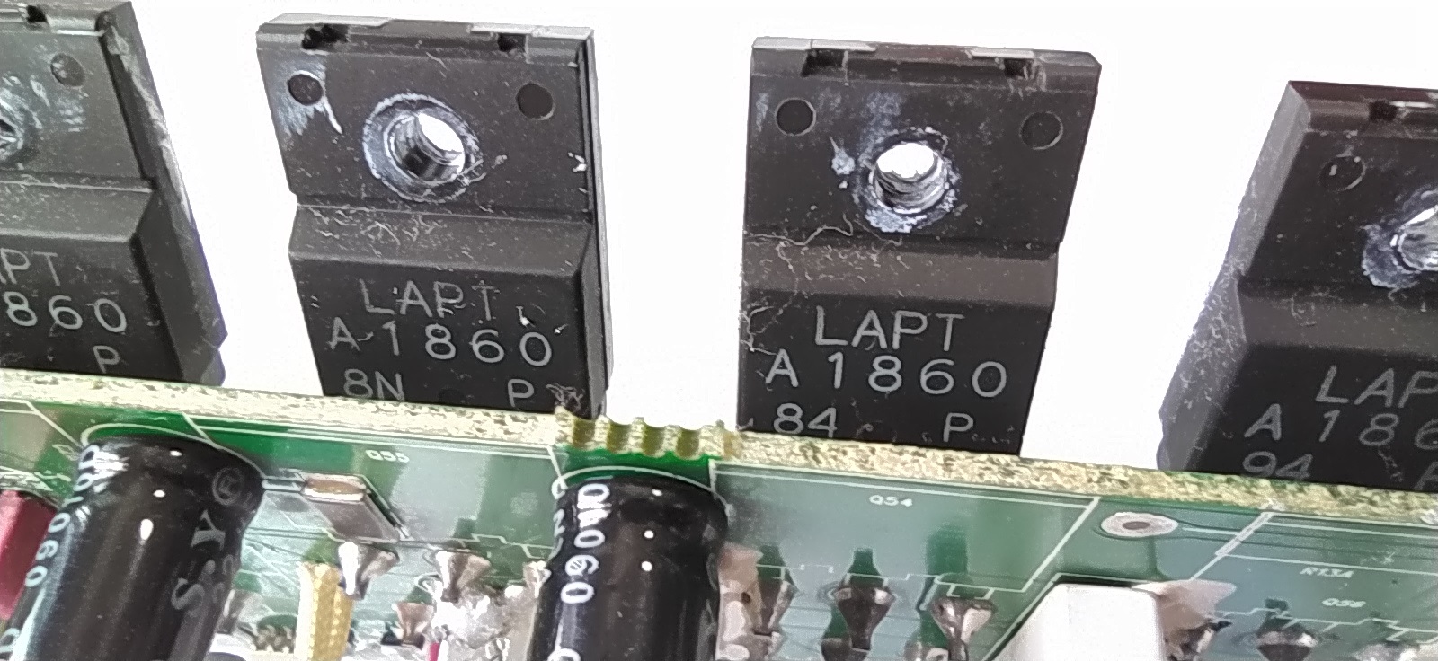

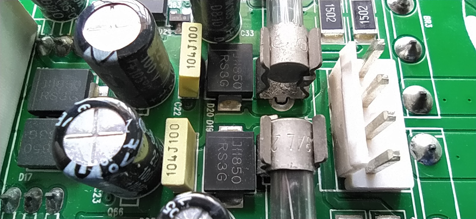

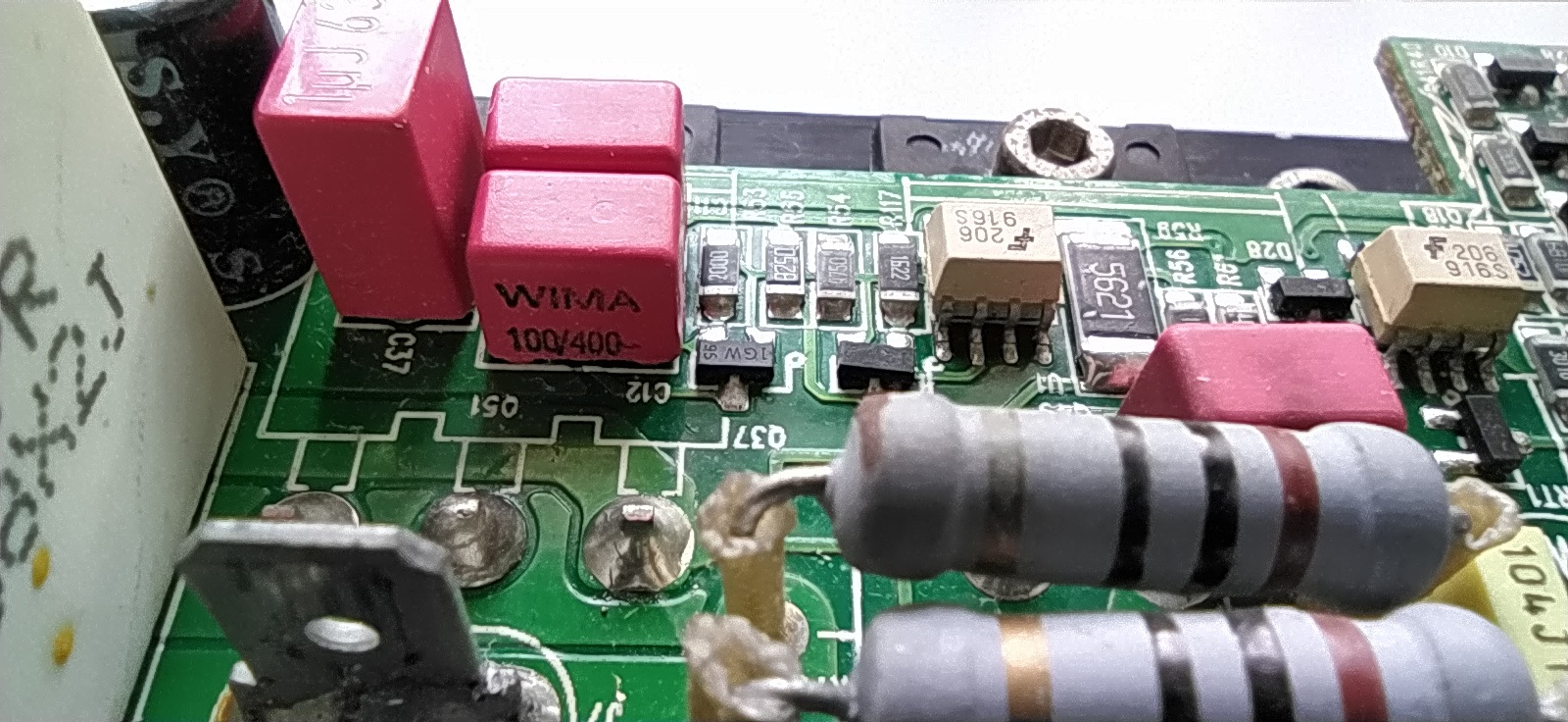

For the power, there are Sanken 4 x LATP 4886 and A1860. Each is rated for 80W....hmm...I am wondering if I could use something better. Capacitors are SY VENT....Rscon and REC....Those red blocks are wima caps. Yellow ones are unknown, there are only values.

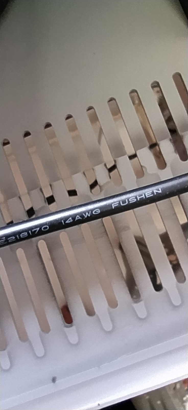

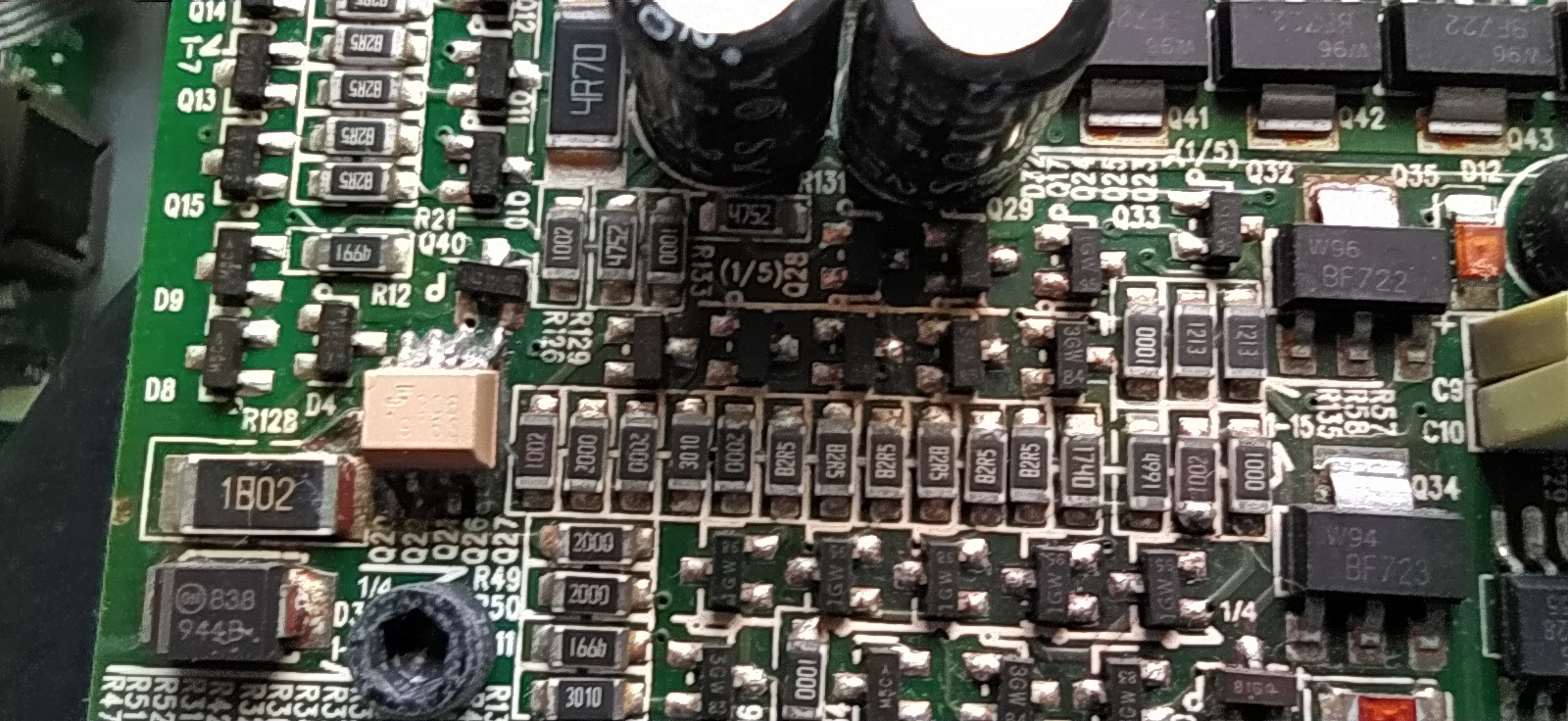

There is also a burnt area. I guess its due to bad repair job by previous owner. Since the amp is still working, I think I will leave it as it is. The cable from pre to power is well.....pretty much computer ribbon cable with a ferrite core (should be meant for noise) Speaker ones are 14AWG "fushen" ones....

Are you sure its just-- SST44 and not a couple of additional numbers?
Hi, Its SST44 SF, There is 0914 below but I think its year and week of production.

SST is USA company Microchip of Alabama but nowhere can I find =SST44 not in my large German equivalents book nor US company Digikey.

Btw, there is another SST44 SF and OP177G on the power amp board.
Why? Unhappy with the sound and want to improve it in some direction? What?
The caps are an obvious place to begin, only the amp was probably voiced with these particular caps and better ones may or may not make it better.
It is also worth investigating if there are any coupling caps. Untypical for Krell, but who knows?
From experience with Krell preamps the Cmos volume control is the main sound obstacle. Not much can be done about that.
I know the OP177G although its still in production Analog Devices a well known company advise a modern replacement of ADA4077-1-

Most paid, career amplifier designers know a bit about designing amplifiers so you're unlikely to be able to improve on their work by randomly replacing parts with boutique bits.
If the electrolytic caps are showing signs of strain, replacing them makes good sense for reliability.
ADA4077-1 Datasheet and Product Info | Analog Devices
Hi! What differences do you think it will make if I replace the OP177G with the ADA4077-1? It sounds like a fun experiment to try out different ones.

It sounds like you are not even sure what the OP177 does, right? Why don't you draw a partial circuit first?
It probably is a servo and the BP caps are integrators, which makes them at least as important for both reliability and audibility.

Hi, ok! let me try to trace the paths and see what I can come up with.
