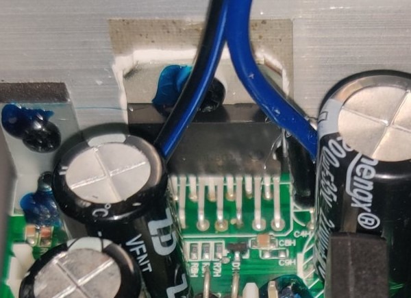

I have 2 KRK Rokit 5 3rd gen , got them from a friend, he said they both stopped working the same time .
Was Hoping it's the old black conductive gunk and a cleanup, cap replacement and some resistors would do the job but these don't have the black gunk they have clear glue on some parts of the board .
Power supply is testing fine , speakers and working, replaced 2 caps 2200uf 35v but still no audio at all .
Is there any bypass I can check to make sure the TDA chips are working ?
When I touch the leads with my finger while they are connected I do hear some feedback in the speaker.
Was wondering if anyone has any leads where I can start testing.
It has 2 tda7294 , was thinking worse case I'll just rewire the board and use RCA only for input as that is what I use anyway.
Any thoughts?

I was able to find online the points on the board I can bridge to get the apm out of standby mode and when I do so I hear a hum and when I put my finger on either of the TDA's I can hear some feedback.

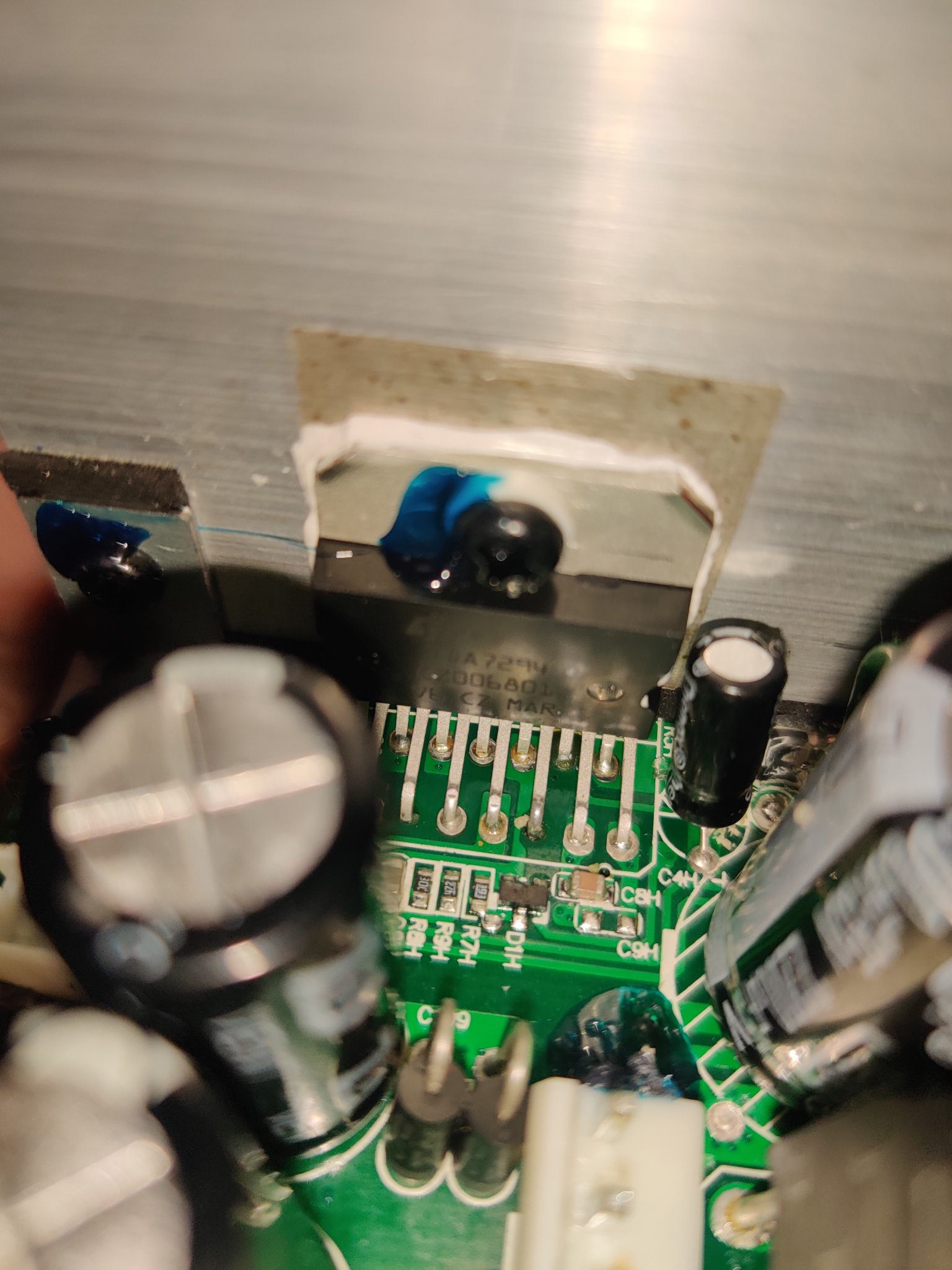

Sorry, I thought I have spotted a crack that would lead to an easy fix: IC replacement.
Anyway, you will need to troubleshoot the board, eye inspection is the first step and you already did it, so now is time to get the schematics and a multi-meter to verify the voltages.

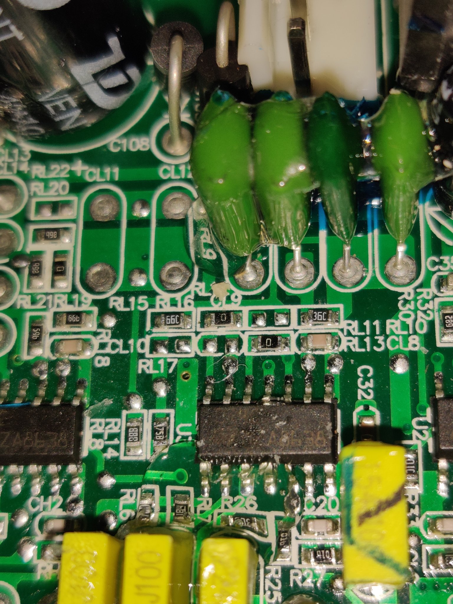

I checked the KRK schematics I have, but they belong to older speaker systems with LM3886 as power amplifiers.
It is hard to repair these devices without the schematics or service manuals, did you try to ask KRK for them?

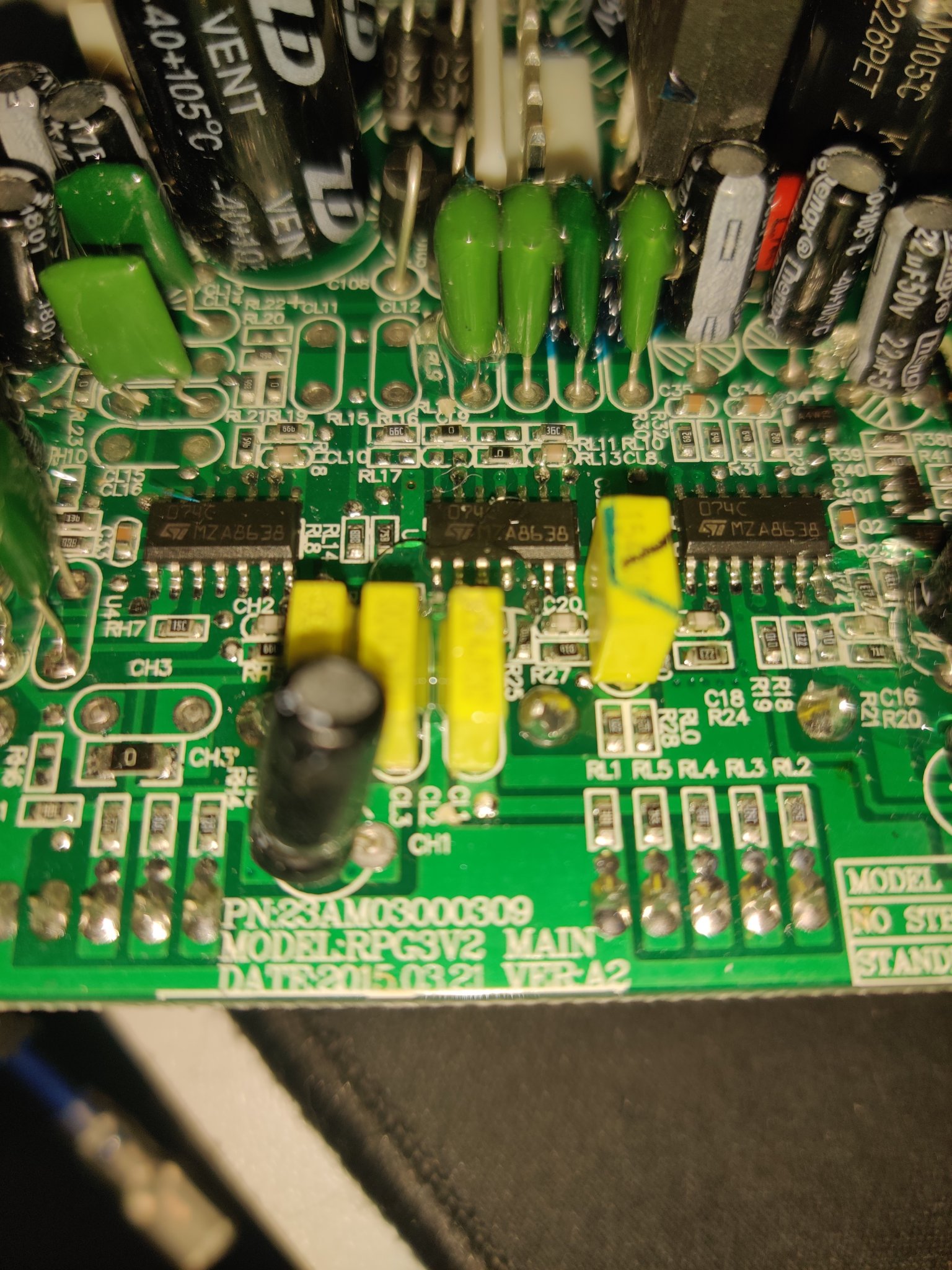

You did not mention if you have an oscilloscope and other equipment to troubleshoot it. If you do not have it, it will be like a "blind" try.
If that is the case, I will suggest you to measure first the voltage values at the main power supply rails and then at lower regulated rails for the operational amplifiers (the DIL 14 pins ICs are marked TL074 which are quadruple operational amplifiers).
If these two sets of voltage look reasonable (approximately +/- 25V to +/- 35V for the power IC's and +/- 12V to +/-15V for the op-amps), then I will take the risk of replacing the TDA7294's.

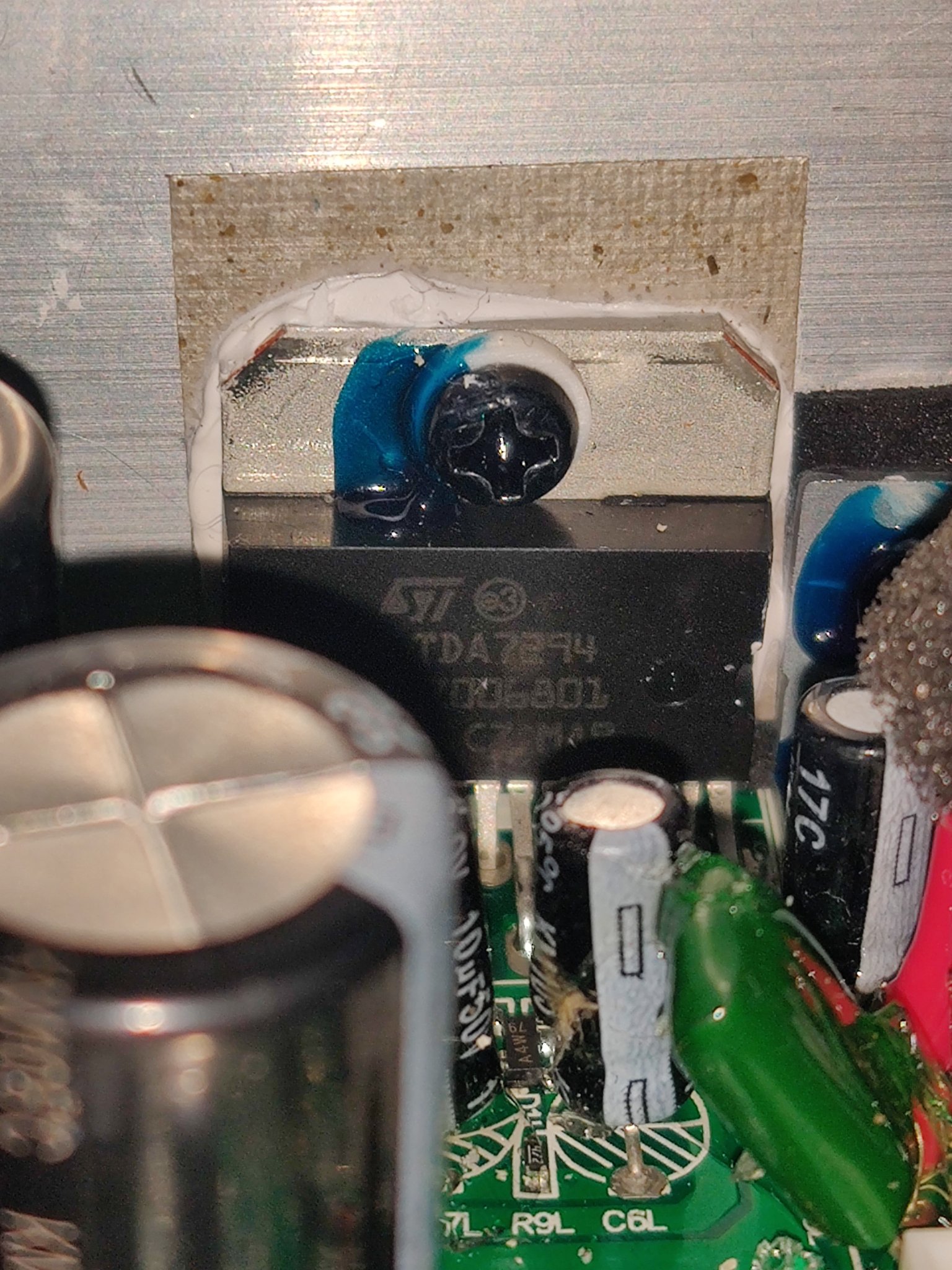

I tested the voltages for the PS , AC and DC they seems to be good.
I also have a working set or KRK 2nd Gen that are working and use the same PS and tired that . Same result.
I'll try to call KRK and see if they will help but they don't even sell the parts for it and the authorized parts seller doesn't have the parts in stock.
I'll try my luck and replace the TDAs 7294 .

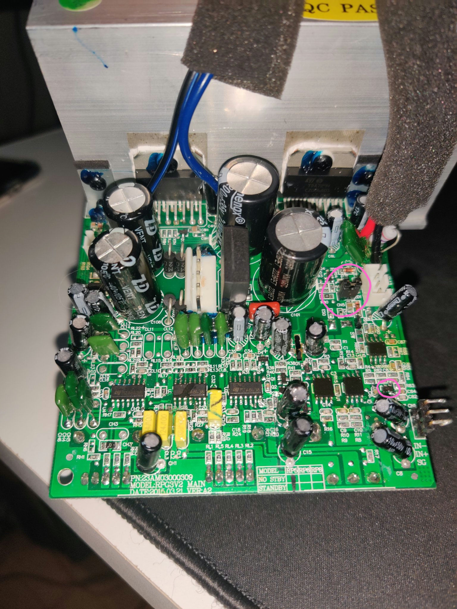

Did you fixed it? Or not yet? I think your motherboard model is the one without stanby because "CN5" already connected, see pink circle. And I suggest you check another pink circle part "Q5" see if it got 5v power. If not then replace it, the model is "HF" transistor.
