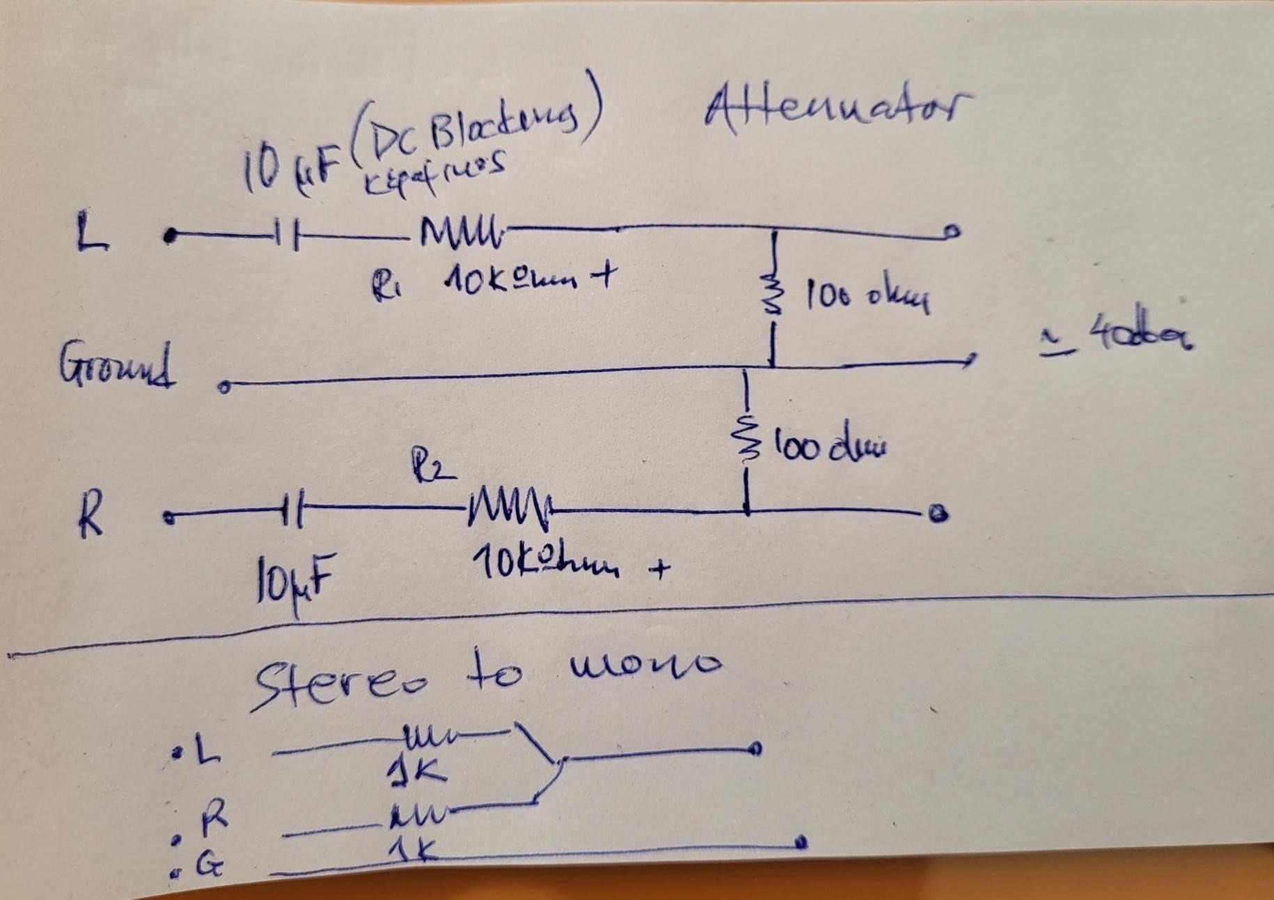

Hi there, I would like to build a variable (preferably) pad in order to get signal from a mixers rec out ( mixer master audio MM1210 only available output) to a wireless microphone input, whose receiver would be on a dslr camera nearby. In this scenario I have to also sum the 2 channels to one. I was thinking an l pad in order to achieve near -40db attenuation and 2 1k resistors on each channel to sum them up. Will this work? Any advice is very welcome.

Here what I have in mind. At the output I am thinking to connect the signal either to a Transmitter that has a lav input (mono signal Chinese made by the name fifine) or use the lav inputs on wireless go transmitters.

40 dB is 1%. So I would use two 10K resistors and one 50 ohm resistor. Unless the mixer is transformer balanced out, I would not add 620 ohm load resistors. The MM1210 does not require them.

Sorry did not quite understand it. We are talking about the attenuator Correct. So We are going to use one 10k on each output and a 50 ohm (why not 100 or more so as to not crosstalk?) between line and ground. Correct?40 dB is 1%. So I would use two 10K resistors and one 50 ohm resistor. Unless the mixer is transformer balanced out, I would not add 620 ohm load resistors. The MM1210 does not require them.

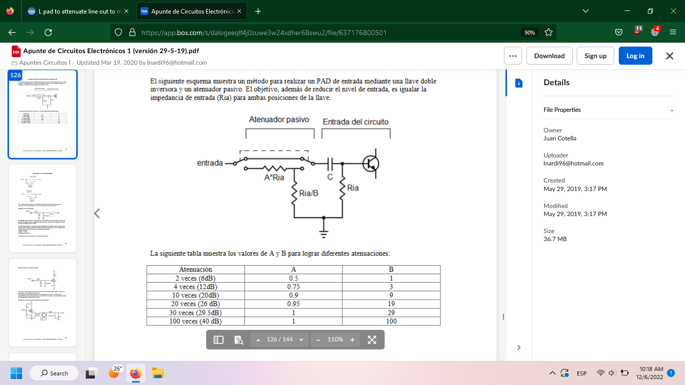

I'm starting to understand better, i will work, to make it variable you should use those hard to figure out mutipole switches for the R's that are not shorted in this image: (sorry cant edit the image so it will go full as i'm on the run)( Also there is no need to use a double switch for each at desired, it could be something more like the image hand written) (Ria is your Zin) .
In that table i think all the values are for keeping Zin the same, same applies to the long hand writed page. The short hand writed one, also changes your Zin (raises it), but it could not be a "problem", since if its turned on, you are probably with High Z line level source. Many pads are done that way because its a cheap way to attenuate and raise the input impedance in comparisson to the mic in (no pad used). The only issue with changing the Zin (if the transference of voltage is OK for the application) i can think of if messing up with the noise figure of the input stage transistors, in this case the mic input if i got that right, but i dont think its critical at all in this situation.
This last one changes the Z, and Rb is your Zin, if i recall correctly

I´d use two 2k2 mixing resistors, one from each channel (right, left), their output feeding series 100 ohm and 220 ohm resistors to ground, the 220 ohm one being shorted at will with a simple switch.
That will provide about 40dB attenuation with switch closed and about 30dB with switch open, will cover both "expected" levels, and a weak mixer output.

1,100 into 100 is -21.6 dB. Of course a simple switch is a good idea.
So I would still suggest 10,000 into 50, but with another 110 that could be shorted.
Of course this results in a lower impedance than the microphone, so should lower the noise floor.
