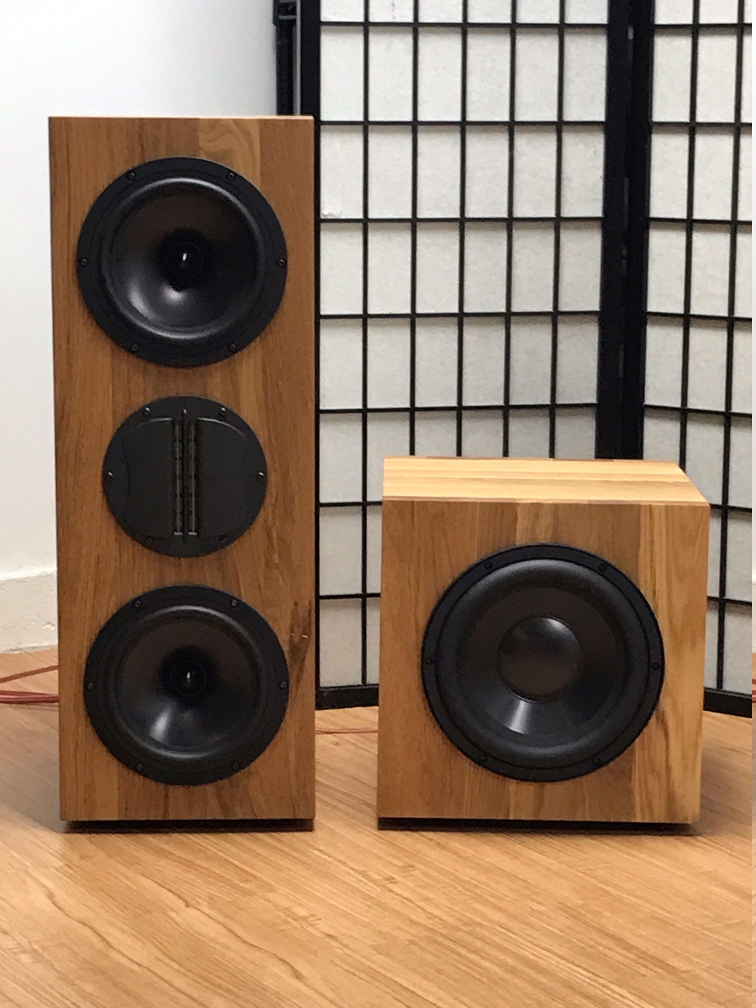

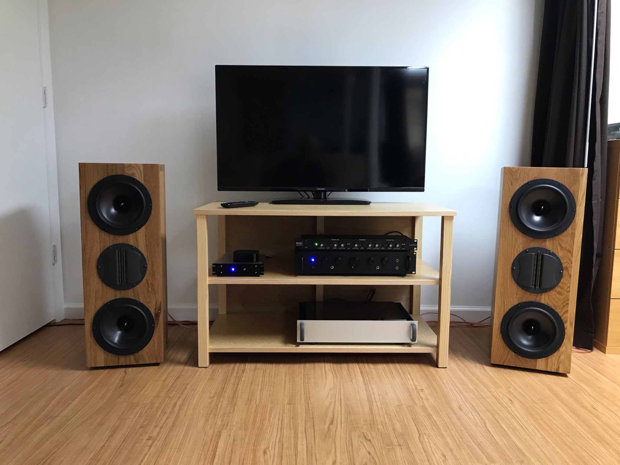

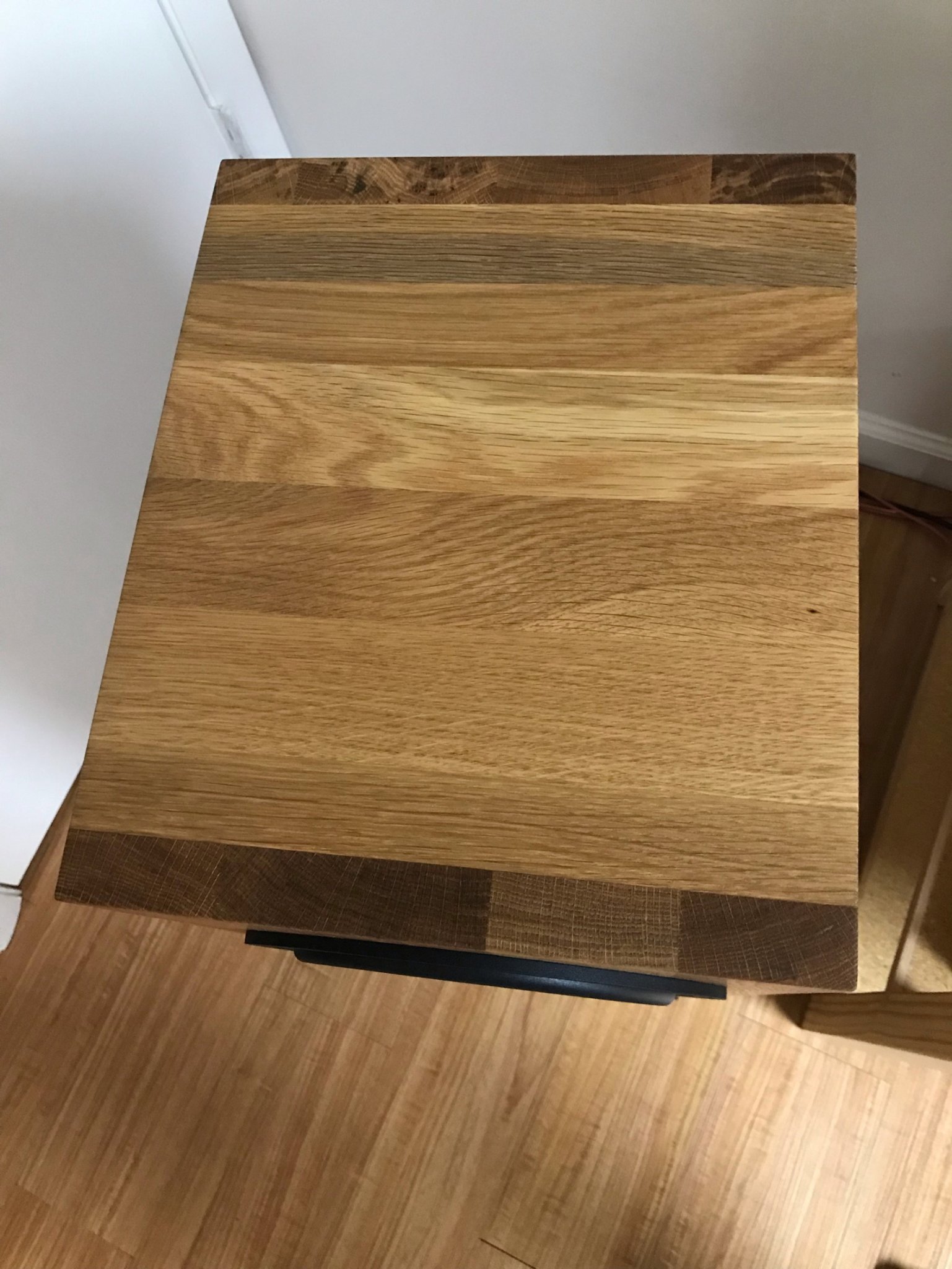

Last year I built two projects from 1" thick laminated oak boards. The boards are sold as "stair treads" by the big box stores here in the US.
A pair of 8" MTM and 10" subs. The only slight issue I had was some minor cracking which developed in the dry winter months. I used a danish oil finish which probably wasn't heavy enough to prevent the wood from further drying. I think a varnish finish would avoid this.
Otherwise, the laminated oak is very rigid, quite heavy, and it does sound good. It's also nice to not worry about ruining the thin veneer that's found on plywood.
More info in post#3443 on page 173 in the System Pictures and Descriptions sticky thread and #204, page 11 in the Sub gallery.

In case anybody's interested, this is the stuff I used...
https://www.homedepot.com/p/Stairte...shed-Red-Oak-Tread-BTRO1142/202019901#overlay
I had to glue some together to get the width needed for the subs.

As far as I'm aware, no finish exists that will completely eliminate seasonal wood movement. Finishes will only slow down moisture exchange.
It's important to note that wood movement is not the same in every direction. Wood is actually very stable longitudinally (along the grain), but not so stable in the radial and tangential directions.
These panels appear to be edge-glued, meaning full-thickness boards are glued edge-to-edge and end-to-end to make a panel of the desired dimensions. Since the grain is all going the same direction, the dimensional stability should be similar to a solid board.
Plywood is cross-banded, meaning that the grain direction alternates with each ply. The longitudinally-oriented plies in a given direction will largely constrain the movement of the tangentially-oriented plies, so you end up with a board that is relatively stable in two directions (length and width along the face) rather than just one for solid wood. In addition, any movement that does occur will be similar in both directions. This is why you don't really have to worry about wood movement with plywood cabinets. The thickness is not so stable, but that doesn't usually matter.
It may also be worth mentioning that the stiffness of solid wood is considerably different in the longitudinal and tangential or radial directions. Plywood is similar in both directions along its face.
So, unless I've missed something, constructing a cabinet with these edge-glued panels would require the same considerations as with solid wood. You could very easily use it for the sides, top, and bottom, but using it for the baffle and rear face may (read: probably will, especially for larger cabinets) require some thought toward dealing with the cross-grain movement that will occur.

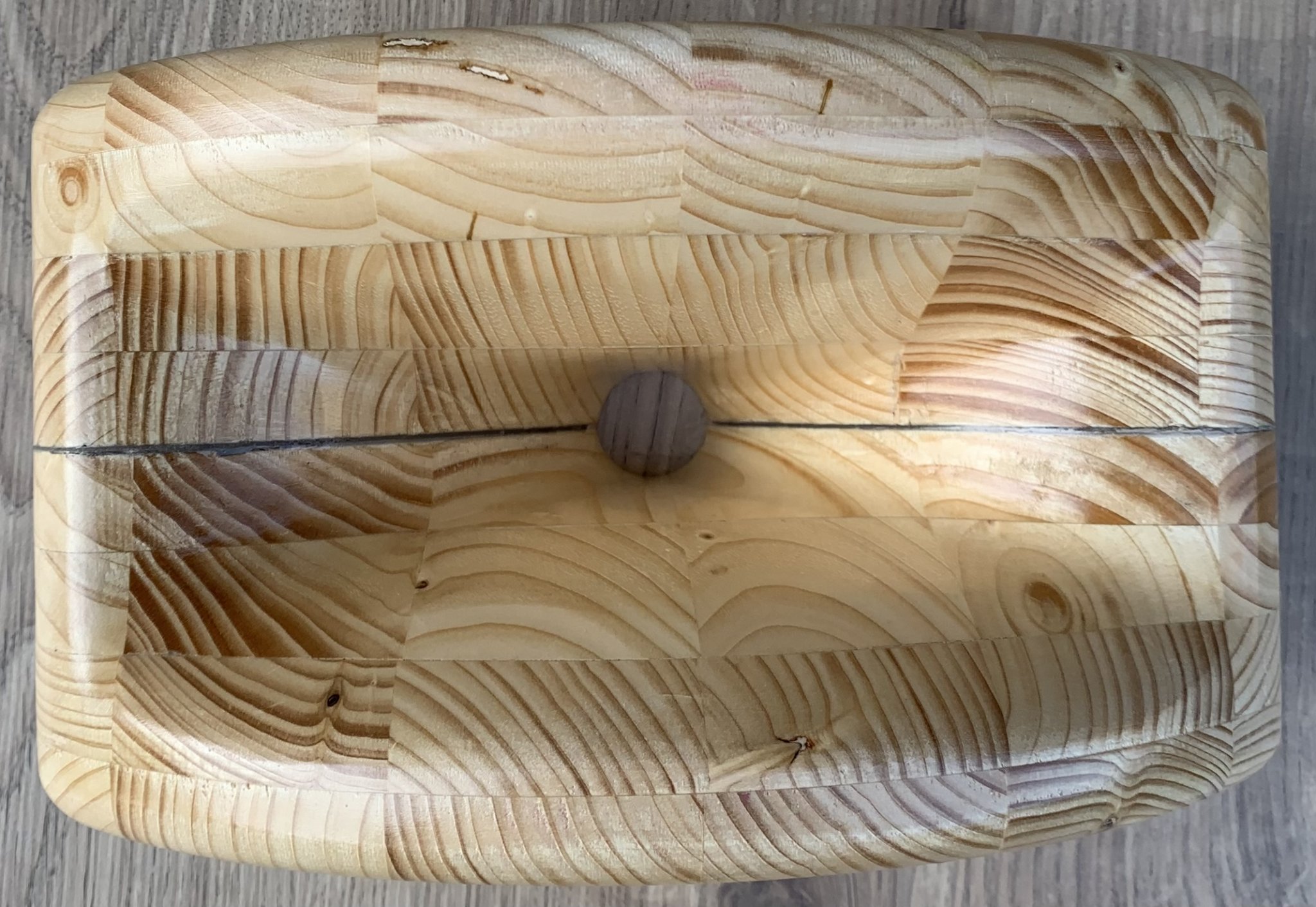

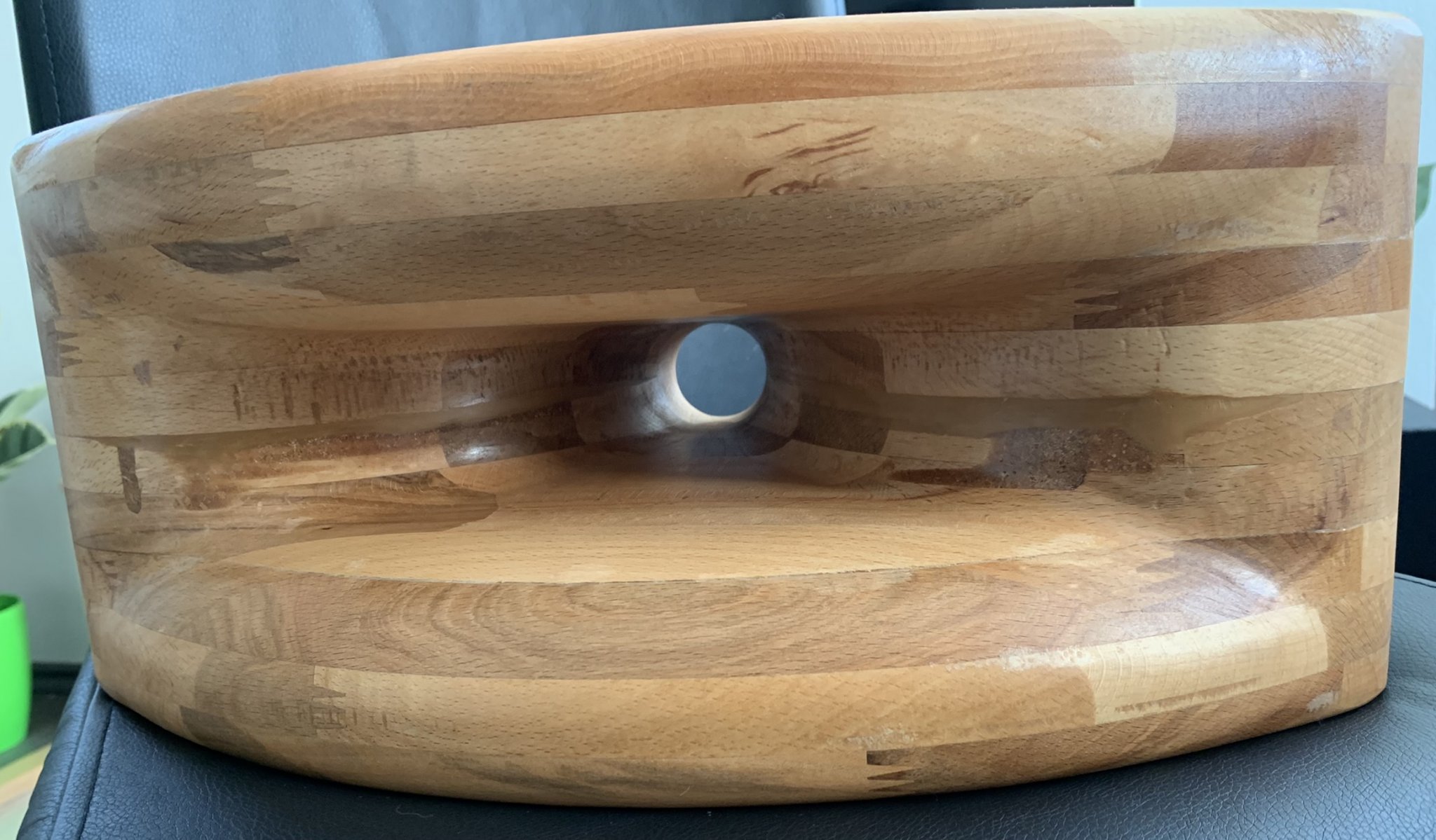

I use these boards for layered CNC horn construction. It looks pretty good. I tried to use some for box construction and the boards I used definitely have some tendency to bend, some of them not being really flat from the beginning.
