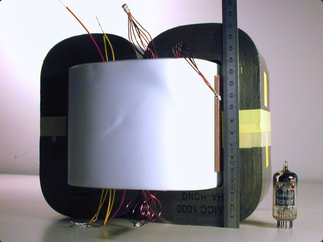

I've developed a fondness for Metglass amorphous cores and virgin Teflon insulation since building my 833C amps. Incredibly detailed without being harsh, at least in the case of the Monolith OPTs I used. Picture is of one if my OPTs under construction with an ECC83 for perspective.
Belief often determines sound quality for some listeners, regardless of what comes out of the speaker. Double-blind testing is the only way to separate the wheat from the chaff in that situation.I'm not convinced that the bobbin and insulation material have any effect on the 'sound' - a few years back I built a Fender Deluxe Reverb copy for my son, all of the Tx's were wound by me using reclaimed laminations from old power transformers, I wound 2 OT's one with cardboard winding tube and paper insulation and a second with plastic bobbin and polyester insulation, my son auditioned both OT's, he decided if there was a difference he couldn't hear it, he finally settled on the paper insulation simply because that was the last one installed.
