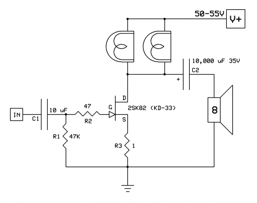

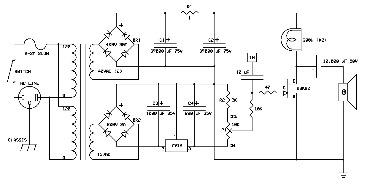

1. Use a properly sized or oversized heat sink, period. Don’t skimp here.
2. I used 50 Watt Dale power resistors attached to small heat sinks for both of the 1 Ohm resistors. 20 Watts or larger is recommended. I like to comfortably oversize these parts. They’re cheap on Ebay.
3. I liked the sound with no source degeneration best, but I knew some beginners might want a mostly plug-and-play option. If you build Figure 11, you want the KD-33 grade parts sold by Acronman, or the circuit probably won’t work correctly. If you have the skill and confidence, I would recommend the version with the separate voltage reference for the bias and no source resistor (Fig. 10).
4. I haven’t tested any other grades and I have no data on them. If you have definitive information on the grading please share it here.
5. Until I started experimenting with these devices gate leakage wasn’t something I’d had to worry much about. I bought four of these VFETs and they all measured around 1 uA, which is pretty manageable, but I don’t know if this is representative of all 2SK82’s. You may need to lower the value of R1. Try 10k and see how that goes.
6. The operating points as published are for 8 Ohm speakers.

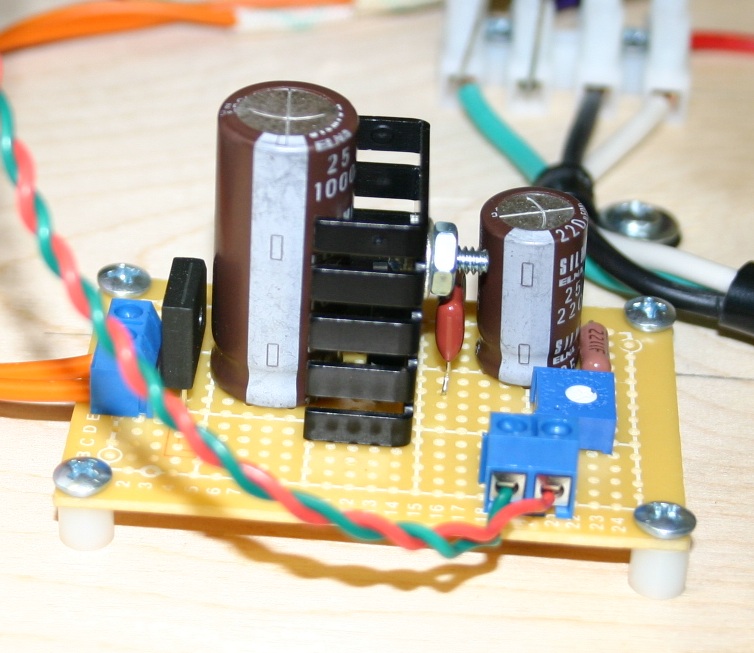

7. I’ve attached the diagram for the negative bias supply I used. You could probably do something simpler, or perhaps more complicated. It’s up to you. It doesn’t require much current, but it needs to be clean. A certain wizard I know posted a diagram for a negative bias generator which derives from a single B+. Here’s the link: http://www.diyaudio.com/forums/pass-labs/195430-ro85-zen.html#post2688167

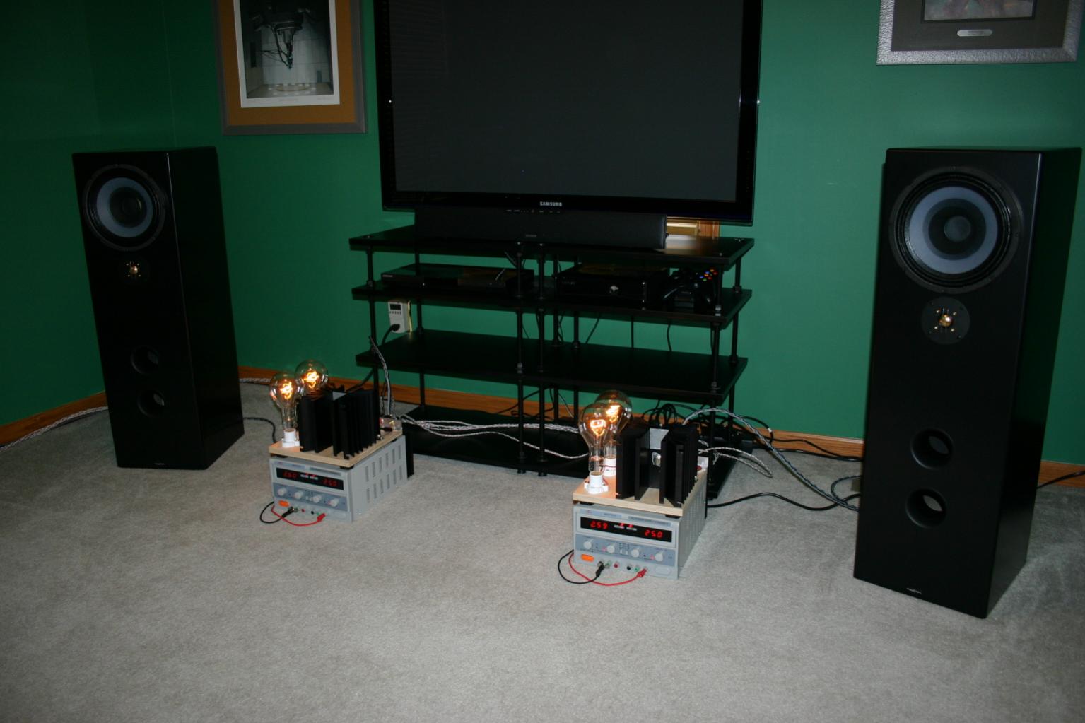

The thing to know about these devices is that they cry out to be used in really simple circuits. I'll be sticking to the simple stuff.

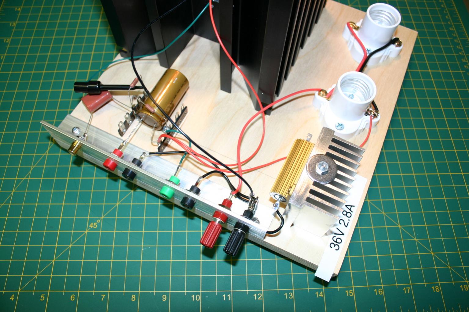

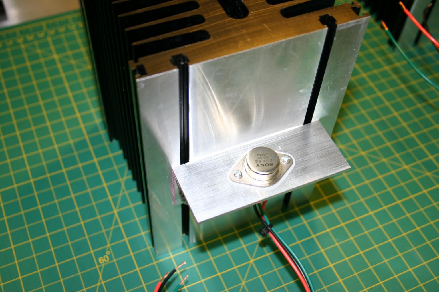

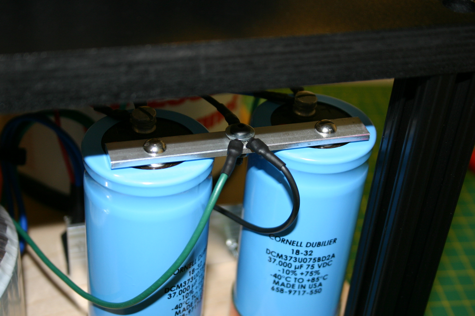

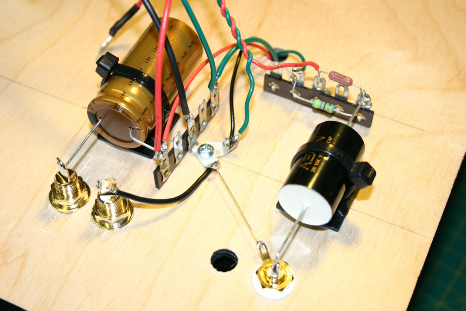

On the subject of heat sinks, I used some big old Thermalloys drilled for TO-3, but I know they're hard to come by, so I tried this arrangement for you, dear reader. This is a small bracket made from aluminum angle purchased at Home Depot bolted to my favorite T-Slot heat sink from Newark. It works just fine:

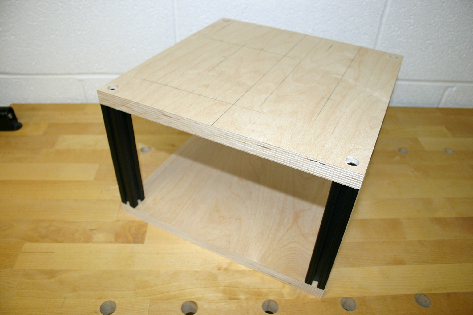

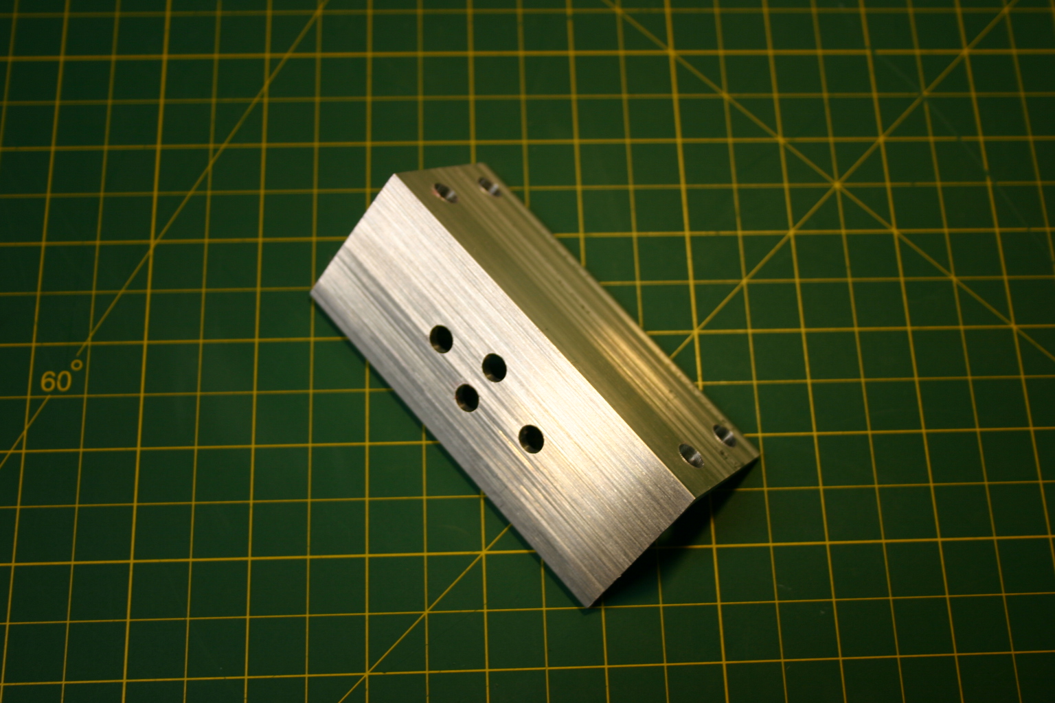

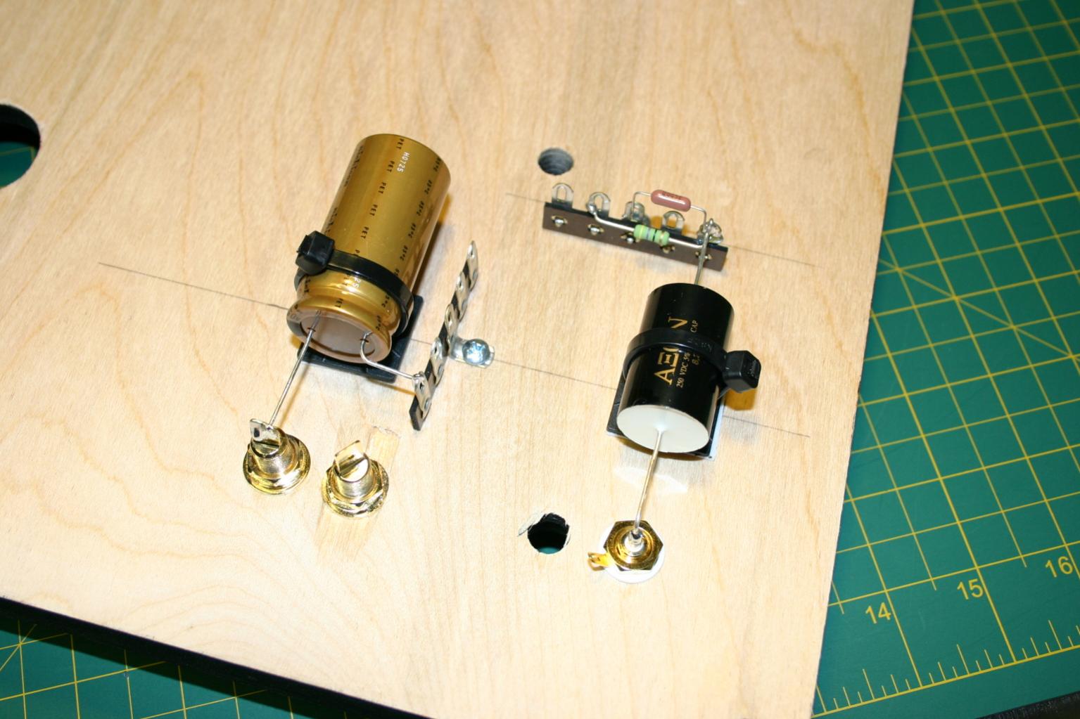

And here are some of the bonus materials.

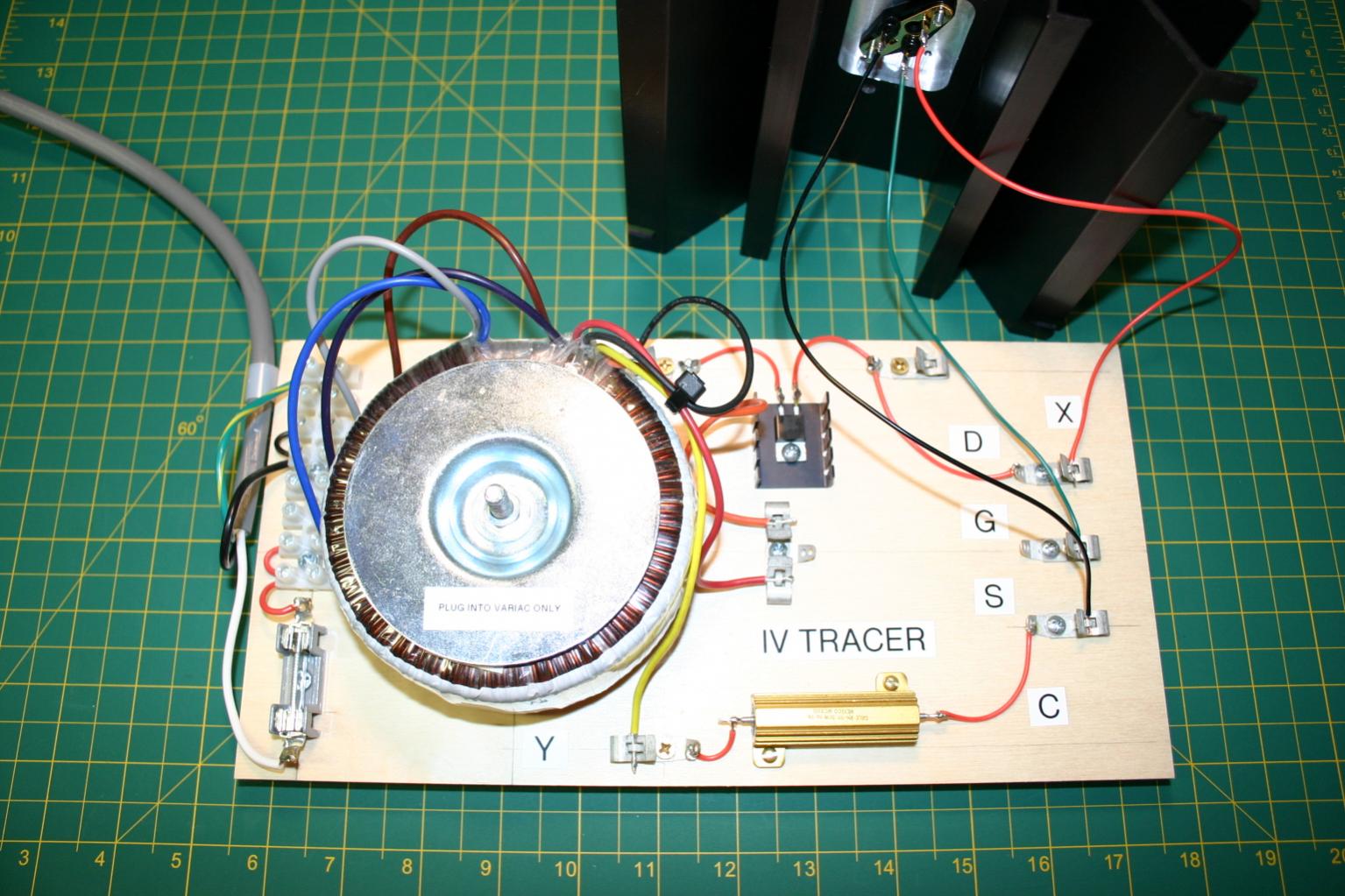

Here's a pic of the makeshift curve tracer I used:
FAHNSTOCK CLIPS! Love it!
Great Stuff.. Michael.. Just ordered some SK82 to try out.. My spks are 16 Ohm.. do I need to change any values ? Thanks
It's a great question. You can certainly try it as-is and it will work, but if you build Figure 10 with an adjustable supply, you'll be able to fine tune things more readily.
For those without distortion analyzers, I'll soon post a table of operating point values for different loads assuming a 50-55V supply. Give me a week or so. We'll also play with the number of bulbs for good measure.
