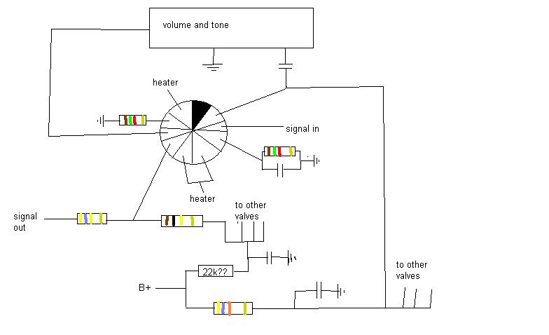

ok, done a quick schematic in paint, hope it makes sense, its for ONE preamp valve, there are 6 in total. the valve is an ECC83 and this piccie is from the solder side of the socket not the valve side. i have marked the resistors with their colour codes and the resistor that i think should be a 22k i marked 22k??
sorry for the rubbish quality.

hope the schematic is right, anyone got any ideas if 22K is right for that resistor? does it look right? :S

You probably have some shorted cap to ground, that's the cause of high current drawing from the B+.
Carefully check ALL the caps and ALL the resistors for shorted ones, drifted resistors, bad solder joints etc etc.
Also check your preamp tubes (but I haven't seen a shorted preamp tube yet).

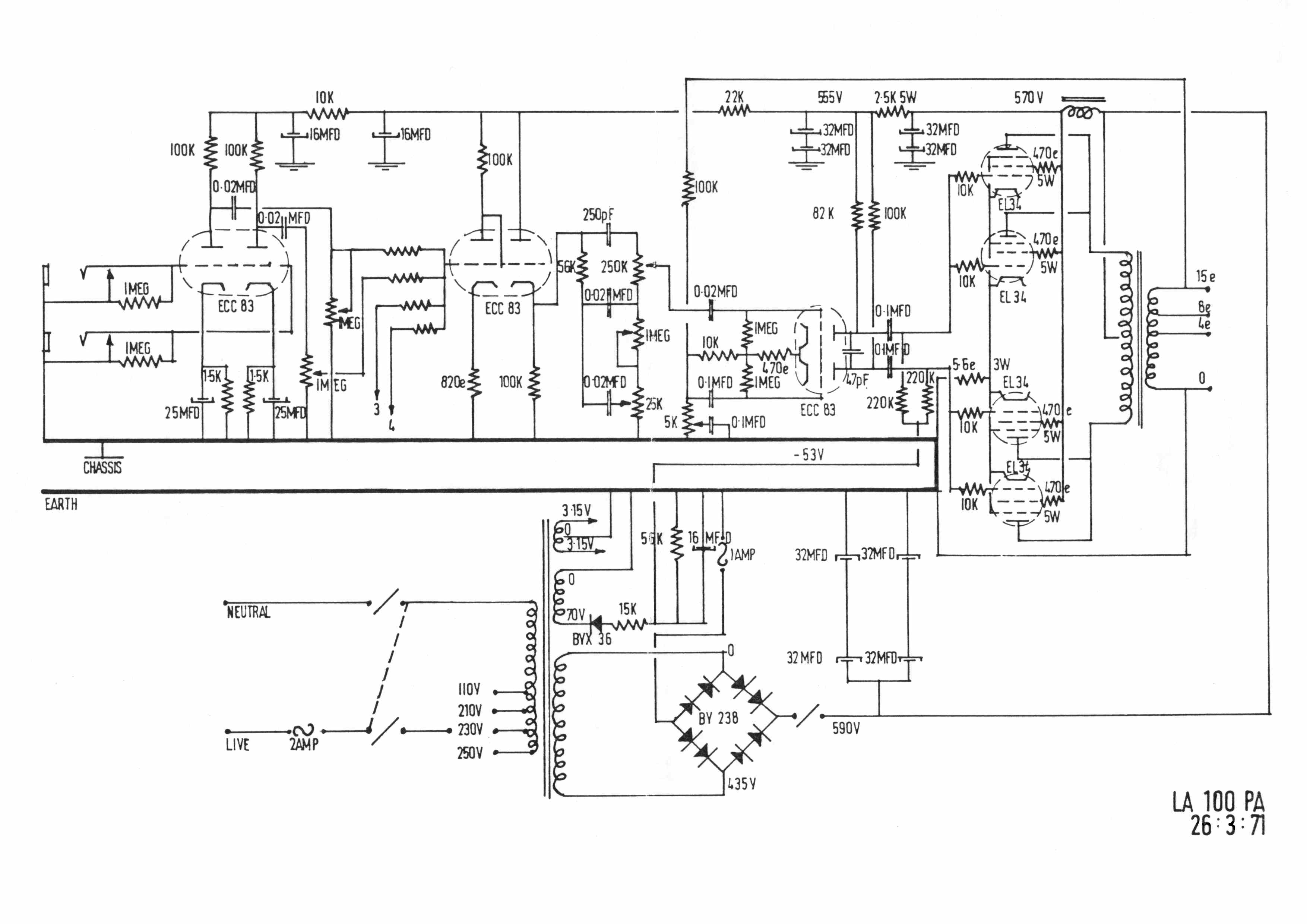

I haven't got a PDF of that one, but I do have a JPG, and I've attached it. It sounds like one of the decoupling capacitors is S/C (or at least VERY leaky), you should be able to find it with your meter on the ohms range. In the JPG the suspect ones are shown as the two 16uF either side of the 10K.
Oops - JPG too large, try it at My Website
that schematic looks slightly diffrent to my amp but i know the two capacitors you mean, they are on the power supply section of the circuit but on mine the 10K is a 47K and it is connected to the other side of the 22K resistor (which is the one that keeps burning out and the caspacitors in question go from the 22k to ground and the 47k to ground. I will check it when i get home anyway and check and see if the capacitors are shorted. if they appear shorted on my meter would it be acceptable to dissconect them to remeasure the current draw or would it damage other components if i did this?

Yes, you can disconnect them to measure the current, valves are EXTREMELY robust devices (at least electrically!), so it won't do any harm - most likely effect is excessive mains hum, with a possibility of instability?.
ok, i tested the two capacitors (15 uF 400V in my amp) and tested them with my meter and sure enough the one conected to the resistor that kept burning out was short circuited... COMPLETELY!..
