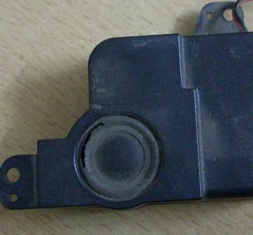

I got my laptop internal speakers damaged. And here in India I could not find any replacement. The speakers are electrically ok. I am attaching pic of the speakers. Pl suggest me simple tip that would make speakers audio-able again. I don't expect it to get back same quality or its TS but should be enough good for voice chat.
The tip like using some kind of glue to patch torn part. or some adhesive tape or something.

It looks like the speakers have a foam surround. Not easily repaired.

Its from a Laptop A215-S7413 from toshiba. Its said the speakers are Harman Kardon make.
yes its only surround is damaged and I am looking to repair or just get this to work.
Maybe you can patch the surround using some thin flexible cloth, smeared with silicone glue (aka RTV, silastic, silicone sealant).

If you patch surround the rest of it will just fail sooner or later.
I don't know if you can buy foam surrounds that small, you could attempt to make a doped cloth replacement surround, but it would be tricky.

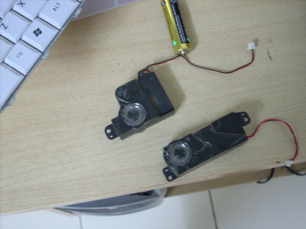

Solution: I took a bigger adhesive tape cut it much bigger than the diameter of the speaker diaphragm. pressed it against the AA size battery's end. this gave it a bit of conical shape.
then I carefully glued the tape to the cone. and the rest part to the frame of speaker.
This solution worked well for me. I mean, I got what I was looking for. this sounds really ok. vocals can be well followed. the problem is with bass. but then Its ok for me. Now at-least I can use the internal speakers for video calls.
I am attaching the Pic of the speakers with this.
