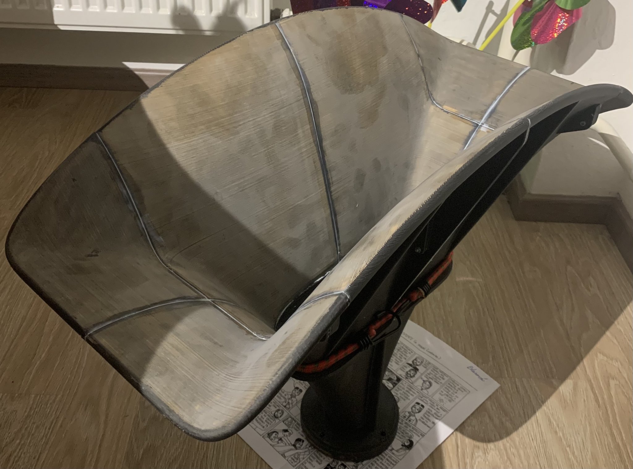

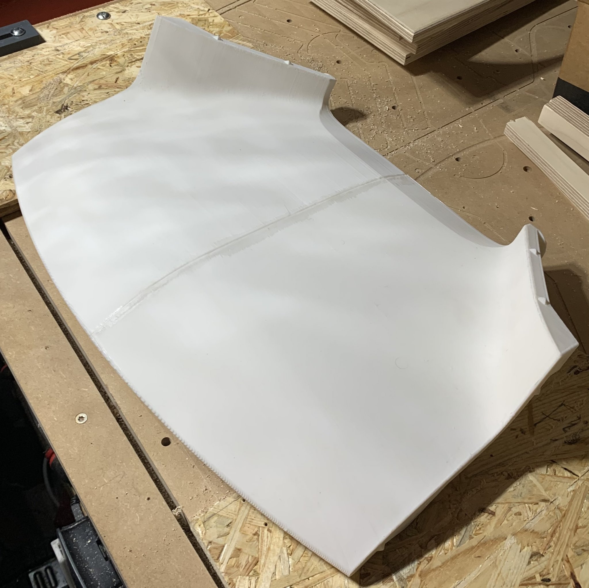

Thanks to a very fruitful cooperation with Dr. Bernd Ahlswede from www.sphericalhorns.net, I can introduce my second large 3D printed horn (the first being the multicell horn for JBL2445). It consists of 9 parts and almost 3 kg of PLA. The 62 cm wide horn was cut to fit my Flsun Super Racer printer, it took more than 60 hours of printing time.
It is glued with Mamut construction glue with a few M3 bolts and nuts for alignment. The inside is only roughly sanded, coated with photo resin and two layers of grey spray paint.
The pictures show the construction and building process. It is still work in progress, the prototype was put together as a feasibility test. It seems to resonate quite strongly, so I will try various ways of damping the horn walls and also second unit with added ribs was printed and is waiting for assembly.
It is intended for BC DCX464 coaxial driver.

As far as I can tell, this is not really necessary. I built also a smaller one out of MDF for 1" driver, as mentioned in the recent article. That one has a bit more roundover, in my opinion that is all that is needed, but Bernd would definitely explain better.

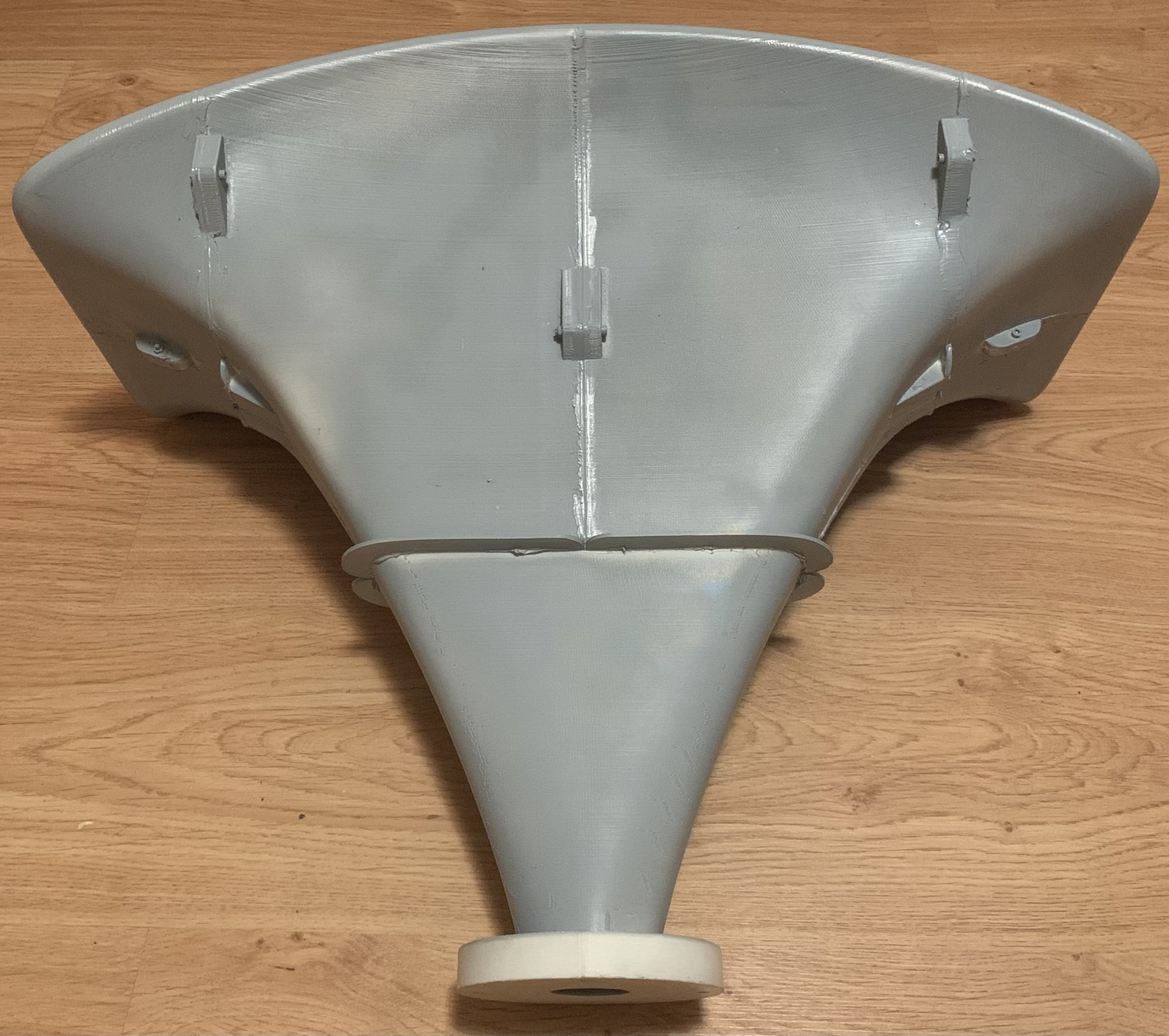

Here is one more photo of the horn with a stand just printed.

Today I had the pleasure to meet Bernd in person. The suspected resonance was in fact a reflection interference, we did a few measurements together and the results are really exceptional performance. The improvements in stiffness of V2 will definitely not hurt, but were not really necessary. I will do some more measurements on V2 when it is finished. This horn is an ideal match to the DCX464. I am excited to make some listening tests in near future.

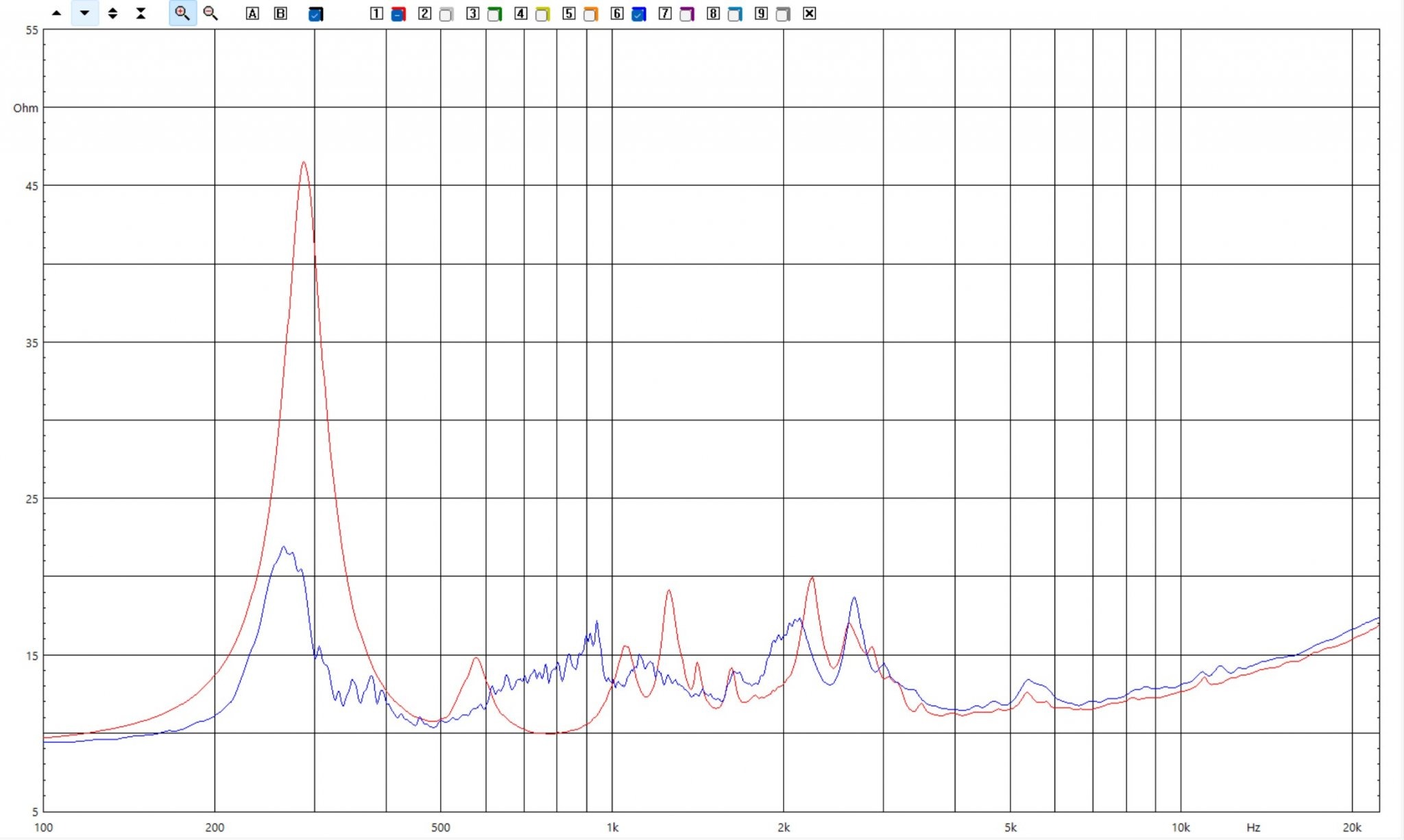

So here is impedance measurement (thanks to Bernd and his Clio Pocket) - free air (red) and on the horn (blue) - only the MF part, HF part shorted. FR measurements I have are not good at the low end, since they were taken in a small room and when gated properly, the low end resolution is really bad.
Do you have any decay waterfall measurements to see if any of the impedance spikes result in resonance/horn reflection?So here is impedance measurement (thanks to Bernd and his Clio Pocket) - free air (red) and on the horn (blue) - only the MF part, HF part shorted. FR measurements I have are not good at the low end, since they were taken in a small room and when gated properly, the low end resolution is really bad.

@HEXAAA I need to finish the second prototype and bring it outside. Which peaks do you mean - at which frequency range? I can only do measurements in REW with UMIK-1. If you could give advice how to set up the waterfall view to show what you need, I will do so.
