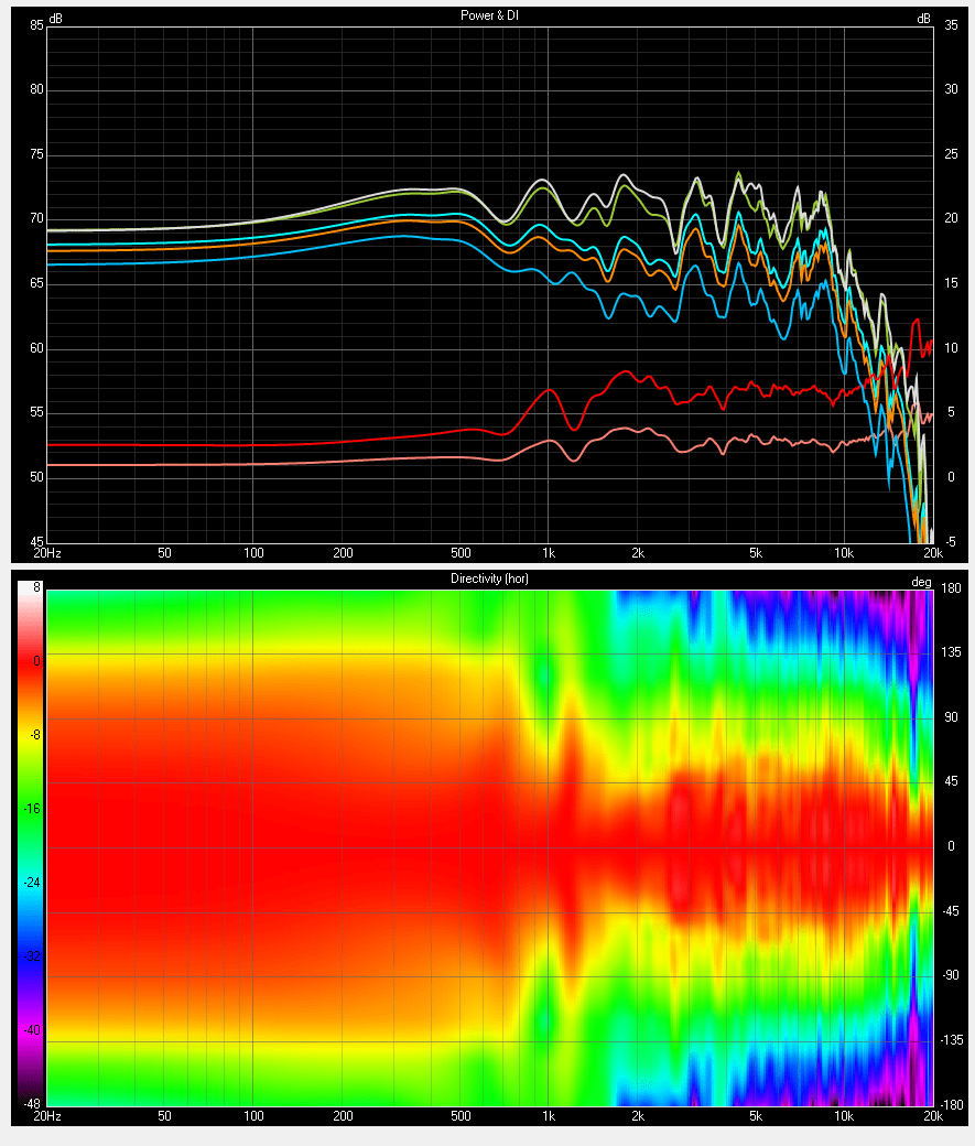

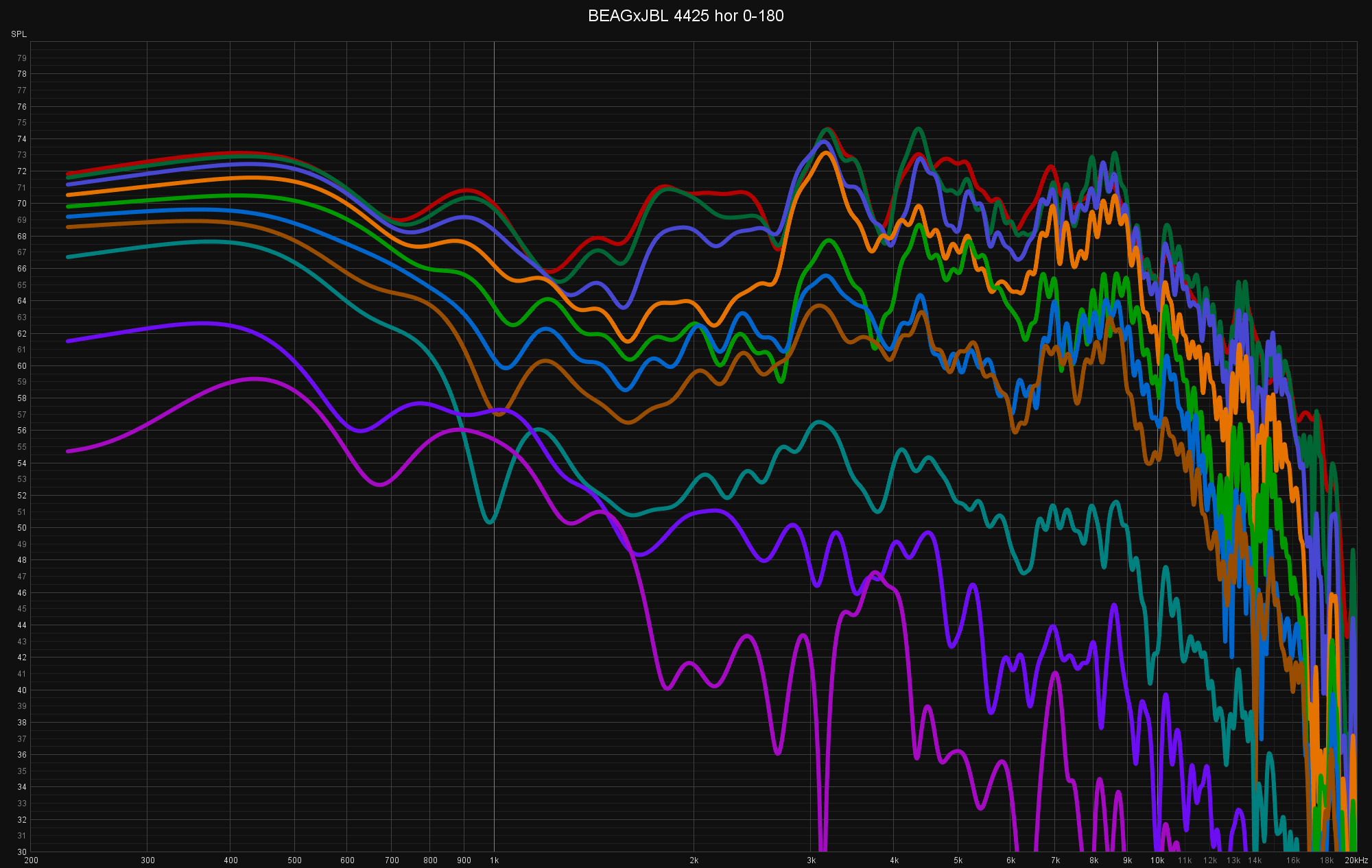

Don't bother with Mezzo Calpamos and similar designs featuring buttcheek horns.
Such horns are badly terminated, suffer from huge diffraction and throat/mouth reflection problems and overall obsolete. They have nothing going for them besides wide dispersion. Attached plots:
1)horizontal axial and off-axis FRs of JBL 4425, measured at 70 cm in 15 deg increments, 5 ms gate
2)same data, but as (incomplete - missing vertiacal orbit) spinorama and normalized sonogram
Strictly speaking, it's not JBL4425 per se, but JBL 4425 as part of a larger cardioid prototype system, but everything from ~1700 Hz is JBL's butthorn, working as designer intended.
As for the larger question - I would probably make DIYSG HTM-12v2 ( https://www.audiosciencereview.com/forum/index.php?threads/diysg-htm-12v2-review.24215/ ) or a custom design with 3D printed ATHorn. Like a recent design from vineethkumar01, for example: https://www.diyaudio.com/community/threads/a-3-way-design-study.376620/post-7157498
But keep in mind relatively narrow dispersion of ST260 horn he used (DI rising from 11 dB at 1 kHz to 14 dB at 16 kHz) ; you may prefer something wider, like 7-10 dB SEOS-12.

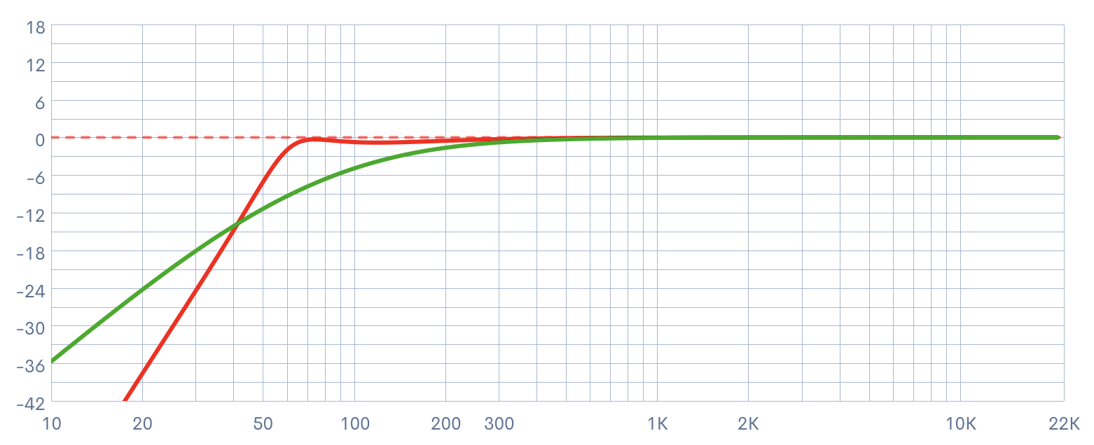

Update from my end - I have returned back to the country and made a mockup of the Calpamos size and it may cause some issues with the depth & perceived cabinet volume. Had a quick check and with Vb = 40L:
Sealed cabinet
Qtc = 0,45 (how low is too low?)
F3 = 135.9Hz
-6.7dB @ 80Hz. With room gain I expect EQ / power requirements to decrease at this point,
Vented cabinet
Fb = 60Hz
F3 = 57Hz
Seems it could be in line with the "party plug" concept. Lower than expected Vbs can give plenty of flexibility with cabinet tapers at least.
Green is sealed cabinet, red vented..
Sealed cabinet
F3 = 135.9Hz
Vented cabinet
Fb = 60Hz
F3 = 57Hz

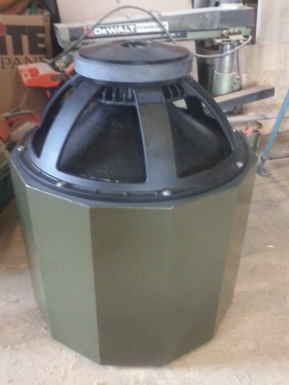

To my ear, the sound quality and transient response of sealed subs far outweighs their poor efficiency when compared with ported enclosures. Horses for courses, but in these these times of cheap high-powered amps and affordable kilowatt-rated drivers it's no issue really.

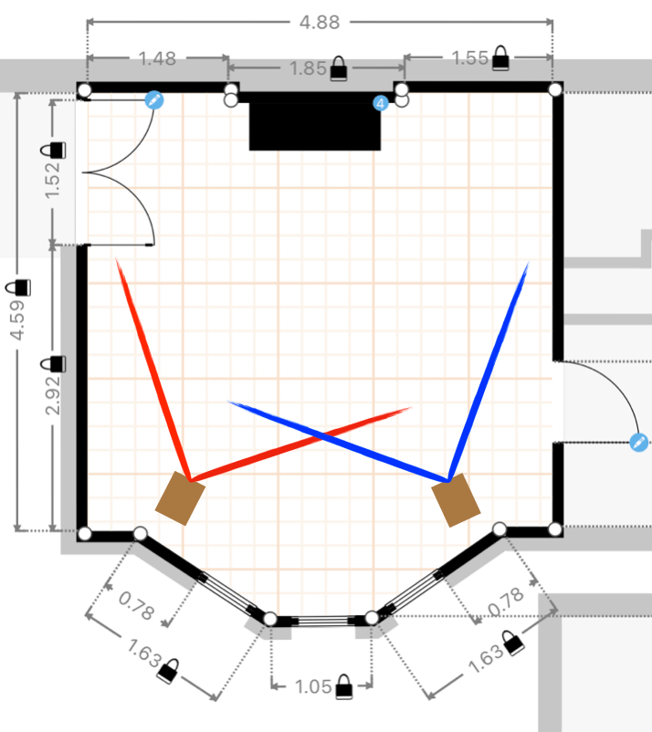

Is that your couch against the back wall? If so pull it off the wall a few feet, tough to get good sound with the wall right behind you.

mordikai that is a fireplace plinth! We are still unsure of the layout (new house), but will likely have the listening position spaced out as you pointed out. I need to build the absorbers back in as well for 2nd reflections and general damping. We do have 24m2 of heavy felt (approx 12kg) in the curtains which will be fantastic for some mf /hf absorption
Just have to be more aware of cooling in sealed boxes.. Thick wood covered in insulation is pretty awful for heat transfer.
- Sealed boxes also avoid the whole port resonance issue, especially for giant long ports.
- Is the heat transfer really much of a problem in residential settings? Movies don't have continuous lows endlessly, and even if I'm cranking up UFO's Strangers In The Night etc, I can't manage to do that for too long before wife or kid comes home "DAD I can hear you out in the front yard!!!"
- Maybe the sealed box could have a tight-sealing ventilation flap, which would motorize open between particularly vigorous selections, all controlled from an app or home automation system. Perhaps it would automatically open at a preset temperature, rather how some supercars raise a wing at a given speed. Heck the flap could uncover a low-tuned port and the automation would send a signal to reconfigure the DSP equalization. And cure cancer and all disease and usher in world peace liberal and conservative, democratic and autocratic, religious and not, cable believers and cable deniers...OK not the last, not possible in this universe...
I agree, sealed for domestic is likely a non-issue. I have had experience with sealed mids in PA cooking themselves, hence my slight reservations. At least if there's an optional port then I can release some extra efficiency 60-120Hz if needed, with extra cooling to boot.
